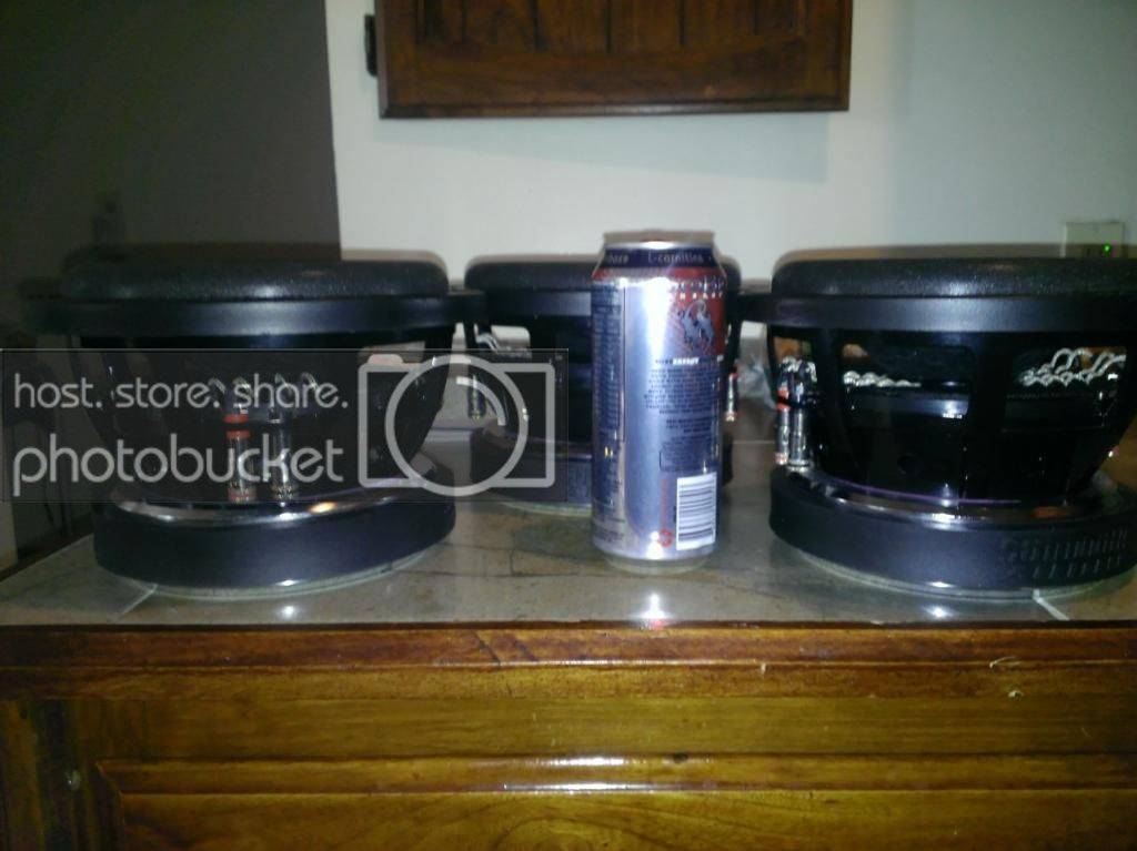

So I picked up my new ride in October and it came with the sony premium audio which was weak as hell so I decided to upgrade. I figured I'd start with the substage as the factory speakers aren't that awful.

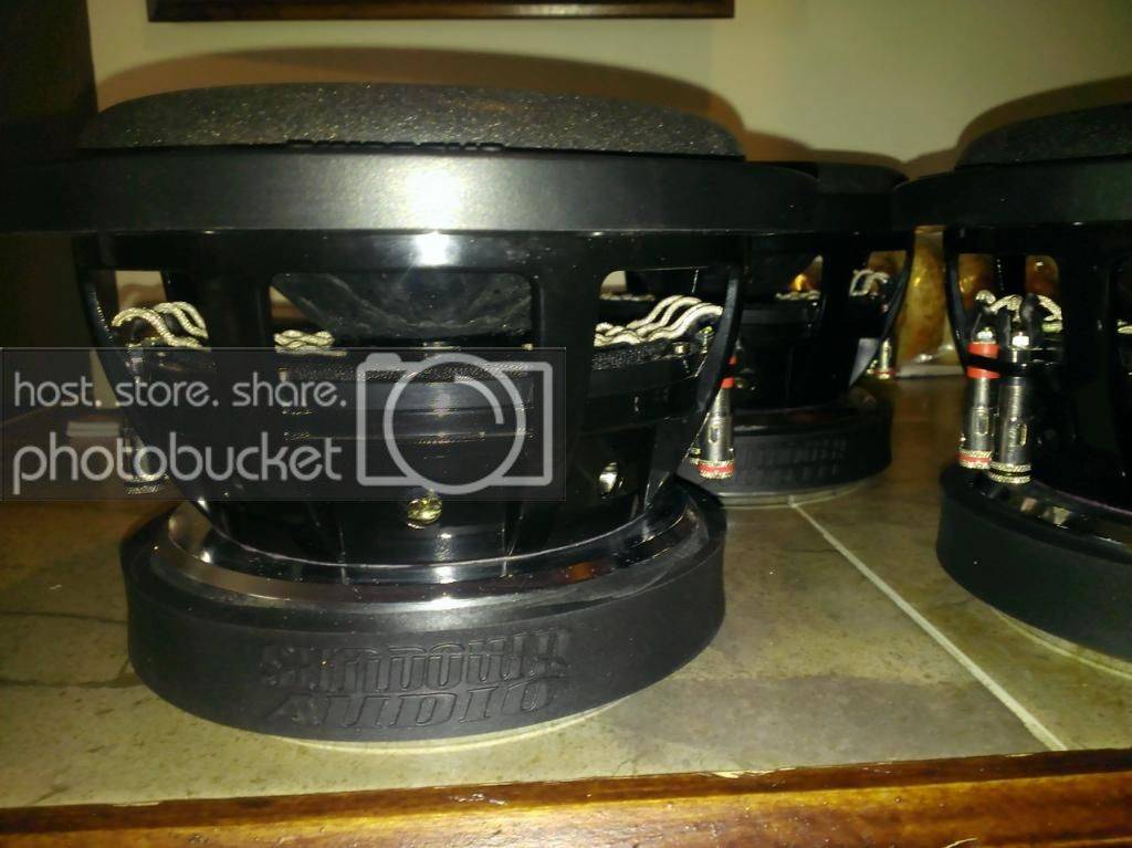

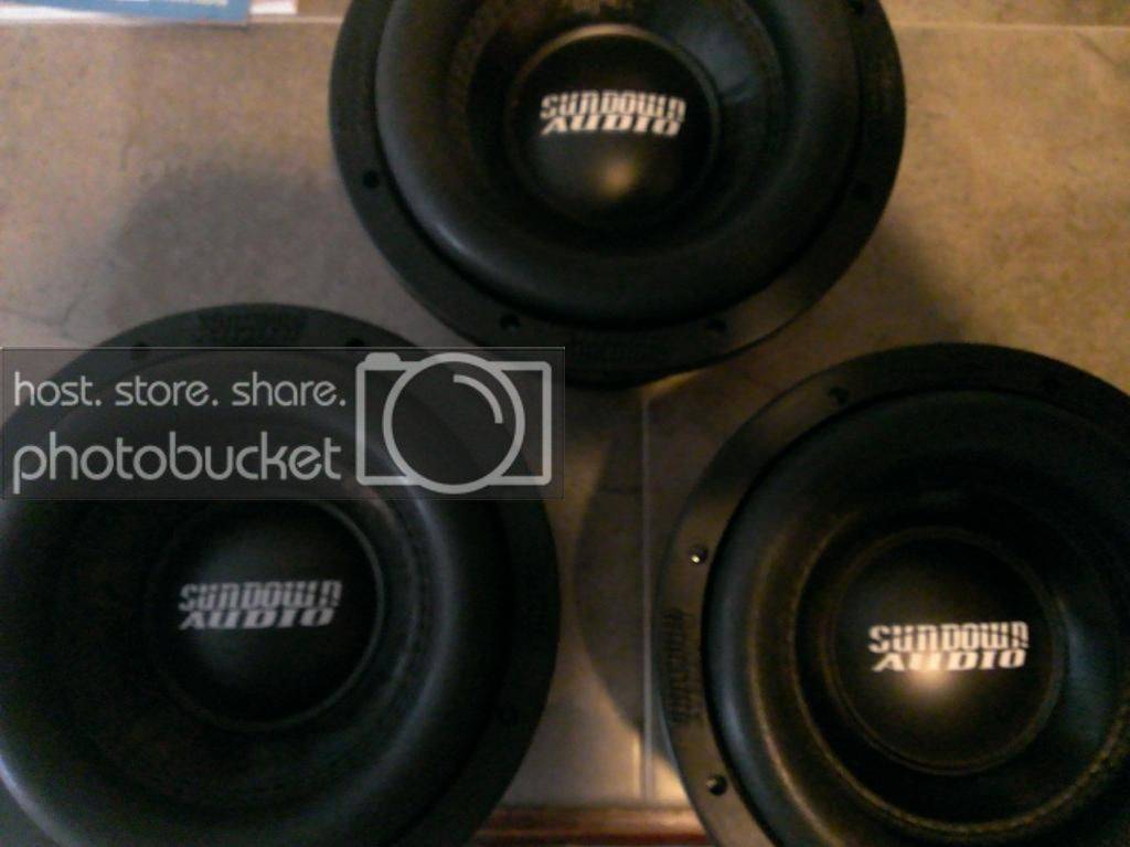

I want to do this as more of an SQ build than anything. I have been intrigued by the Sundown SD8s for awhile and saw an opportunity to use them.

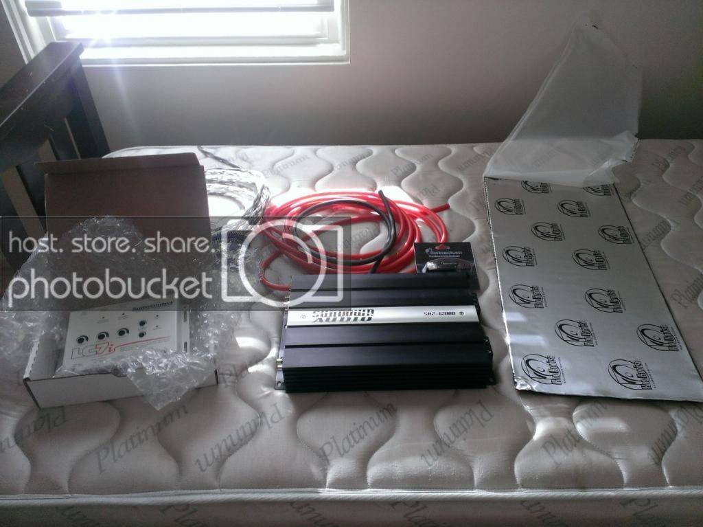

Equipment list:

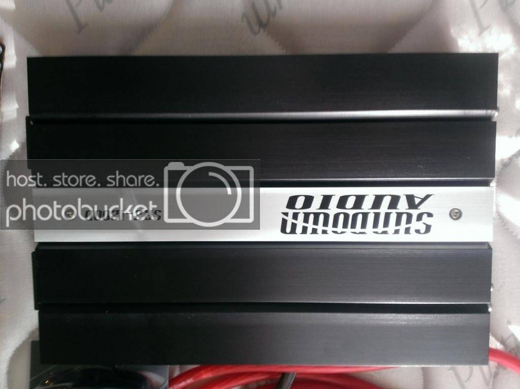

Sundown SD8 d4s x3
Sundown Saz-1200d@.66ohms
All wiring is Knukonceptz
Knukonceptz kolussus 100mil sound deadener
Old school rockford Fosgate punch 250a2 and some PHD passive crossovers

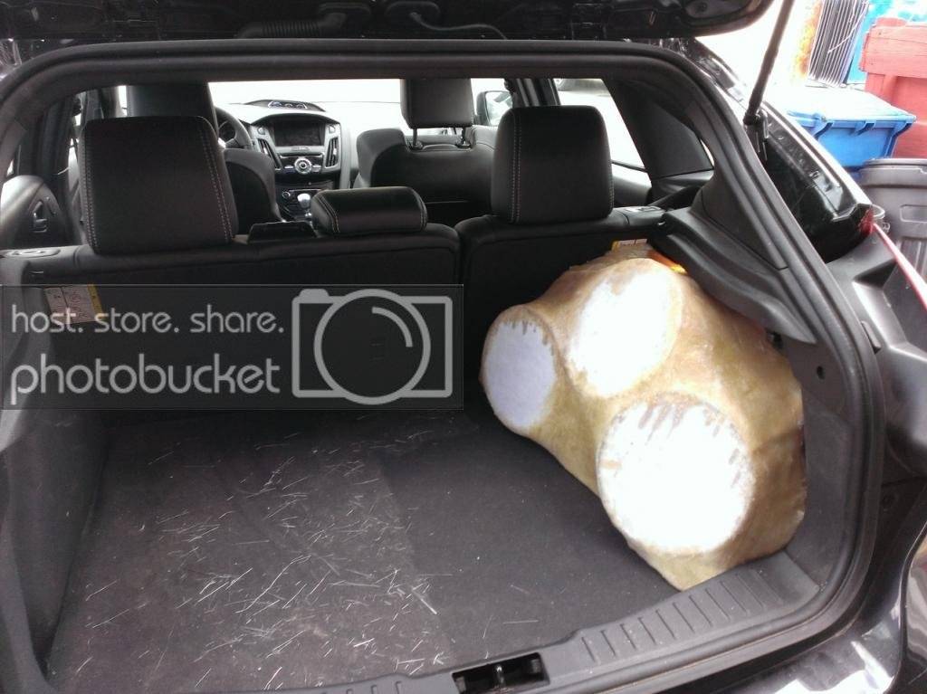

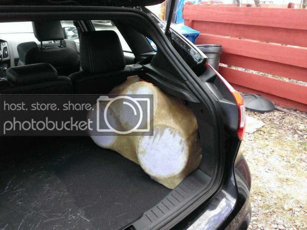

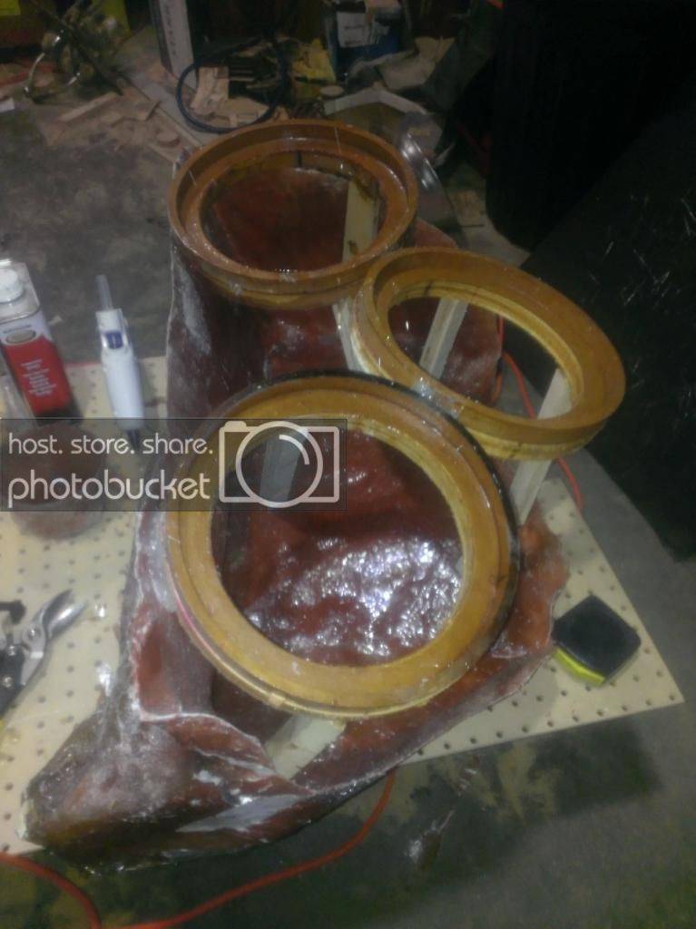

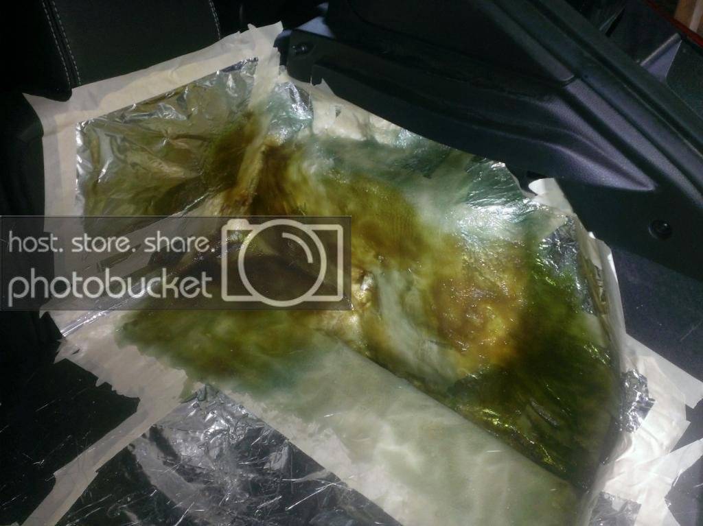

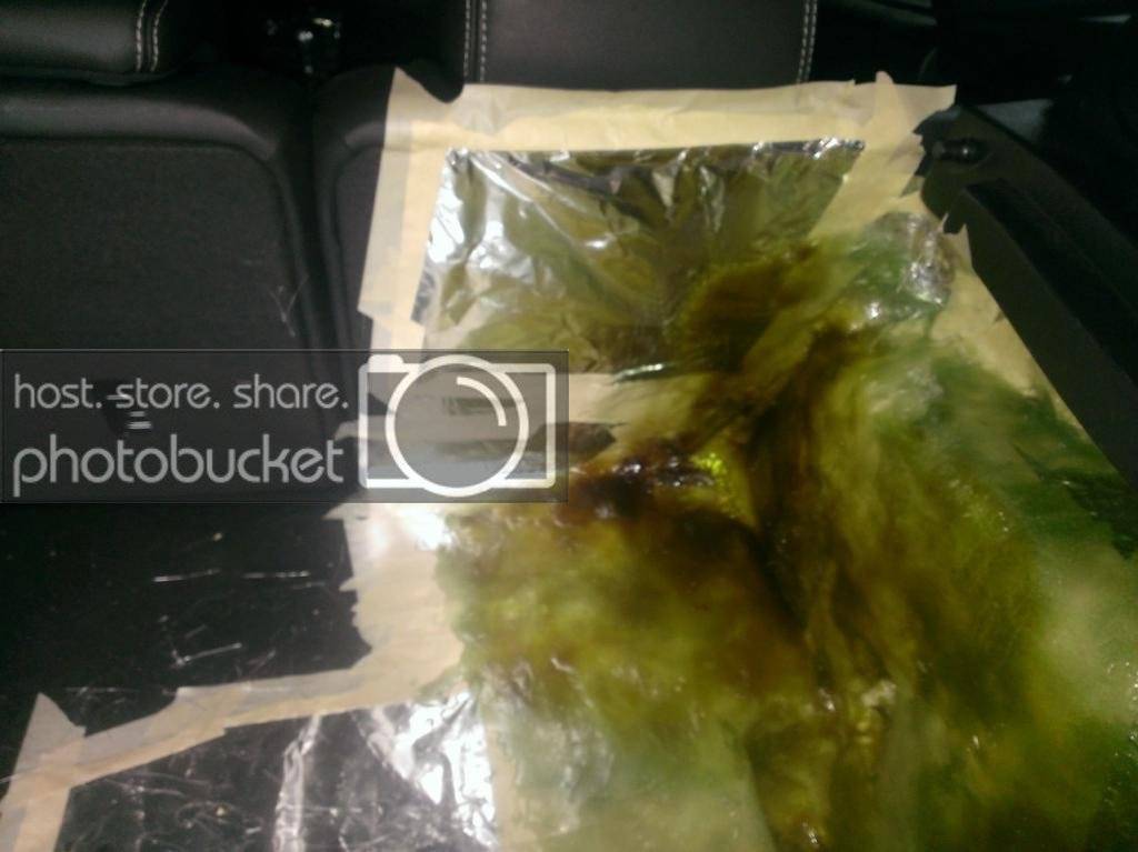

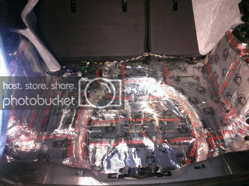

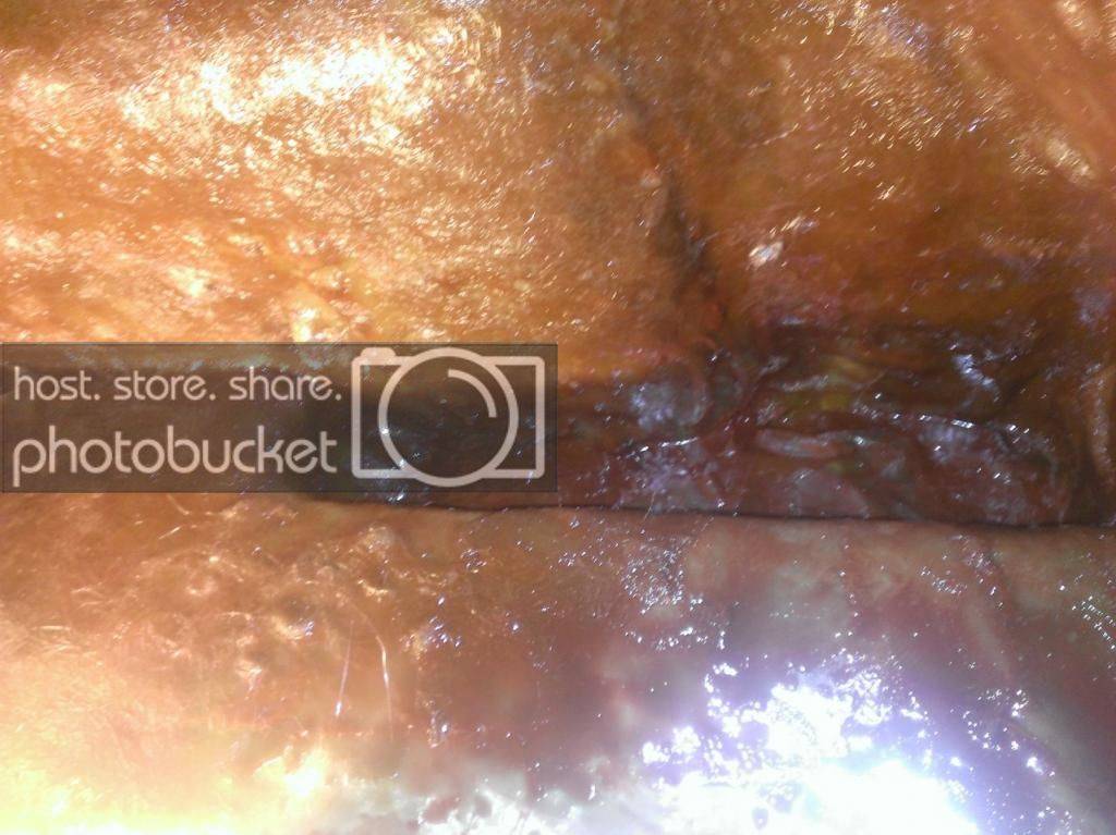

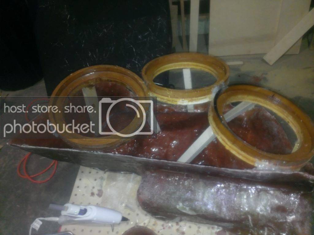

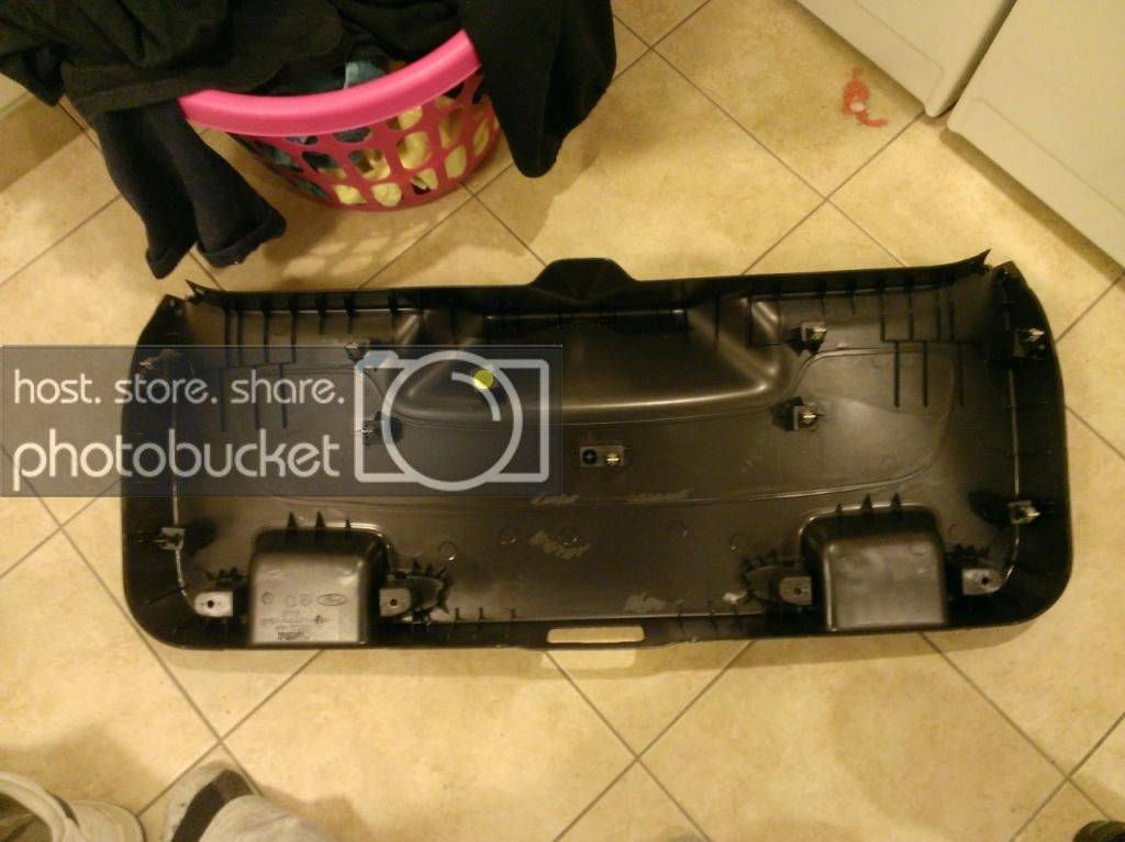

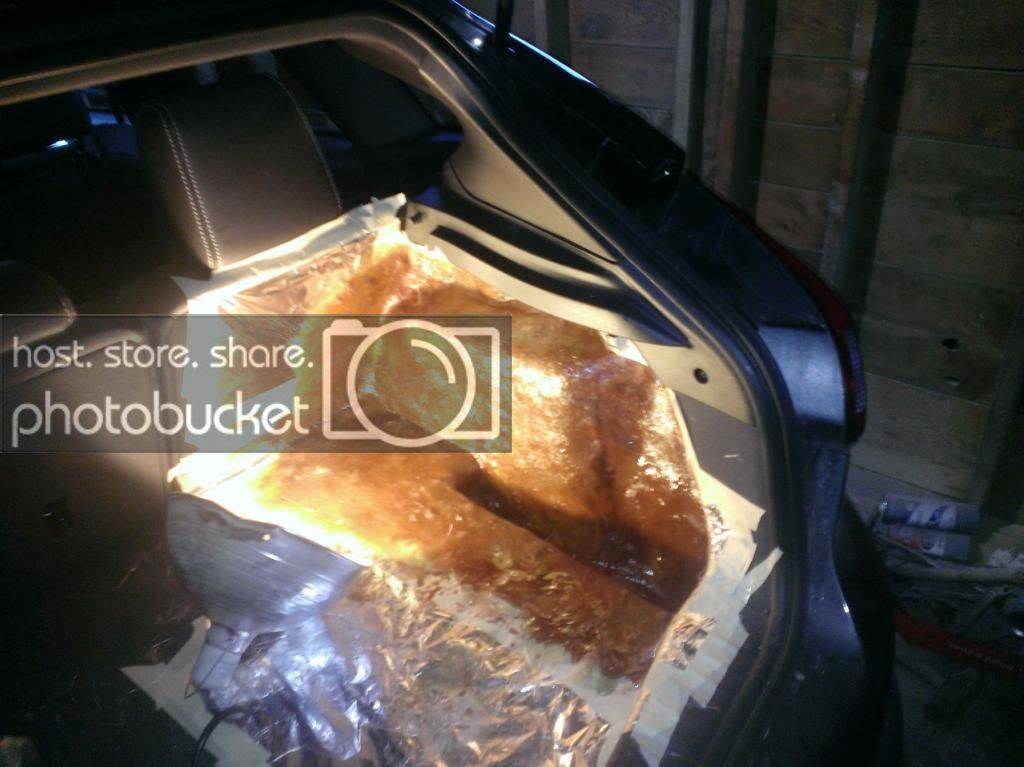

The SD 8's are going to be about 1.25-1.5 cubes sealed for the 3. Its a little on the large side but will let them dig a little deeper and they will fit a little better with the extra depth. I'm going to fiberglass the enclosure to fit over the passenger side wheel well. The hatch after the first layer of glass was laid down.

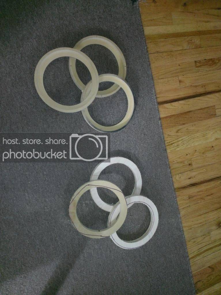

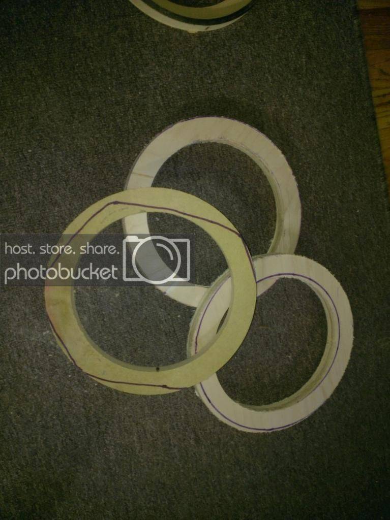

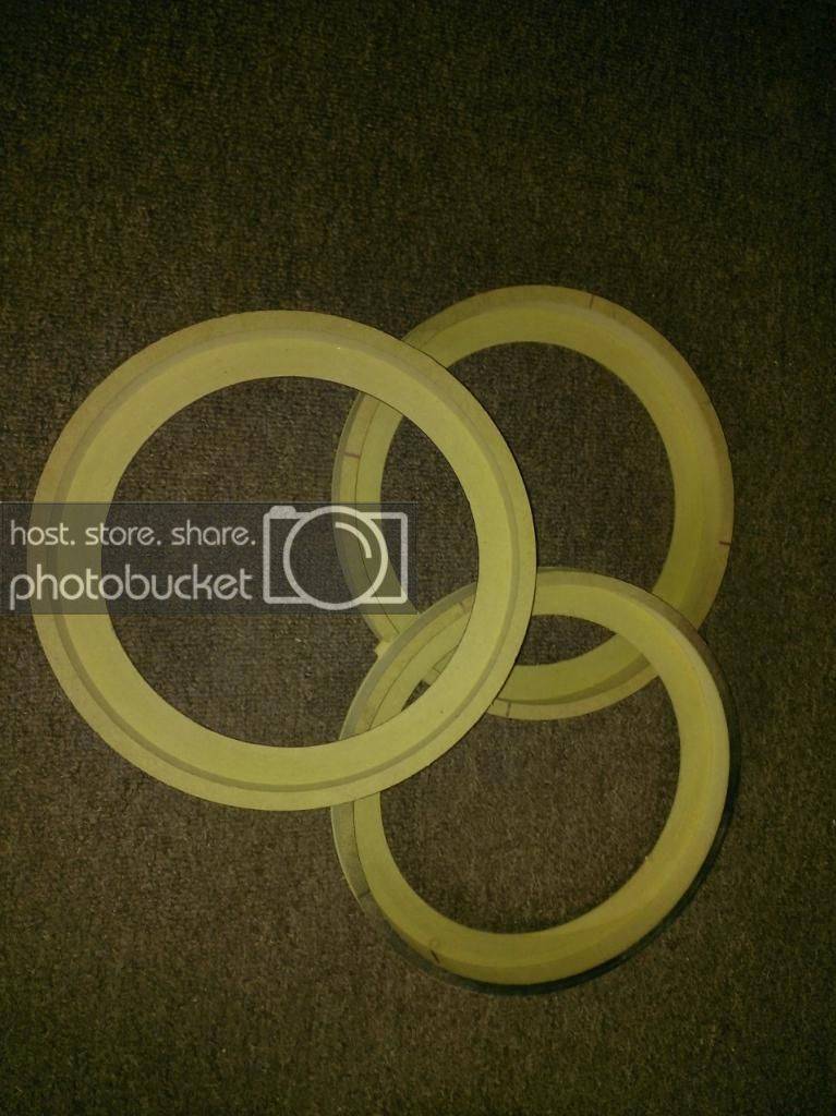

I got the speaker rings cut. I ran out of 3/4 inch mdf so I used some 3/4 hardwood plywood to finish it off. I decided to flush mount on these as I think it will look better.

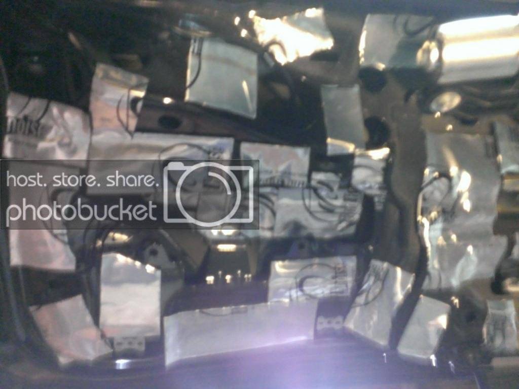

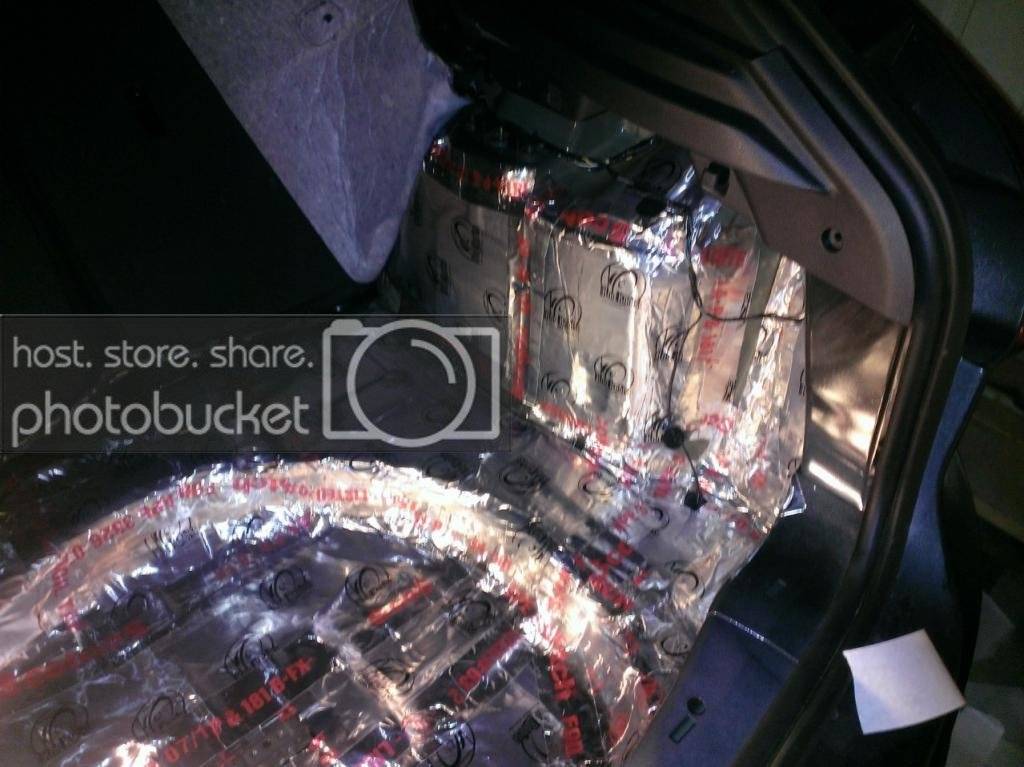

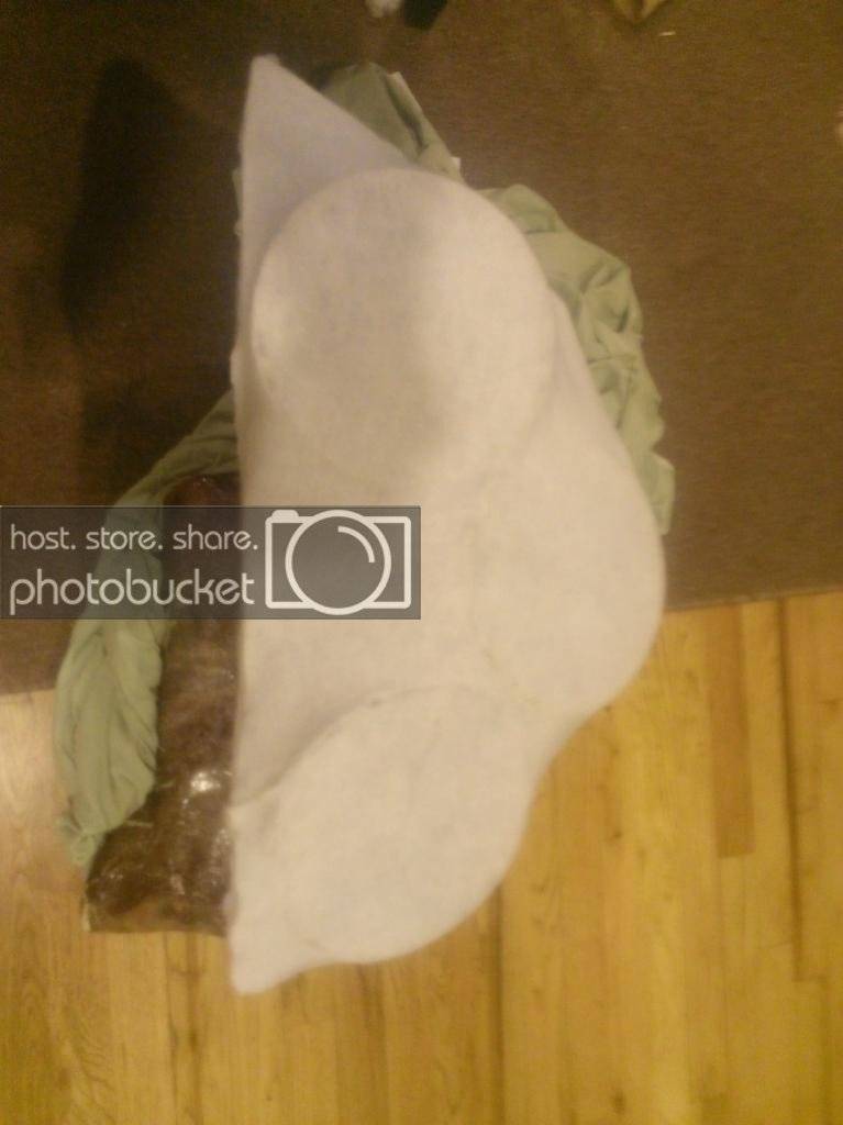

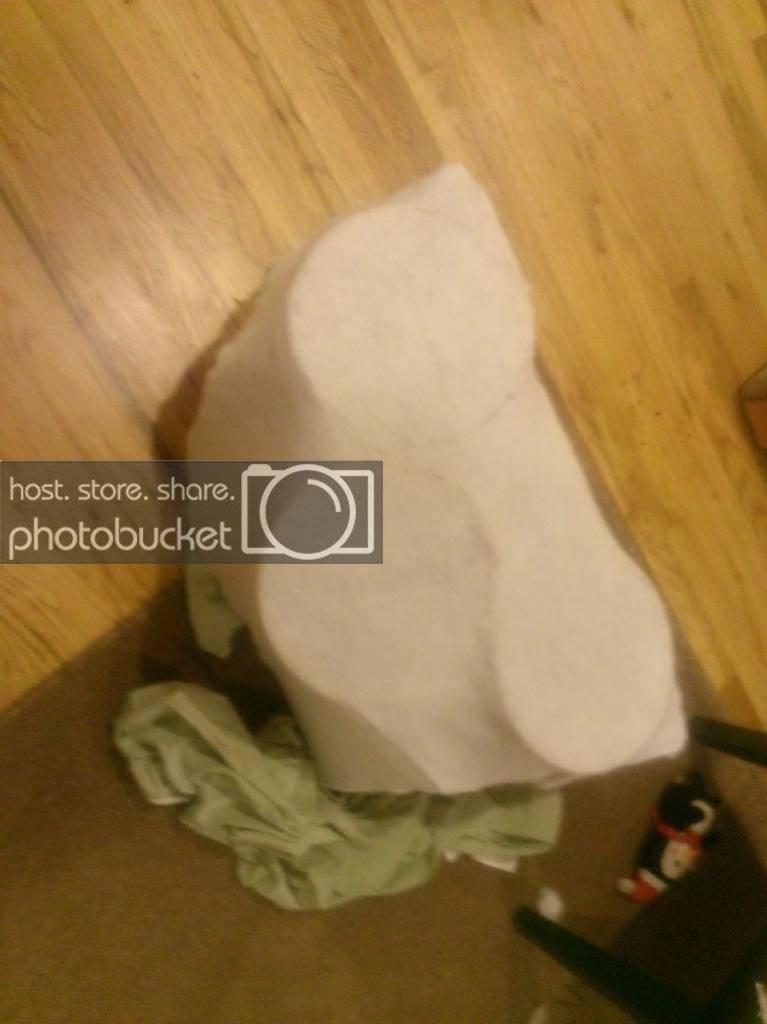

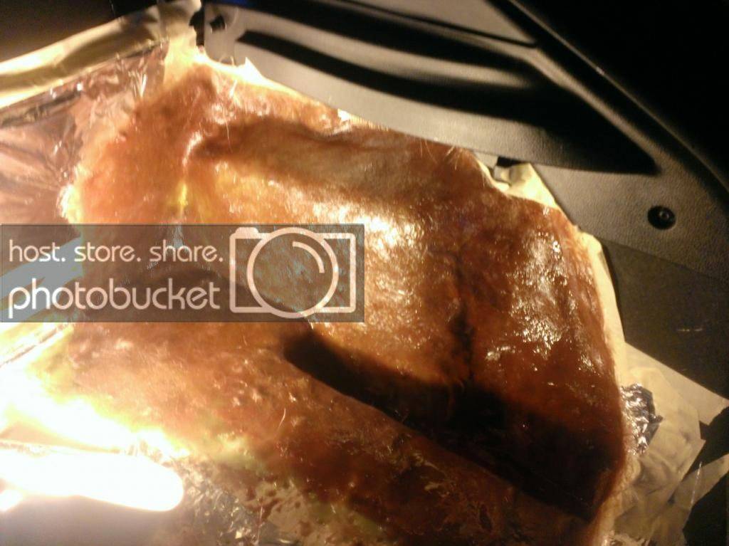

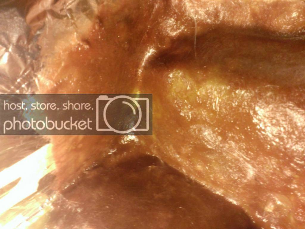

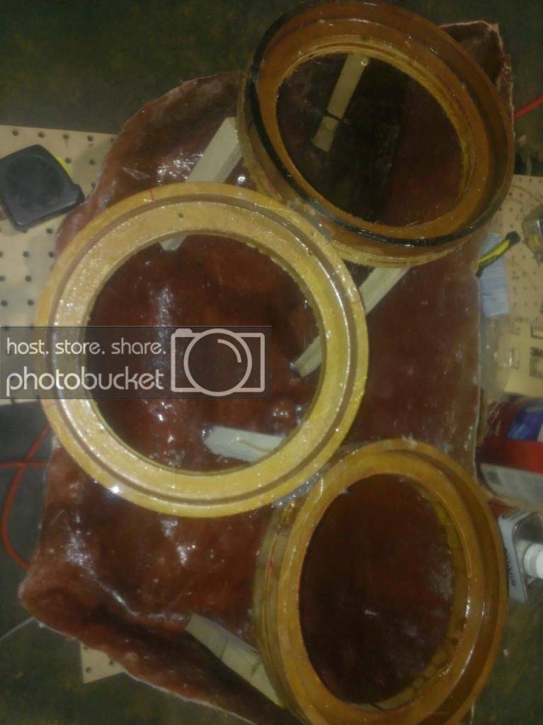

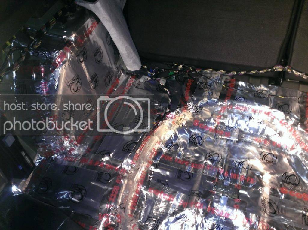

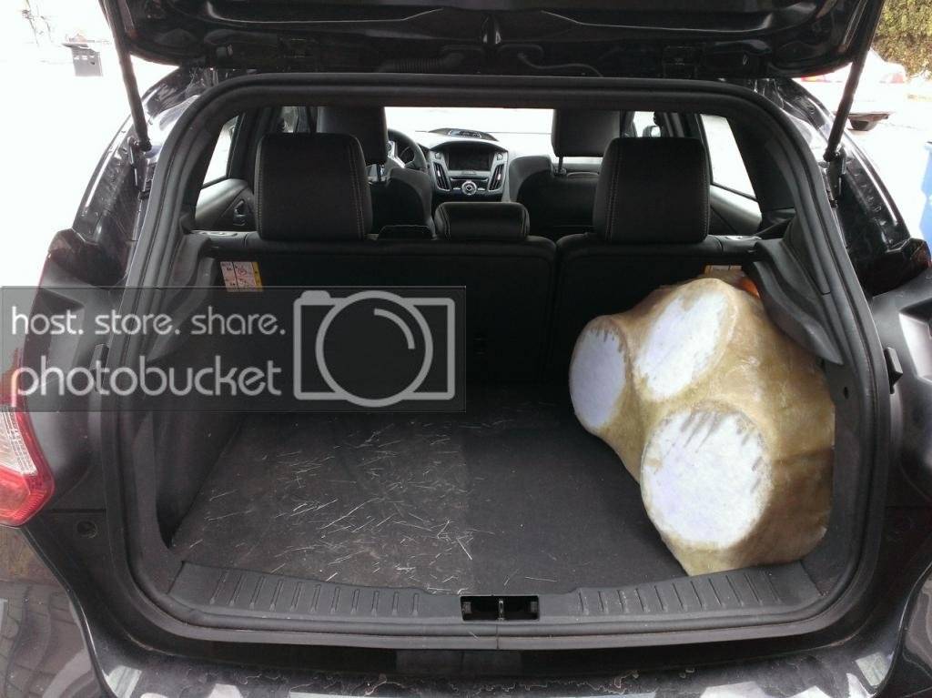

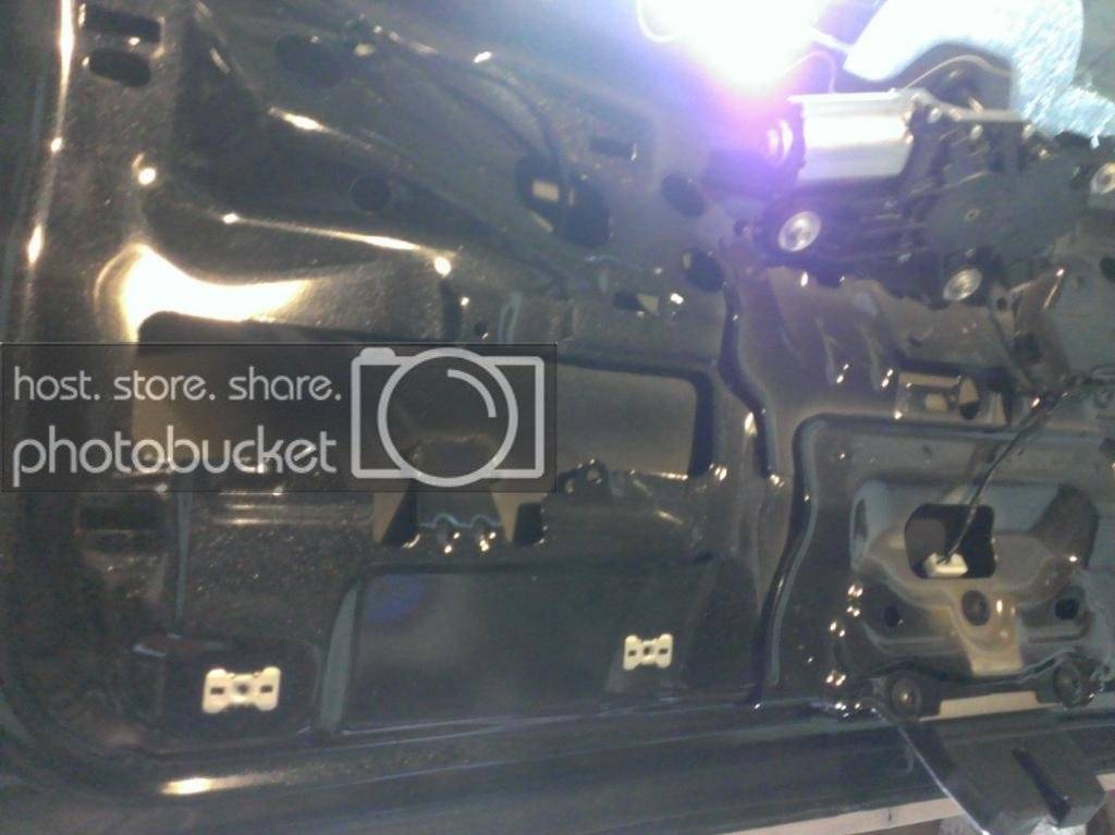

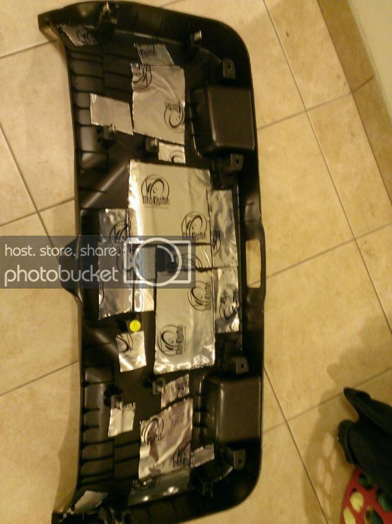

I got it all wrapped up in fleece and soaked with resin. I decided to deaden the hatch door while it dried. Then afterwards I did a test fit.
---------- Post added at 10:31 PM ---------- Previous post was at 10:30 PM ----------

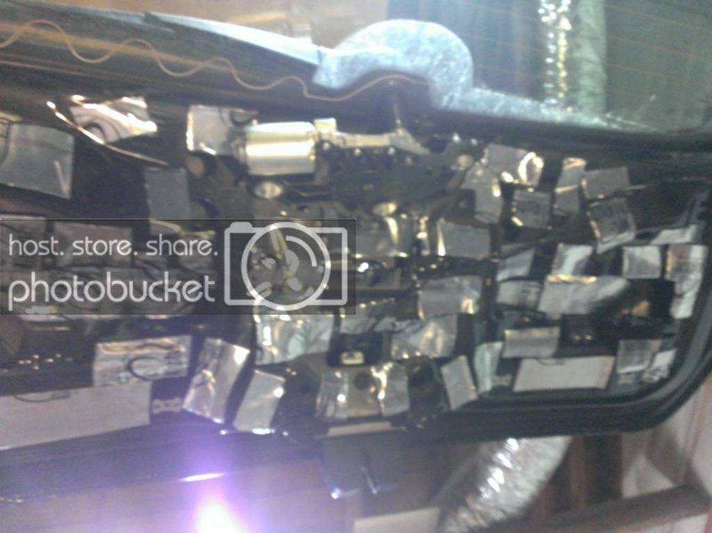

I got the box wrapped up in carpet and installed. I should have taken more pics of install, but I'll update a lot more this summer when I do my front stage and electrical upgrades. The outer door skins are deadened and I wired in a set of PHD crossovers on the factory comps. They are being ran off of an old school rockford fosgate punch 250a2 getting about 50 per side. They sound quite nice considering they are the factory set.
