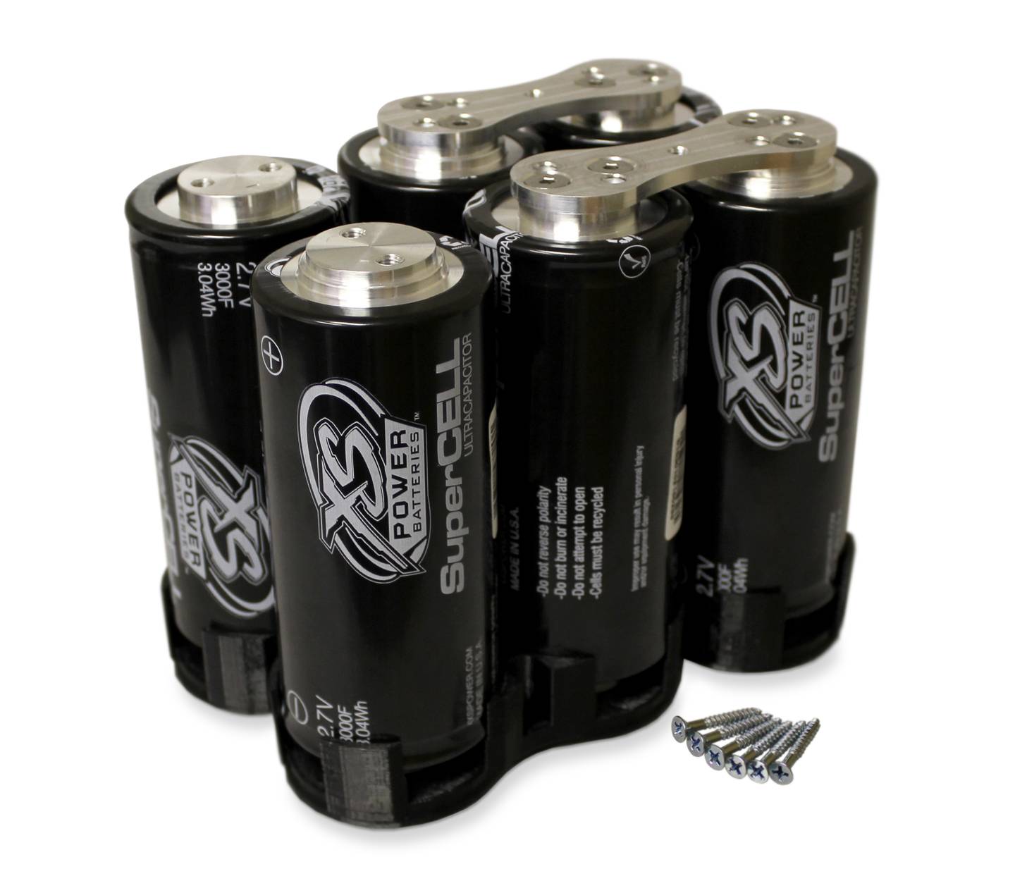

these are the capacitors that you want:
(supercapacitors with 3000f each, or about 500f per bank)
these are not the capacitors you want:
5f or lower
if you dont know what you're talking about read this:
Capacitor
if you have no idea how capacitors with the appropriate capacitance can help don't try to explain it

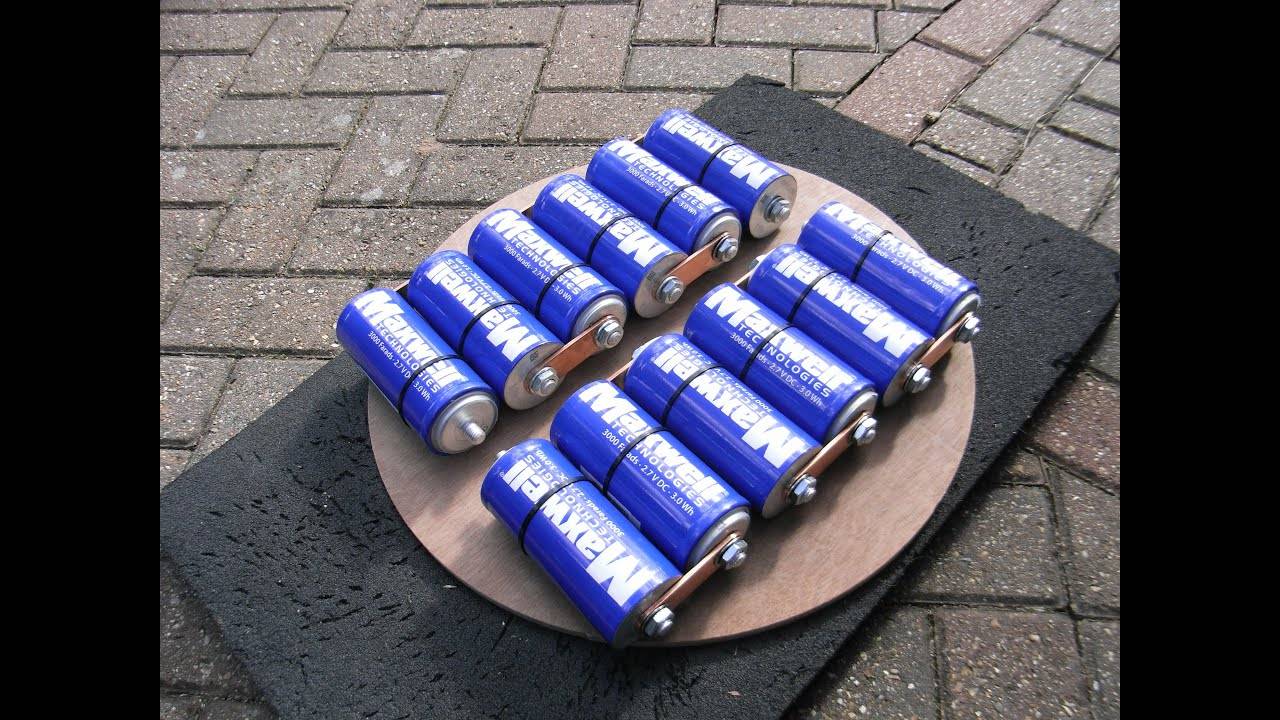

I run maxwell ultra capacitor banks with high output alts and adequate wiring....but I know nothing //content.invisioncic.com/y282845/emoticons/fro.gif.c695f1f814b01c4ad99fe7f8cccadd29.gif
