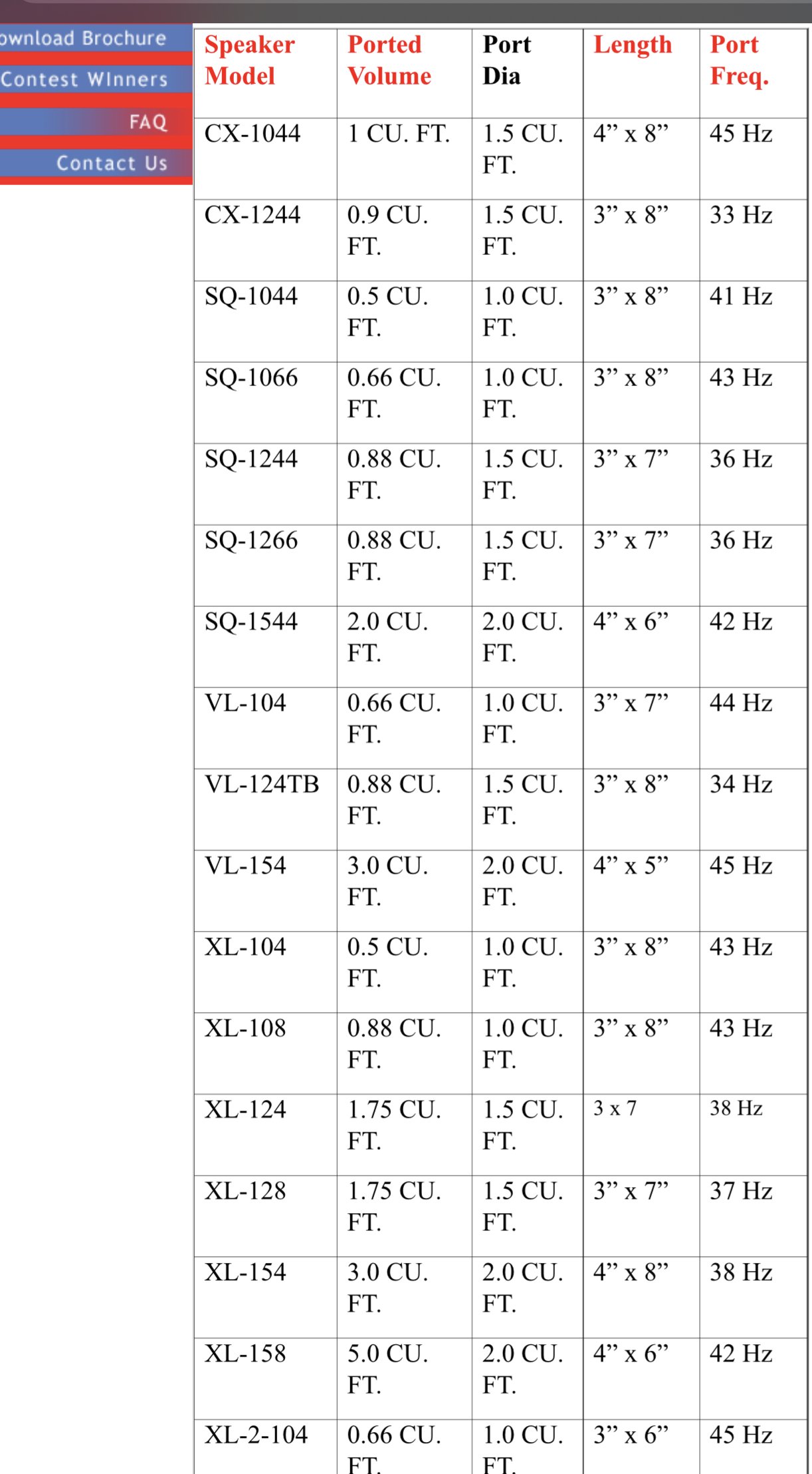

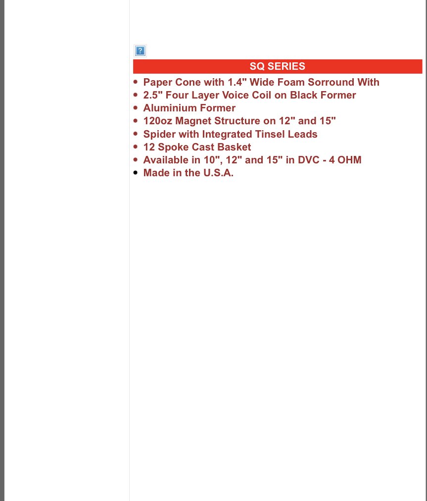

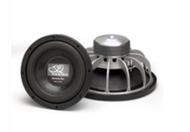

I just got a pair of American Bass SQ 12’s and can’t find any info on them. They have dual voice coils and wondering if anyone has any info on them. They came in a bassworx dual 12 ported enclosure that I think is way too small
They are dual 4 ohm subs but I was curious about rms and enclosure volume for ported
If I remember correctly they are 600 watts rms each. I never used them so I really don’t know about the box specs. I haven’t seen any of those around for several years now.
Basket looks like the older XFL series, and the cone area looks like the older TNT series to me. I dont believe I have ever seen that sub. I dont remember it. Deff cool looking. Id try 600 watts on them to see how they hold up if coils read good and apply a little more at a time. Look like thay could handle 1k all day though.
Me neither. When was AB Made in the USA? It had to be very early on in the life of AB.
