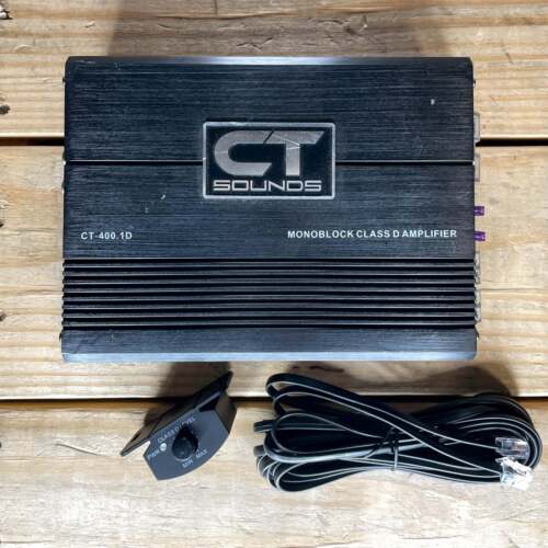

Just to tease:
Amazon product ASIN B0007XV5FY
$120
2 of these wired at 4ohms each:
$140
One of these at 4 ohms bridged - 370watts per channel:
$69
Total: 329 plus tax.
Some systems are out of reach, for others there's MasterCard!

Don't mind the (affectionally known as) BASSHEAD zealots. That system that I recommended at $329 and some change will put out TONS of bass for daily driving pleasure, LOTS! That amp on sale for $69 puts out 370 watts of power bridged x2. That's the same as a 740 watt monoblock!
Run with it and then come back and share how awesome it sounds, I think that you'll be impressed!
