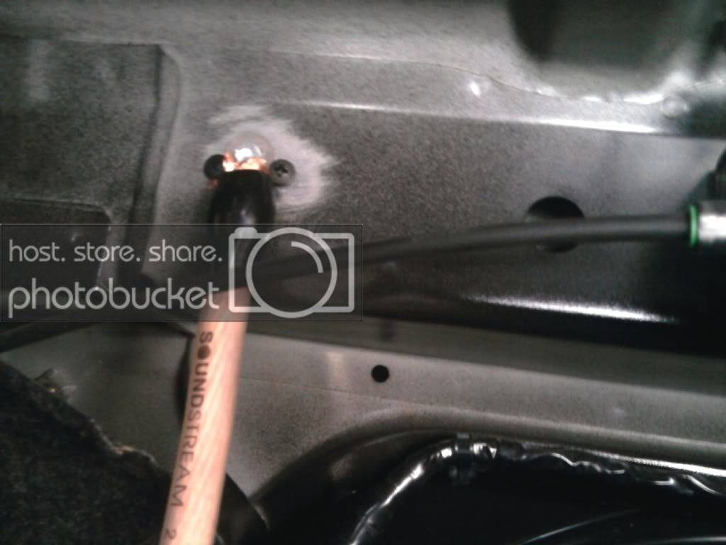

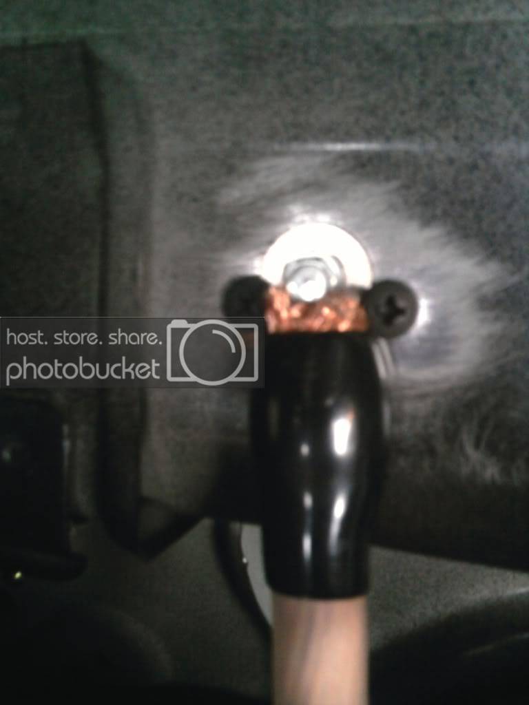

ground is on top of the trunk? you need to make sure the ground is in a clean bare metal spot, preferably to the chassis and tight!
as for the mp3 player get a headphone to rca adapter ( walmart/radio shack for a few bux ) and plug it directly into the amp and see if the problem is still apparent.
if the problem goes away you have a bad or shorting RCA cable. if it does not go away it may just be your ground... do that and let us know...
let me restate that. It is in the back of my trunk, on this metal frame behind the seats.
those are some quick photos i took...hope they give u a good feel for how it looks like...

No problem with the top of the trunk, so be as long as it's bare metal and secure.
I was using the top of my trunk for a while. It was bare metal, and **** secure. I had zero issues. The whole body / chassis THEORETICALLY is a single node, as such it shouldn't matter where the ground is, as long as it's a direct connection.
But, all cars are not made equal, and as such, you should always try to get it as close to the engine bay / chassis as possible.
EDIT:: OP, to me it looks like your ground is fine. Looks pretty secure to me, and it APPEARS to be bare metal. The quality is shitte, so I couldn't really tell.
