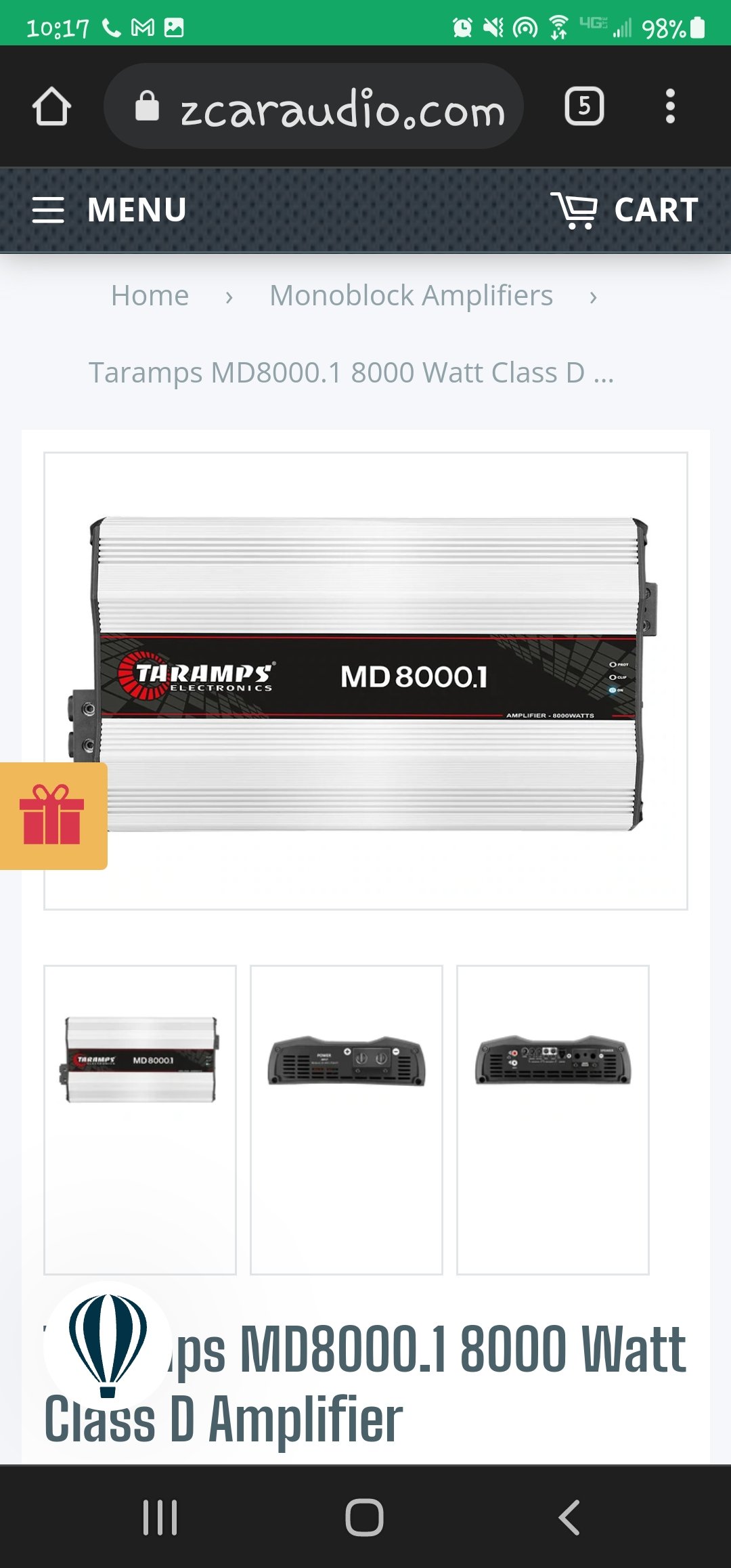

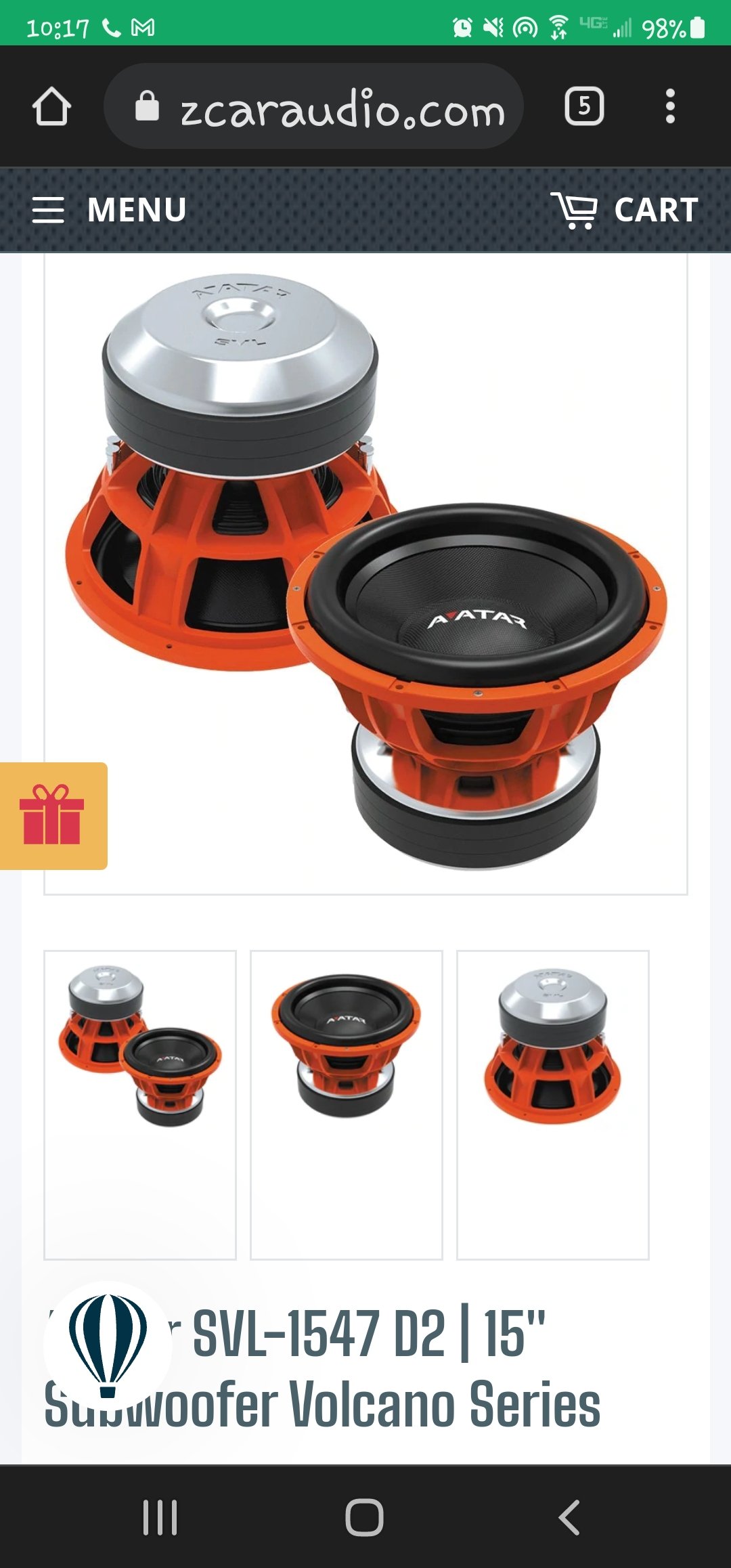

I just stepped up my bass game an bought this combo. Can anyone please help I can't find a review on these for anything. Just curious what kind of performance I can expect.

You can expect it to get loud. Put it in a 3.5 cubic ft. box with a port tuning at 30-32 HZ, if you are using it for a music playing setup. Brace it for the apocalypse and do a 2.25 inch thick baffle.

Thanks I appreciate the feedback!! I cant wait to get it going !
I got a 3.85 box an its lined with mdf tuned at 31 what ya think
