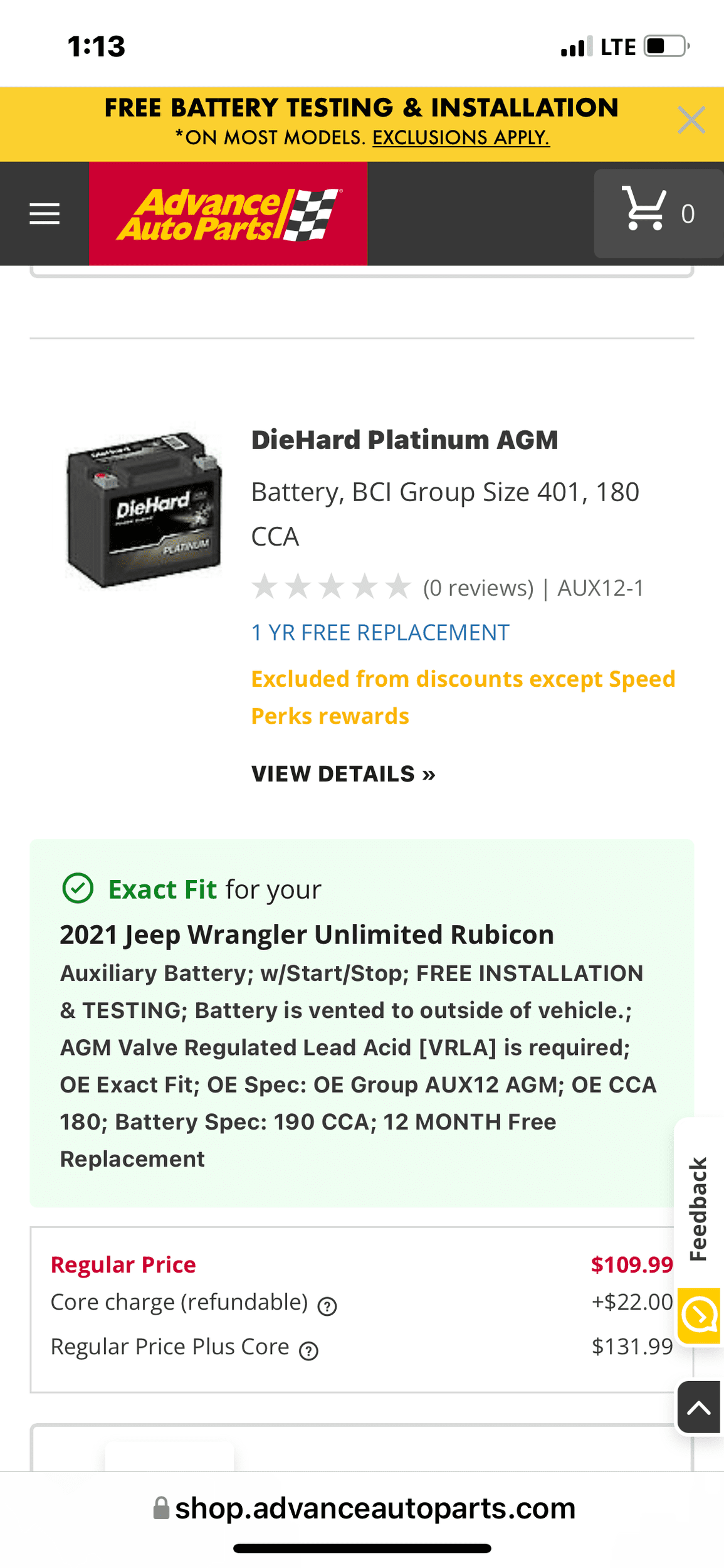

it’s an interesting setup with the small auxiliary battery under the main one. I tried charging both batteries separate and was only able to get the larger one to charge. That said, I didn’t pull the small one out, because it’s a pain to do. I will see if advanced auto parts can test the voltage on each when I go down there. The auxiliary battery I was looking at is only $109.

That auxiliary battery group 401 looks like the size I run in my 4 wheeler so I wouldn't expect that's doing a lot of heavy lifting for you. Even filling that size spot with lithium wouldn't give you a whole lot of extra storage or current on demand. IMO that seems a very silly design, but then again those cars that start and stop the engine all the time when you're stopped at a light or whatever feel like a recipe for trouble down the road in the first place.

Thanks for all the replies. I figured the voltage drop was not normal and a sign. I’m probably just going to go down and get diehard platinum agm replacements for both today. $209 + $109 = $318 total to not have to worry about it for a while.
