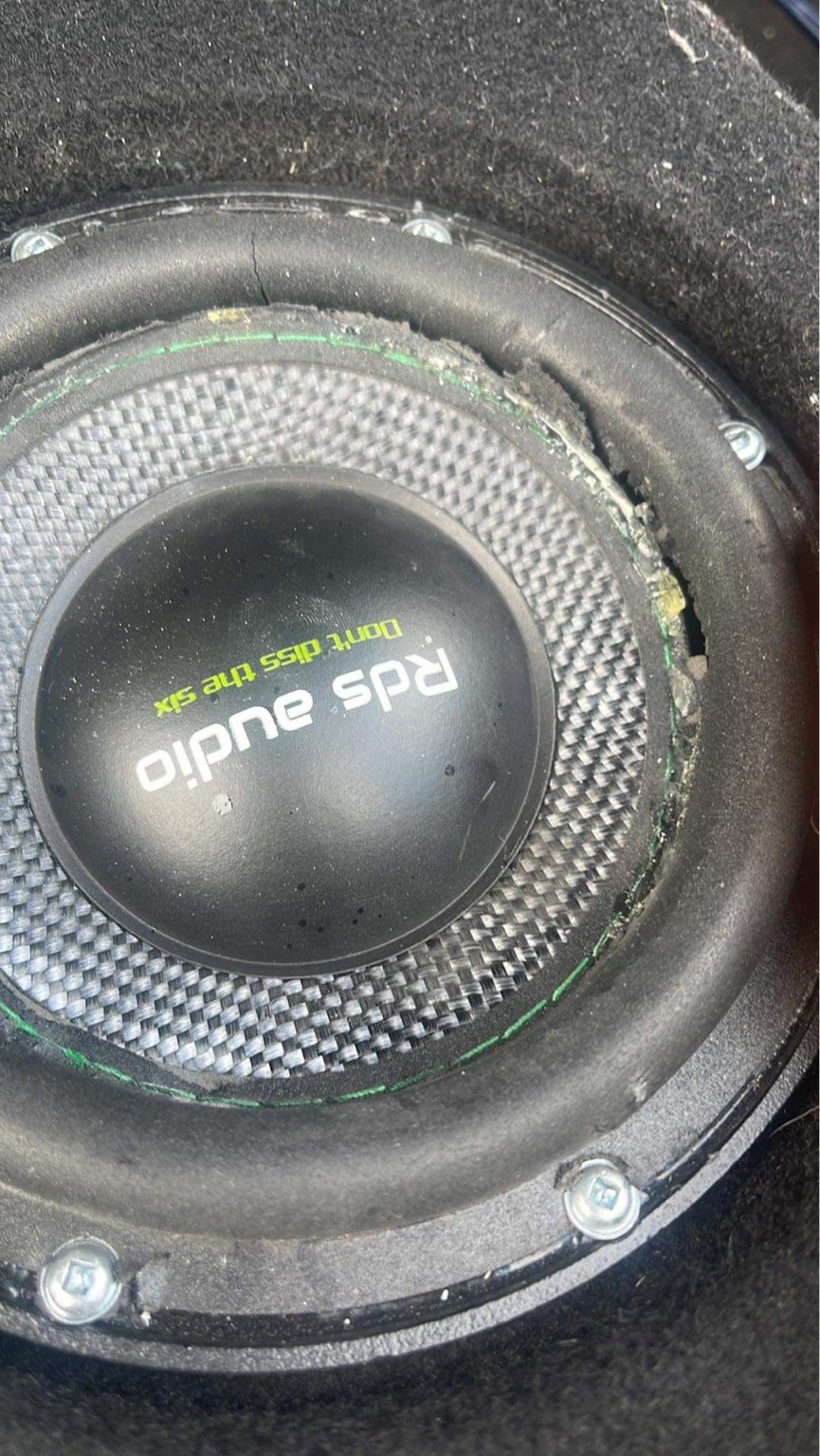

Those Rds 6.5's are capable. People constantly try to throw a strong 3K or more at them then play under 30hz content full bore resulting in what you pictured above. They even overpower the ssf setting sometimes... no joke. Any idea where the box was supposed to be tuned in that photo? I've done multiple designs for those subs and they'll perform but they do have limits. I cringe when hearing someone wants those subs on a big (3K+) amplifier. Dollars to donuts they'll be trying to play content under 30hz boosted by an epicenter. I try to design around preferred music and hard usage but there's only so much you can do. Here's an example...
Tuned 36hz playing under 30hz with big power is a recipe for failure, and Its always the enclosure's fault. Its the 1st place everyone points their finger when subs die. "User error" is alive and well just as its always been... :LOL:

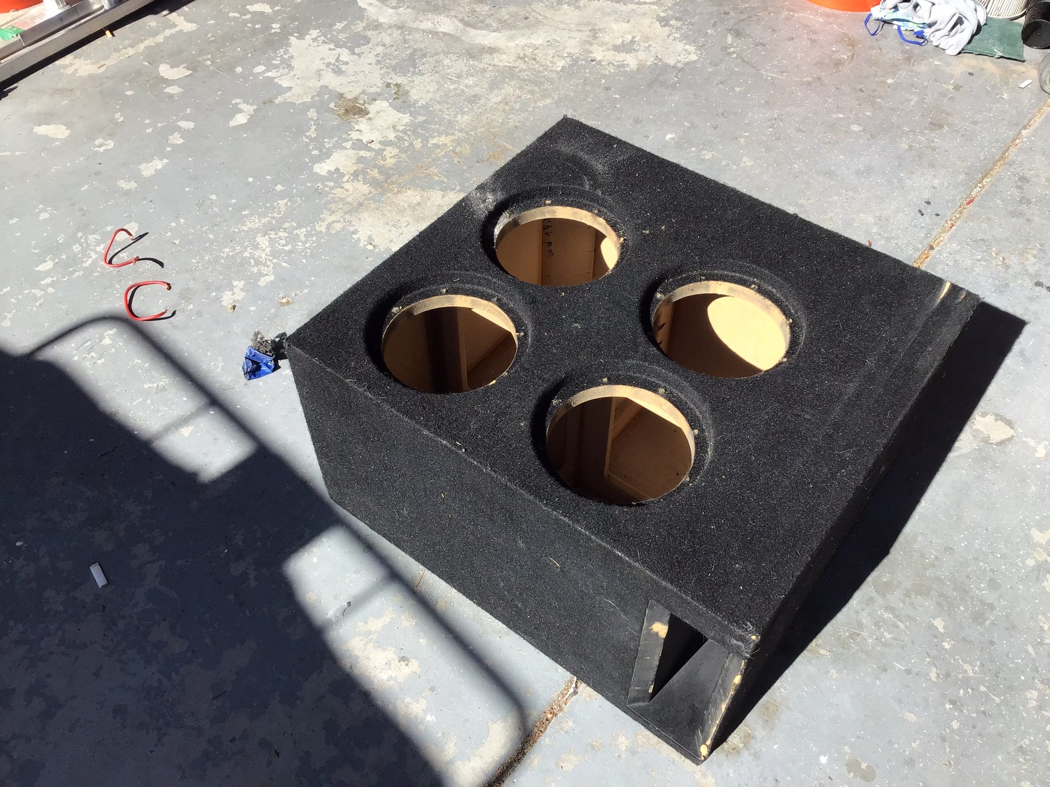

This was one of the enclosures. 3 out of 4 of them had been shredded. The enclosure is actually a decent enclosure. I didn’t measure it, but it looks to be about 2 cubes tuned to 34-37 HZ. Would work fine with proper power and a SSF. I took the one that wasn’t fully exploded and put it in a 6th order just to play with and it was an impressive little subwoofer within its limits. I bought an 8 from Rick after i came across these and it’s an incredible little beast.

Yep... I remember that one. Iirc it's tuned 34hz and was killing the Integra. He sold it immediately after it got demoed a few times. To who I can't recall but it sounded great. It sold itself.
I didn’t get to hear it. The subs were completely destroyed. all torn on the same spot on the subs. The only one with good coils was also torn, so I did a half ass fix with silicone on the surround just to see what it could do. To my surprise it lasted a good month being pushed pretty hard before it finally tore open again.
In the Integra that setup was on 1500w, I wonder what amp it ended up being powered by?
Probably a 3k or more by the looks of it... Lol.

Probably. An 18 year old kid is who had it in the end. someone gave it to him. He already had 2 sundown classic 12s and wanted to know if he’d be louder with these 6.5s, and sent me a video of Ricks metering score at IFO last year and wanted a box made. I really had to do some work to talk him out of buying 6.5s to replace his 12s. I finally talked him into just getting a box for his 12s.
