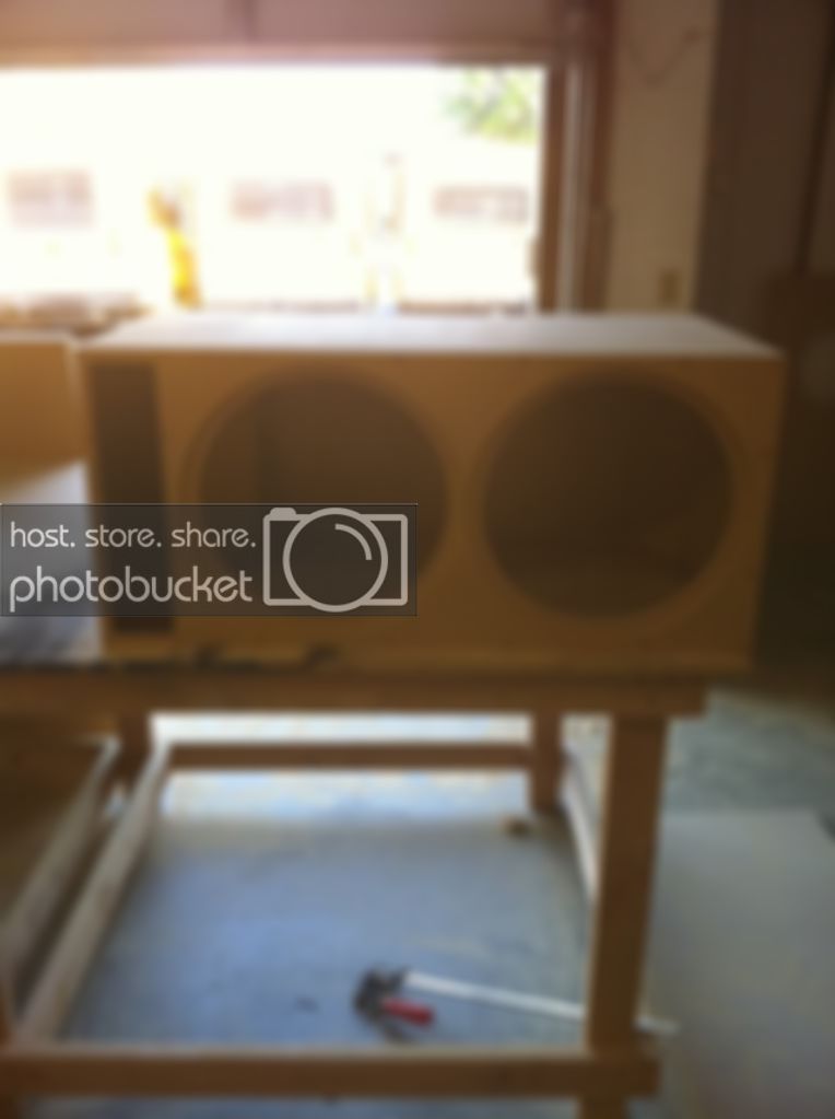

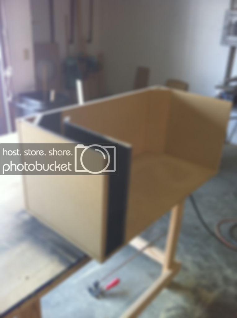

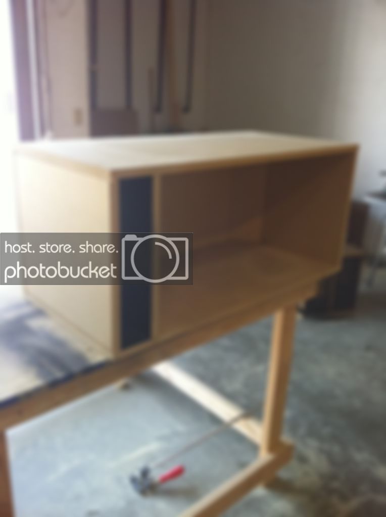

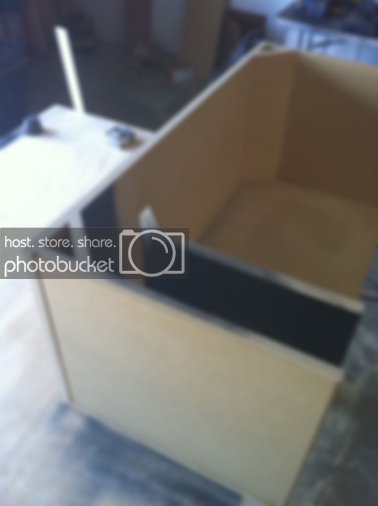

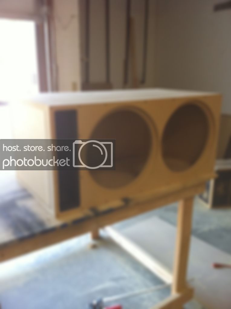

Ok everyone this box is for Eric's two Lanzar OPTI1533D 15's
Box is 5.0 cubic feet after displacement with 55 square inches for port tuned to 35Hz.
Nice subs! Small box though, hm...
Subs require between 2.0-3.0 cubic feet each. So the box is right in the middle. Not every 15 requires a 4 cubic foot box. Look at the DB Drive K9's for example.
That is just a tad bigger than my box for a single 15", way too small. Craftsmanship is A+ though.
Box is perfect size for those subs. Any larger of an enclosure and it would not fit in his car.
Thank you sir!
That's a small box.
That's what she said. LOL
You never know... Sometimes tiny boxes can be very loud.
Exactly. //content.invisioncic.com/y282845/emoticons/smile.gif.1ebc41e1811405b213edfc4622c41e27.gif

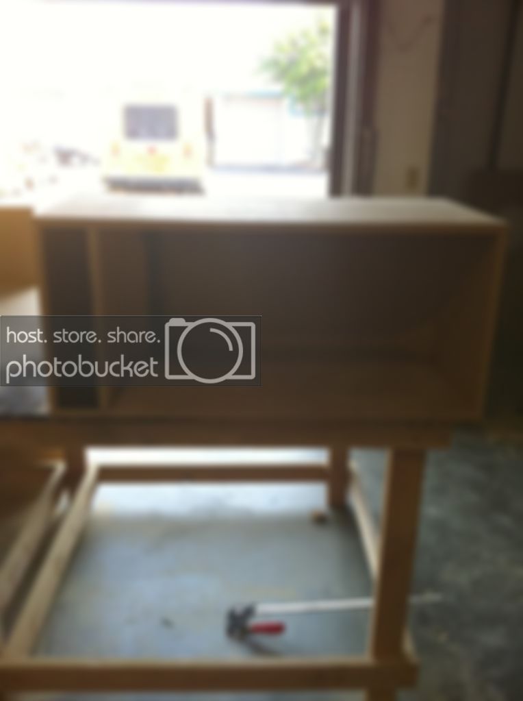

Pair of 15's with no internal bracing? GL with that one.
Guess i will be waiting by the phone for when he calls and tells me the box blew apart. //content.invisioncic.com/y282845/emoticons/rolleyes.gif.c1fef805e9d1464d377451cd5bc18bfb.gif
lol at all the guys talking **** that dont know **** about boxes.
looks good, im curious to see how it performs.
I know alot of "****" about boxes just not the subs he is using. 90% of 15" subs require at least 3 cuft which is why some of us say the box is small.
That is true, but these subs like smaller enclosures
So, 11 sq in of port per cube is enough as well?
This box is going into a trunk car. This is the largest port that we could fit.
