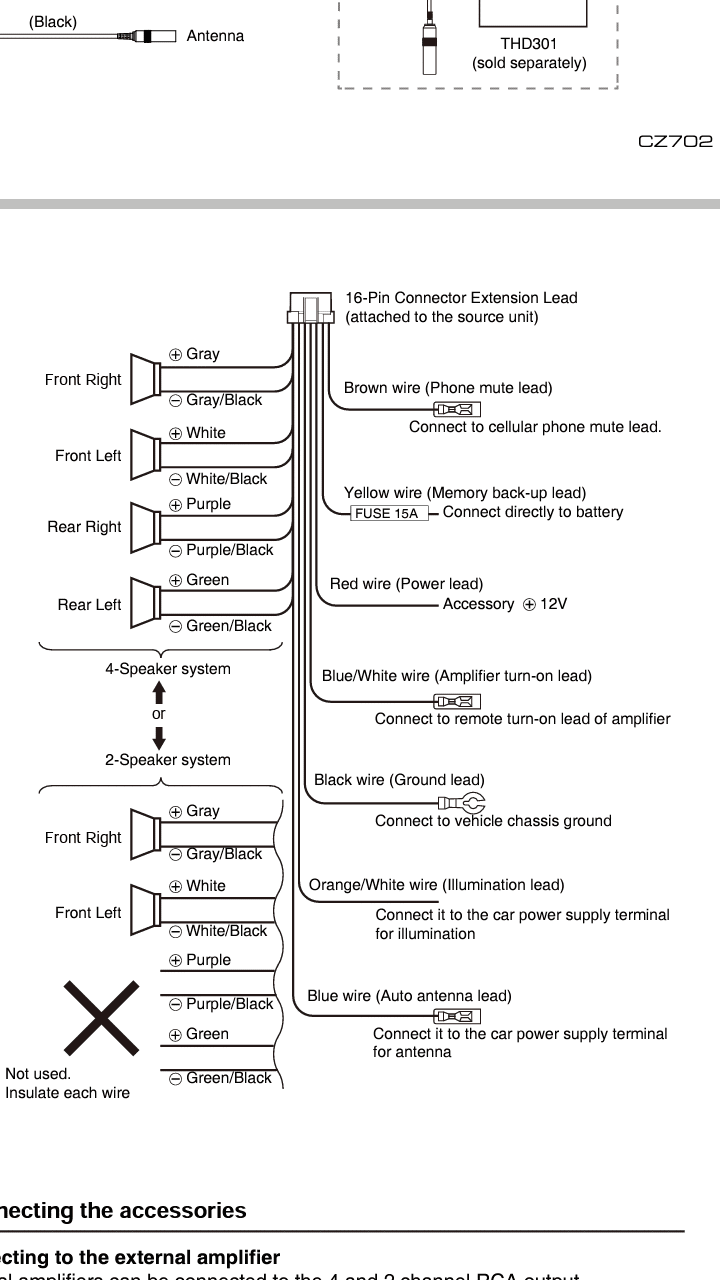

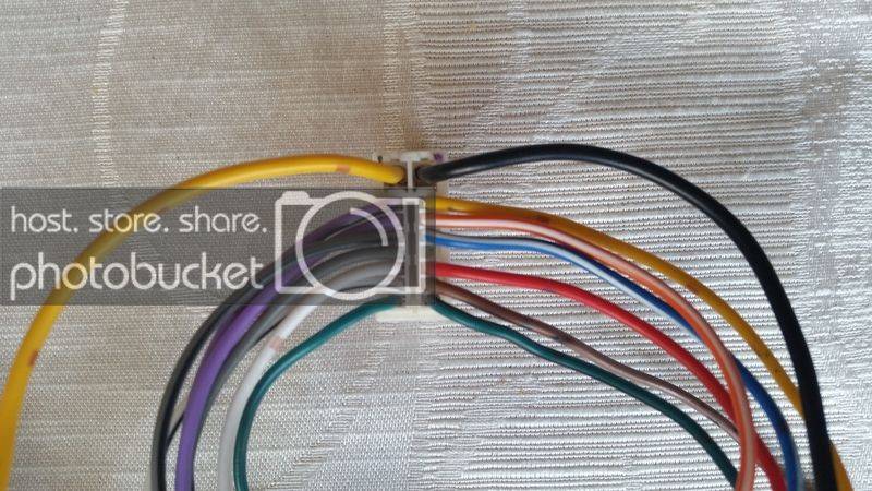

anychance that you can find me the color codes and maybe pin numbers for your connector as they are a bit different to mine ?
for one, the pink lead, third from left on your connector, is red on my connector...and second from right is free on yours, on mine there is a yellow lead...and the third from right on yours is red...on mine its orange with white stripe....

Yes its a cz702..
Yours and mine should be exactly the same.
Whatever you removed that connector from has different pin patterns.
Check on the unit that connector came from and see if the pins match or are different.

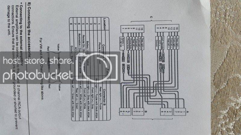

When looking in the cz702e manual the pin numbers in the C connector, does not add up....when compaered to the pictures of your connector, or for that matter with what I can google....I'm beginning to think that there is a problem with my manual...?

Hi..could you send me a picture..or maybe have a look at Los33's connector picture on the first page and see if your connector has the same wire colors in the same places ??
The thing is that on the picture I can see a pink (third from left) and a red (third from right) wire .. on my connector there is a red (third from left) wire and a orange/white (third from right) .. ?

Hi.. this is from my manual and a picture of the connector I have .. and it seems a bit different from yours ???
