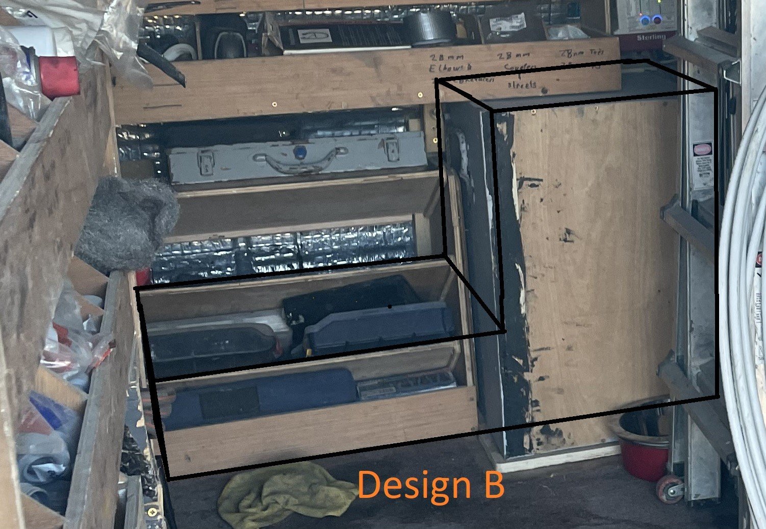

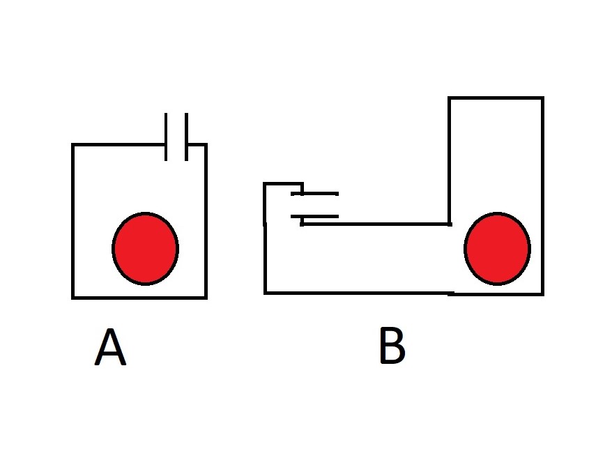

I have two very crude drawings above, A & B. From a design point of view having a box that goes all over the place as in B would be better as it would allow me to minimise the workspace lost in the back of my van. I can do a design like A but B would be better. Work-wise there is little in it, yes B is harder to build, but A would require more altering of shelving racking etc.
My concern/question is would the different enclosure shapes of the "sealed" part of the box make any difference to the sound (air being compressed to different pressures within an odd shape box say or harder for some parts to escape/enter via the port) or does it make zero difference?

The “B” box could have some issues if it’s a low profile and that sub magnet sits close to the opposite wall. the closed side will pressurize more than the side with the port. if that magnet is 3 or 4 inches from touching the back wall and allows free flow of air behind the magnet, the shape should be fine.

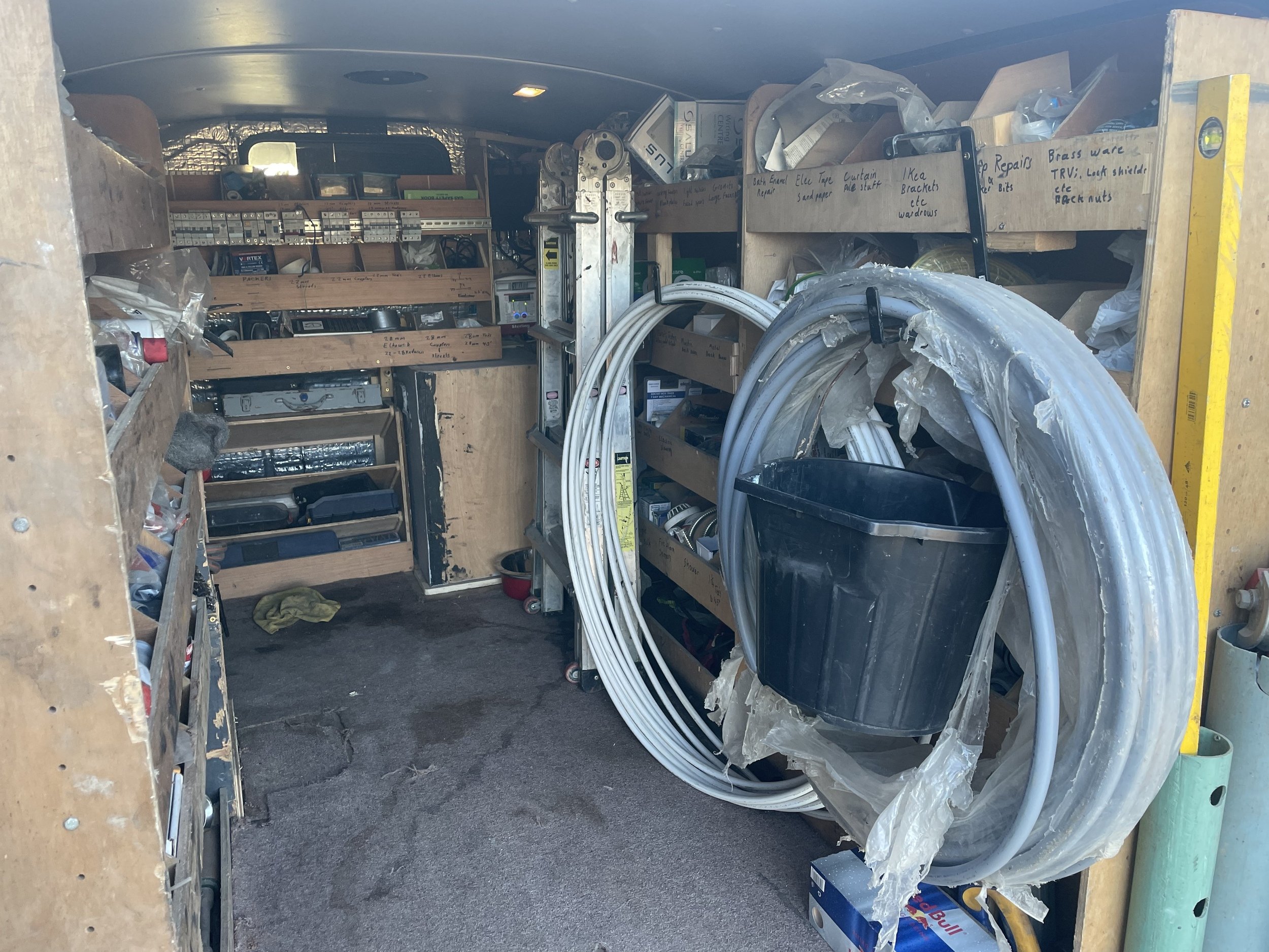

This might help to explain things 🙂
Current enclosure is in the Center just behind the ladder (blank plywood panel)
The port pipe could just be run down and back, along the roof of the van as luckily it doesn’t need to be pretty 😀

That's a fukkin construction connex. That is a nice yellow Stabila level in the pic. That is the best part of the pic.
Na, its the 12 pack of Red Bull :D Man has to have his priorities in life! (y)

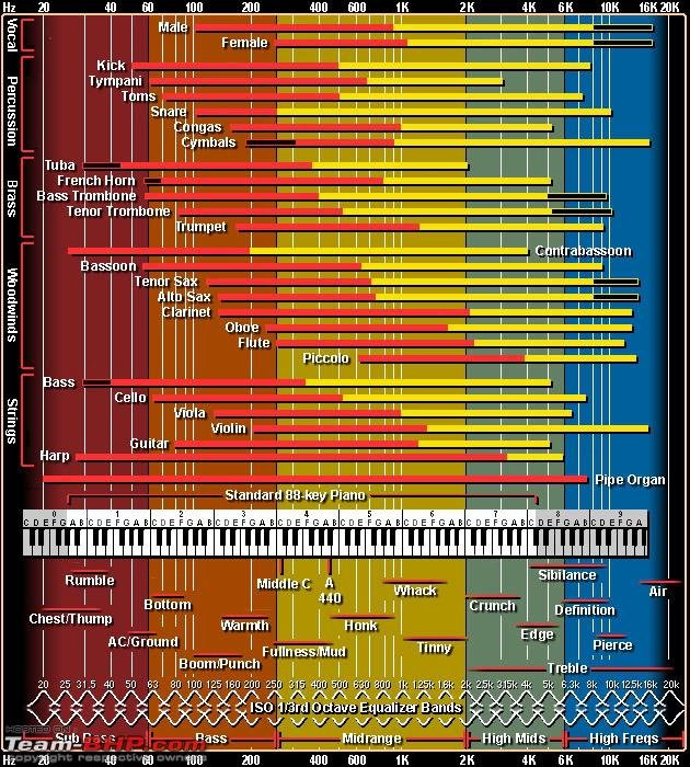

First question is why do you want a 20 hz. tune when most music has a sweet spot around 33 hz.?

you must have done something wrong in winisd.... the fs is about 24hz or so. tuning down to 20 will likely destroy that sub in no time, as well as leave a whole lot of output and efficiency on the table, especially in a space like that. in the picture, is that up against the cab section, front of the cargo area? would "b" box be down there at the far wall lower right of the picture? port placement and orientation largely depends on enclosure placement. in one area, that setup would compound and give some great output in the passenger compartment. in another place, it will make things muddy with cancellation or unloading. another thing is that its hard to give advice when the picture is nowhere near similar to the dimensions you provided and the 13" driver. "b" would have to be at least a meter wider than the space provided, or it would only fit a 6" driver, at best. as it looks in the picture, theres a possibility of the shapes of the chamber to act as porting, or at least individual chambers, possibly something in_between, with near incalculable response. we need a bit more clarification. biggest thing to take away and concider is the fact that tuning below resonant frequency can cause serious unloading issues and make the driver over-extend on very little power, so keep it at 24hz and up.

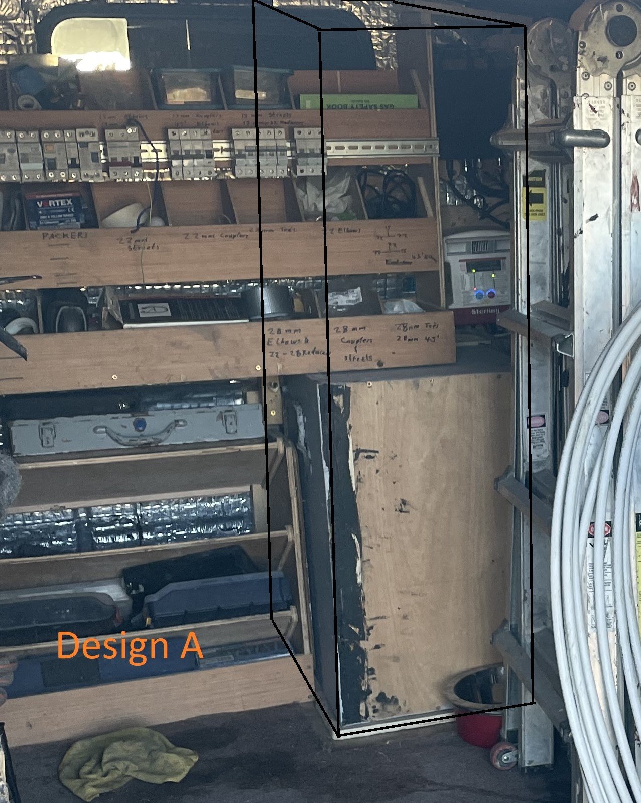

In regards to the rest, well a picture is worth a thousand words so hopefully, this will explain things

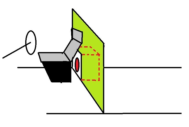

A hole has been cut through the bulkhead with the enclosure in the back of the Van, and the sub firing directly behind/underneath the driver's seat. It's a ready-made infinite baffle setup up, but that would mean changing the sub. I'll do that if needed, but I would prefer to try to make a vent box work first as that's just wood and time, new sub is time and money.

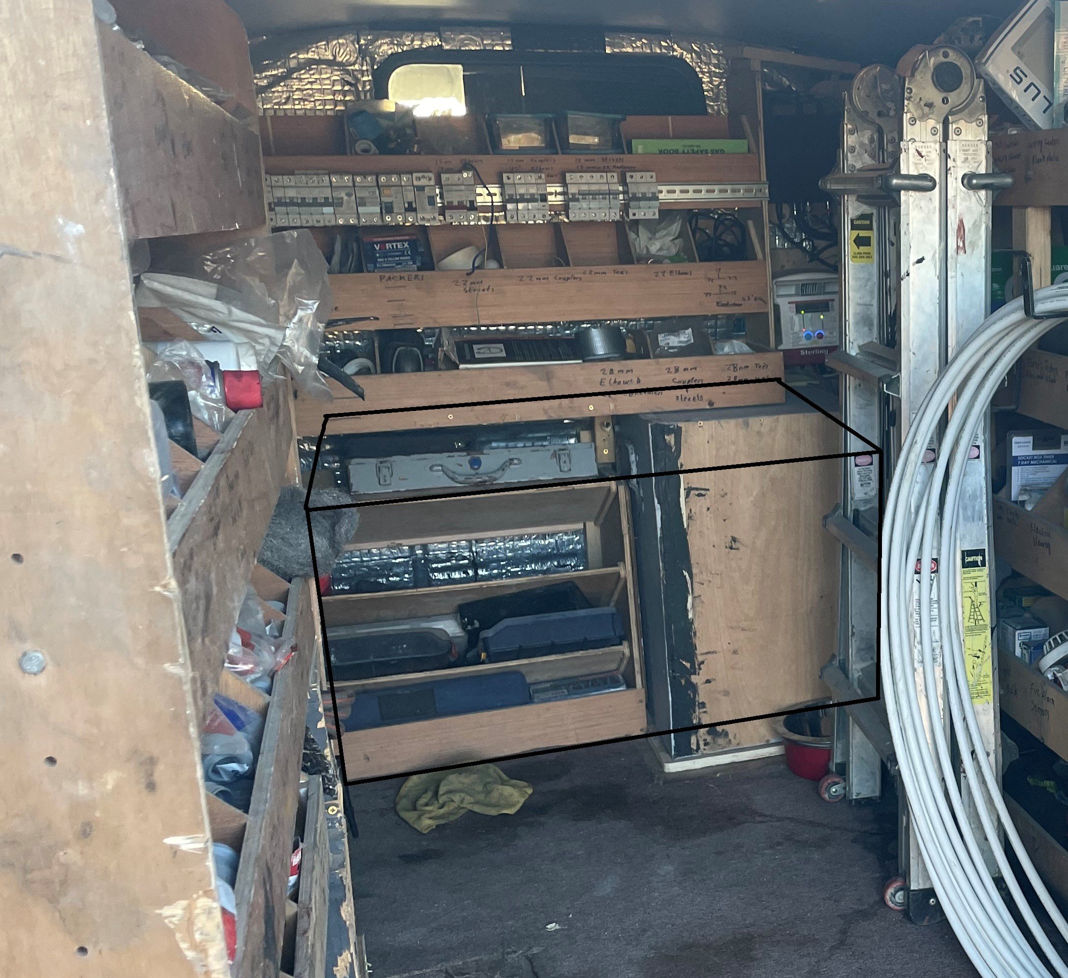

Hopefully design A now make more sense, its huge!!, easest box to make, but a lot of shelving etc to alter.

Design B on the other hand is the opposite way around, the height of the extension to the left is probably to low and would need to come up higher, but hopefully it gives the general thought

Thinking on it I could go for something like this, Design C
Even "most" synthesized **** rarely goes that low and that would be rare to find outside of pipe organ concerts or that slowed crap or test tone tracks.
