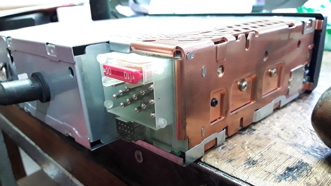

I have removed this Head Unit which incorporates controls for an underseat CD player which I believe is Alpine. I don't have a pic of the underseat module. It takes a 6 CD carrier tray.
I can't go to the car to get model number or more pictures at present I'm afraid but will add some when I can.
I require a new head unit that will operate the underseat CD module and also have bluetooth, DAB radio, a USB drive option, conventional FM/AM radio if possible and a 3.5mm aux in socket. It would be absolutely super if I could just put it into this space and connect it to these leads. It doesn't have to incorporate GPS or be used as a phone microphone and speaker (I have a headset on a separate bluetooth channel for that)

Almost everything you require is available on many radios. Only thing not easily obtainable would be the CD player control. Maybe an Alpine unit will have that but I imagine it will be an older model sans BT.
I think your best bet is to convert your CDs to thumb drive.
As far as adapter harnesses go, you will be fine as long as you use the correct vehicle information. You just splice that harness onto your new radio's harness. After that it is plug & play.
IMPORTANT- Make sure you know if your vehicle has an OEM amplifier. If it does, the harness will likely be one that has a built in Line Output Converter. Pricier than a regular harness.

Yeah this. Copy your CDs to digital and copy to a thumb drive. You will keep the discs in perfect shape, in case you need to recopy them. No fumbling with CDs. You can add thousands of songs on one flash drive for $10-$15. Can control your entire library right there if you want to, and when was the last time you actually wanted to listen to an entire CD all the way through? (Pink Floyd maybe?) You can get front and rear mounted USB (if you wnat to hide it). You can get a single disc head unit if you really want.
If it was me and the cd player is working, I would just try to sell it to someone who hasn't gotten the memo about how much better a USB flash drive is, and have them pay for some of your new head unit.
It can be a PITA to copy everything over if you never have, but it's something you can do with a spare few seconds and in the background. Then only keep what you really want. It's a bit of initial work, but you're going to appreciate it when driving.
Thanks. I suppose along with the original head unit it would be of interest to somebody with an original 2000 car.
Am I likely to be able to get a new head unit that fits that lead set up?
I think what you're asking is the head unit's physical size as in will a new one fit where the old one is mounted. - If so, head units are universally sized and it's called Din. A single Din is 3". A double din is 6". There are 1 1/2 that are some older factory size. Yours is a single Din.
If you're referring to the wires, (because that's an uncommon looking way of wiring), or that's at least not how it's done in the US. You will want to see if you can find an adapter harness to fit into your vehicle's harness. One end plugs into your vehicle, and the other is a universal/generic style plug.
Your new head unit will come with an adapter harness. One end plugs into the head unit, the other is all the loose wires. Those loose wires will need to get pins attached, then plug them in the appropriate adapter harness plug's, pin locations. (Not sure if that clears it up, find the adapter harness for your vehicle, and expect to add pins). If you can't find it, you would just find a universal adapter, cut off your vehicles end, and add pins.
I would expect your antenna cable might need an adapter to make that fit onto the head unit too. You might need to run a new antenna cable from the head unit to the base of the antenna. It kind of looks like that is a 90 degree plug adapter on the end that can just be pulled off.
I would try to use the head unit for bluetooth calling. Only because after it's setup, and get a call, the head unit SHOULD automatically mute the radio, and will give you an easier and safer way to take the call.
