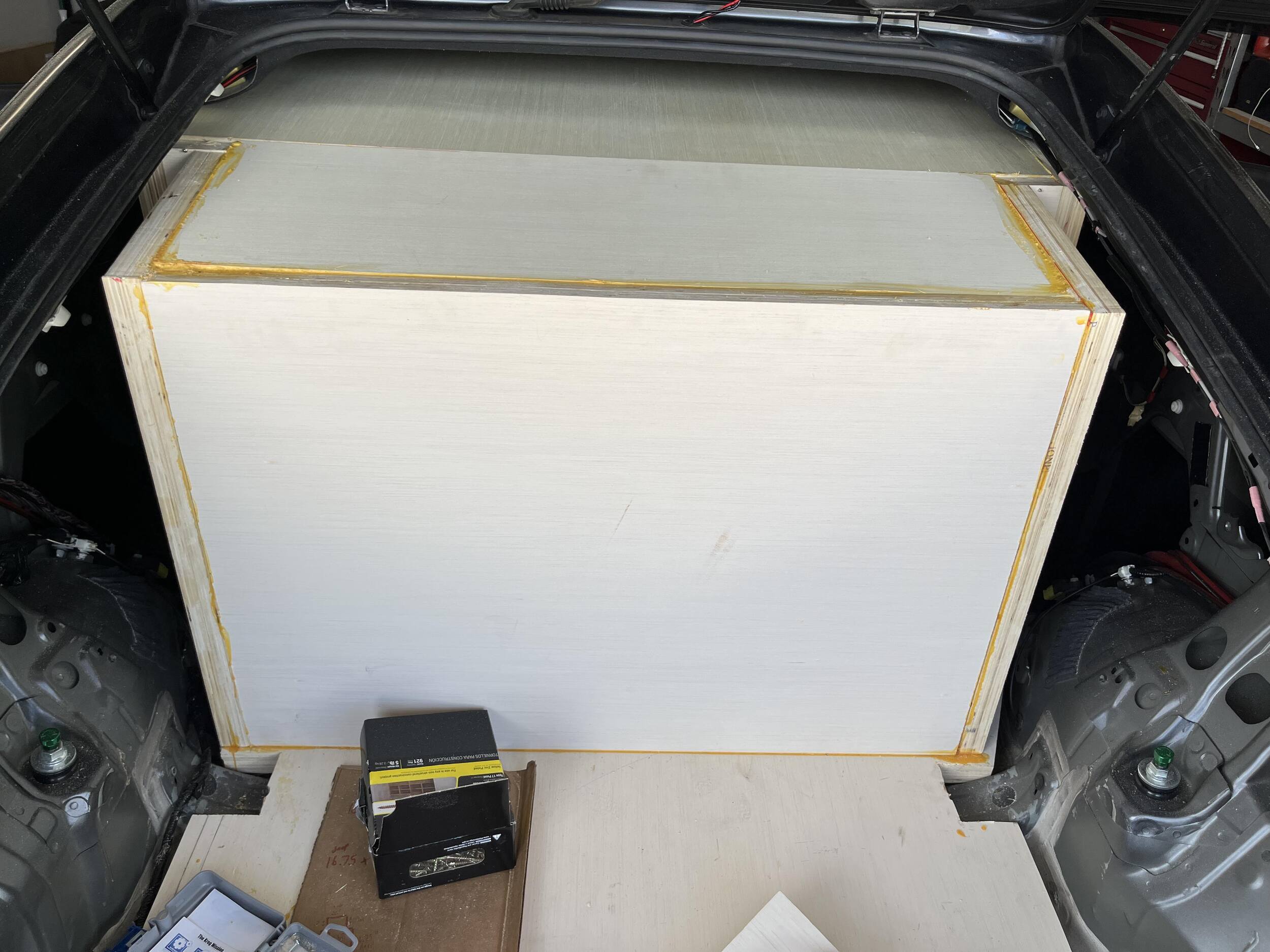

Shell is done.... Just have to do the front baffle tomorrow and figure out the port size and top or center. All the trim pieces to seal up the sides and top can wait until it's cooler outside. :ROFLMAO:

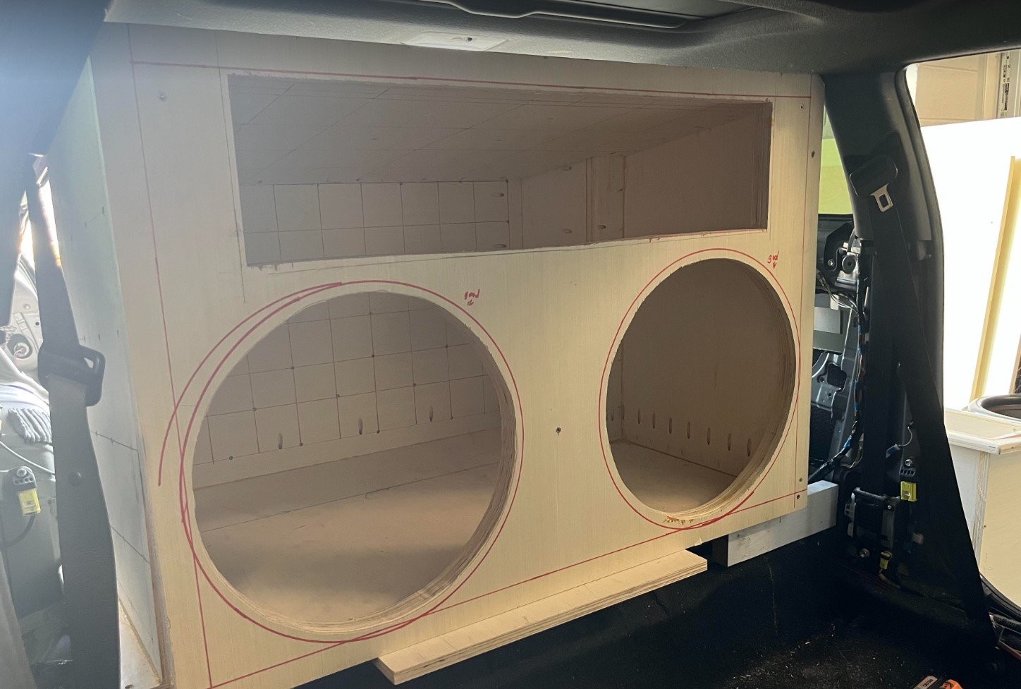

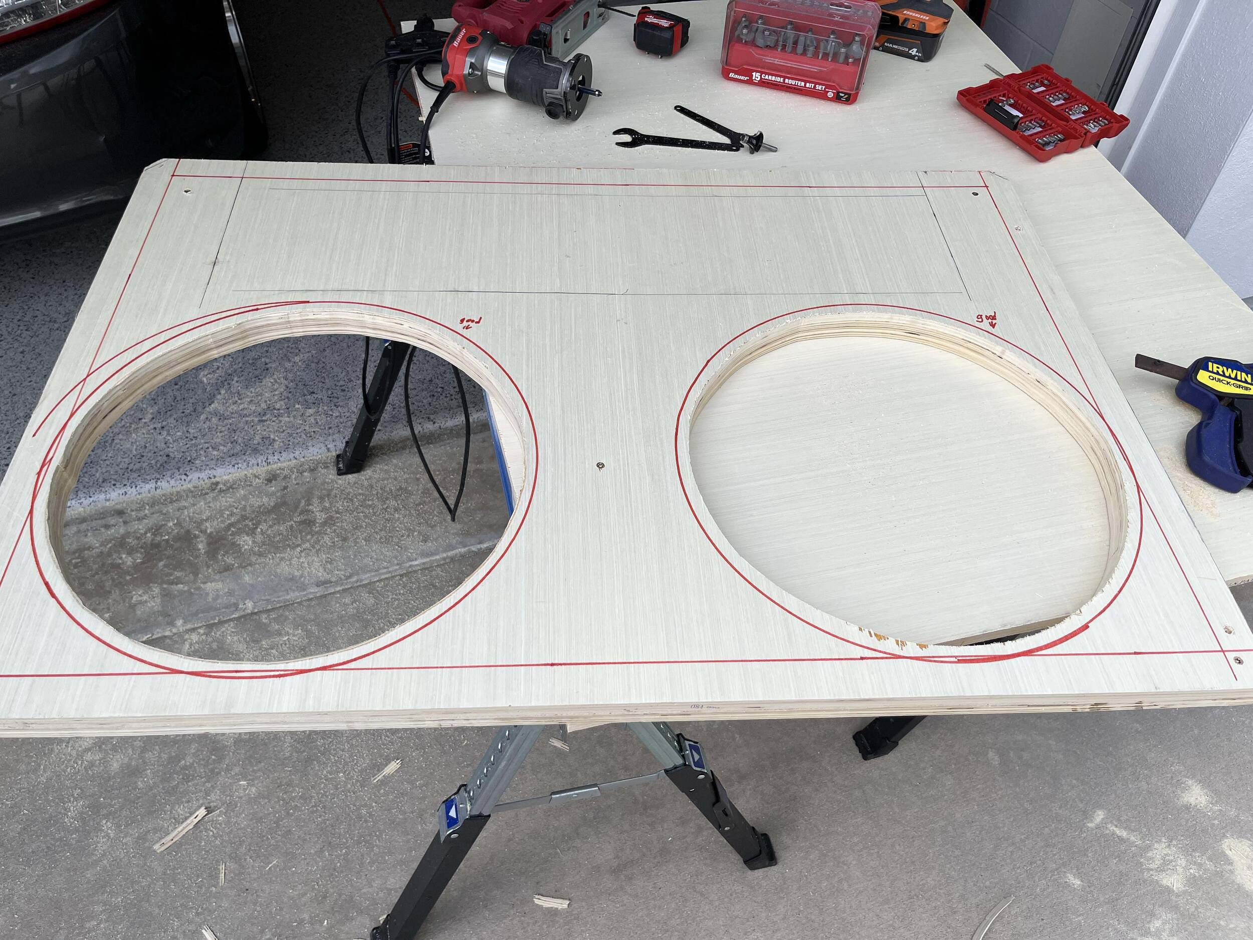

I'm cutting the front baffle now so I can see in person what I am working with. Hopefully I can come up with something. It's either going to be tuned higher than I want or less port area than I should have unfortunately. We will see but I am pretty disappointed right now.:cautious:

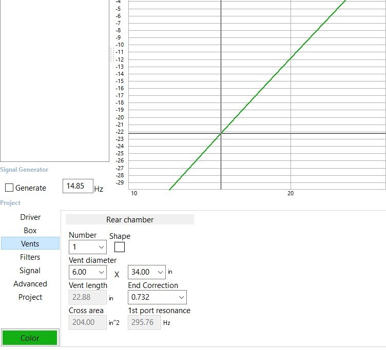

6x34" x 22.8" long tunes to 33hz and 204" of port. Which I can make work. BUT I'm assuming WinISD is meaning INTERNAL size of port. So adding in for wood 3/4" each side and I don't think I can fit it. :rolleyes:

I got it figured out. 6x32 x22 long. On the smaller side of port area at 192"(14" per cube) but tunes me at 33hz.
I was thinking hard on Aeroports but the smallest I could do would have been eight 6" or four 8" aeros.

Baffle is "done" but the port needs more work. I can't get it angled enough to not hit the top of the wall. Might work on it tomorrow but might just put the car back together since I have to go back to work Monday. I can always work on it after I get off work this week. Honestly I'm tired and it's hot as hell outside. Plus it's rained the last few afternoons putting me at a standstill. Oh well.
