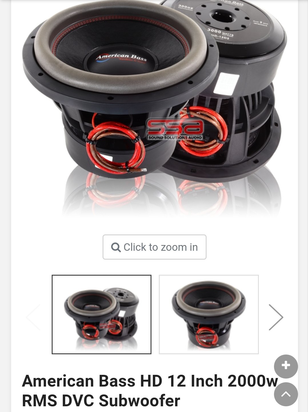

I've got a single AB HD15d2 on a Taramps MD3000 @1 ohm. A couple of these would definitely take that power.

2 hd12’s will bang on that amp. I wouldnt focus on maxing/matching sub rms recommendation to amp rms since real Amp power realized by your electrical will differ from a controlled bench test. Factoring your solid electrical it will be close but also factor that those 4K max HD’s can likely take more. Good value just break em in correctly
