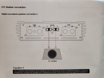

I'm embarrassed to say LOL but I got ****** in by their sale flyers. Two 10" subs for $160, though the amp was more than I wanted to spend.
Skar SKv2-1500.1D amp
SDR-10 (2) dual 4 ohm voice coils
Sealed box, 2 chambers each near the 0.8 cu. ft. chamber volume.

Ah, someone said "The amp is designed to operate down to 1 ohm but amps are most efficient and have more effective damping (woofer cone control) at 4 ohms.". You don't agree?
Dampening isn't the end all...a decent amp will still control a sub just fine at 1 ohm...unless you're going for an emma type sq build...
At 4 ohm most amps are more efficient but you also pay more for power...my amp for example is about 90% efficient at 4ohm and around 80% efficient at 1 ohm...the price tag for an amp that does 3k at ohm will be quite a bit more money than one that does 3k at 1 ohm...so it's a tradeoff...
