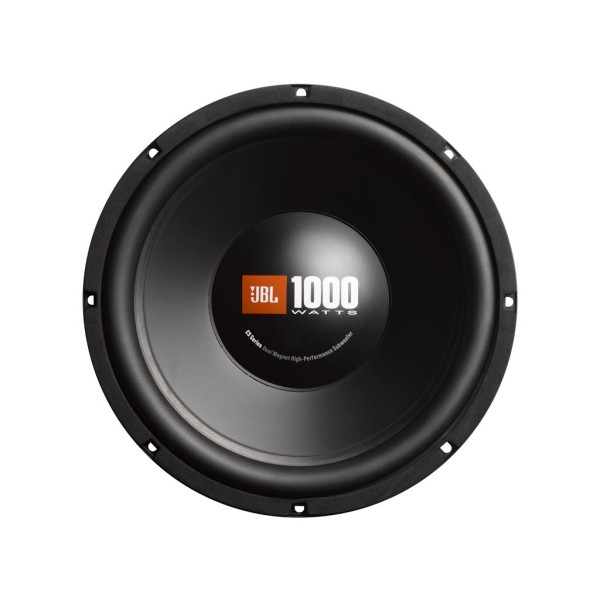

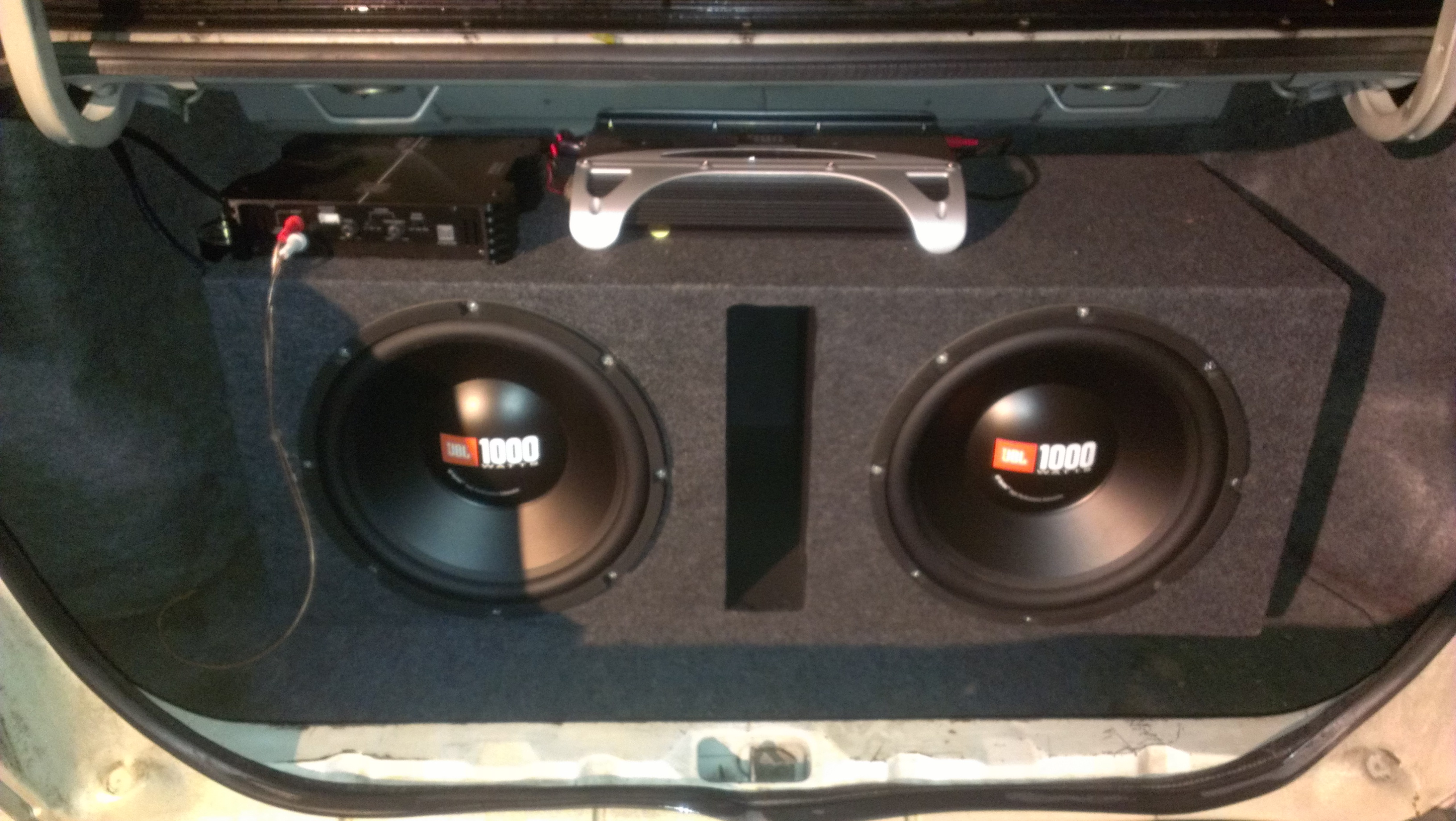

I knew a guy with a JBL 1000 watt 12" and it was properly loud and punchy. Old design now...
27197
Never owned JBL, but I would definitely have a go with a few of these for fun.
