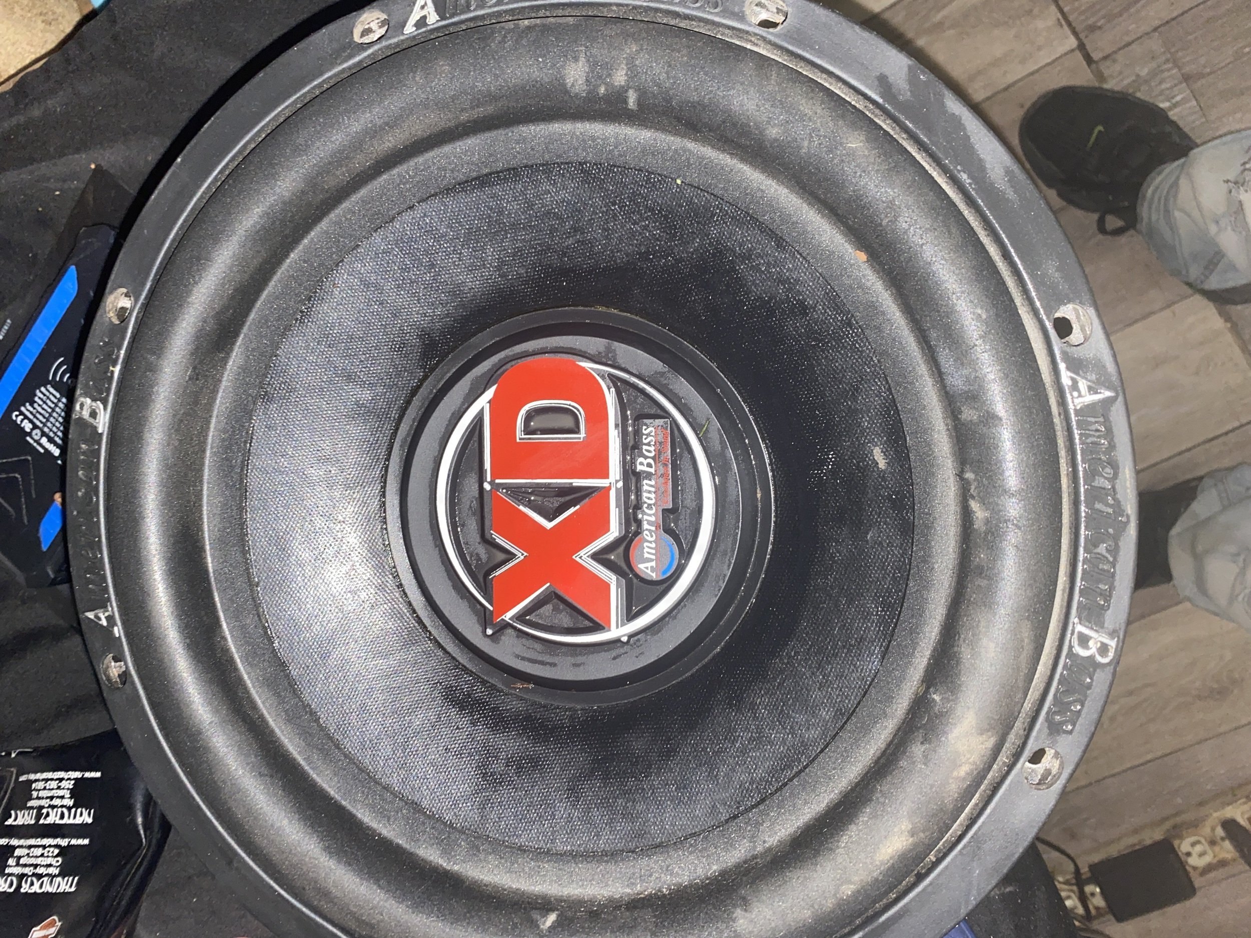

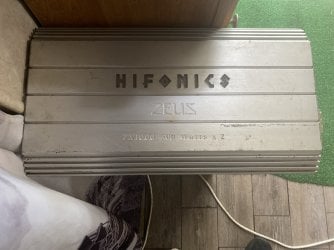

I have a hifonics Zeus zx1000. 500 x2
And it was a gift along with my 12” American bass xd and want to sell them both is there any way you could give me a price range to ask for them both
