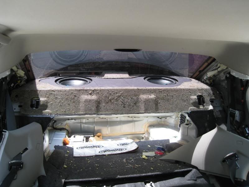

Infinite Baffle Started Suggestions needed!
you gonna glass around that baffle? or maybe i missed it, but it looks like you used foam to bridge the gap?
if i missed something let me know, but if there is just foam in that gap, your going to have a problem.

that foam turns hard as a rock. there will be no problem using it to seal off the area between the baffle and the rear deck as there will be almost zero pressurization of the trunk area.
the huge bolts holding the baffle down will suffice as far as mechanical fasteners are concerned.
looks good. not just cover up that huge ugly hole in the carpet and you will be golden.
I got a suggestion that seems like a good one... Use some metal grille material (similar to chicken wire, but lil more pliable, and form it to the center to remove that ugly hole. Then just cover the entire piece as one, with this fake suede I have (looks good and easy to mess with).

Here is how I got the center back into the rear deck cover. I used some mesh grille I had left over.
NOW... Looks like if I want to I could actually do whatever I want. I guess if I want to cover this piece, I should use some thin foam like they use for headliner before I cover it right?
OR
I could cut sub circles, or squares out and leave them exposed. What do u guys think?
