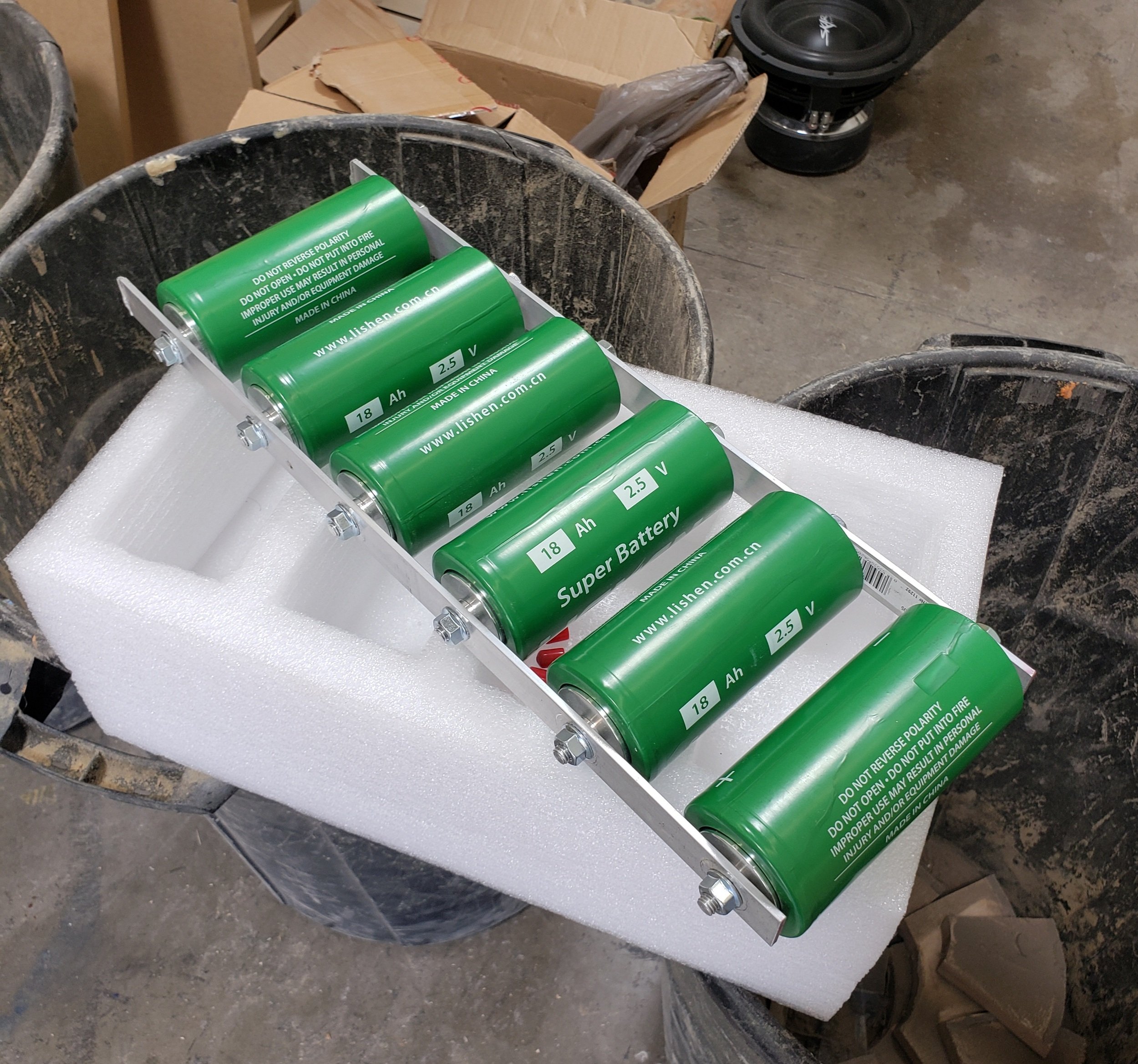

You need to balance them before assembly of the bank. Some cells were at .2 volts and others were at 2.6 volts when we opened the box and checked them. After we balanced them and assembled them the bank was reading this before any kind of charging was done.

When you say 5S or 6S, does that mean a 5 cell bank or 6 cell bank?
Shorthand when we discuss lithium cell banks. S = Series, P = Parallel.
The Lishen cells are rated at 15C/50C. 15C being the maximum recommended continuous pull (270A), and 50C being the absolute maximum rated draw (900A).

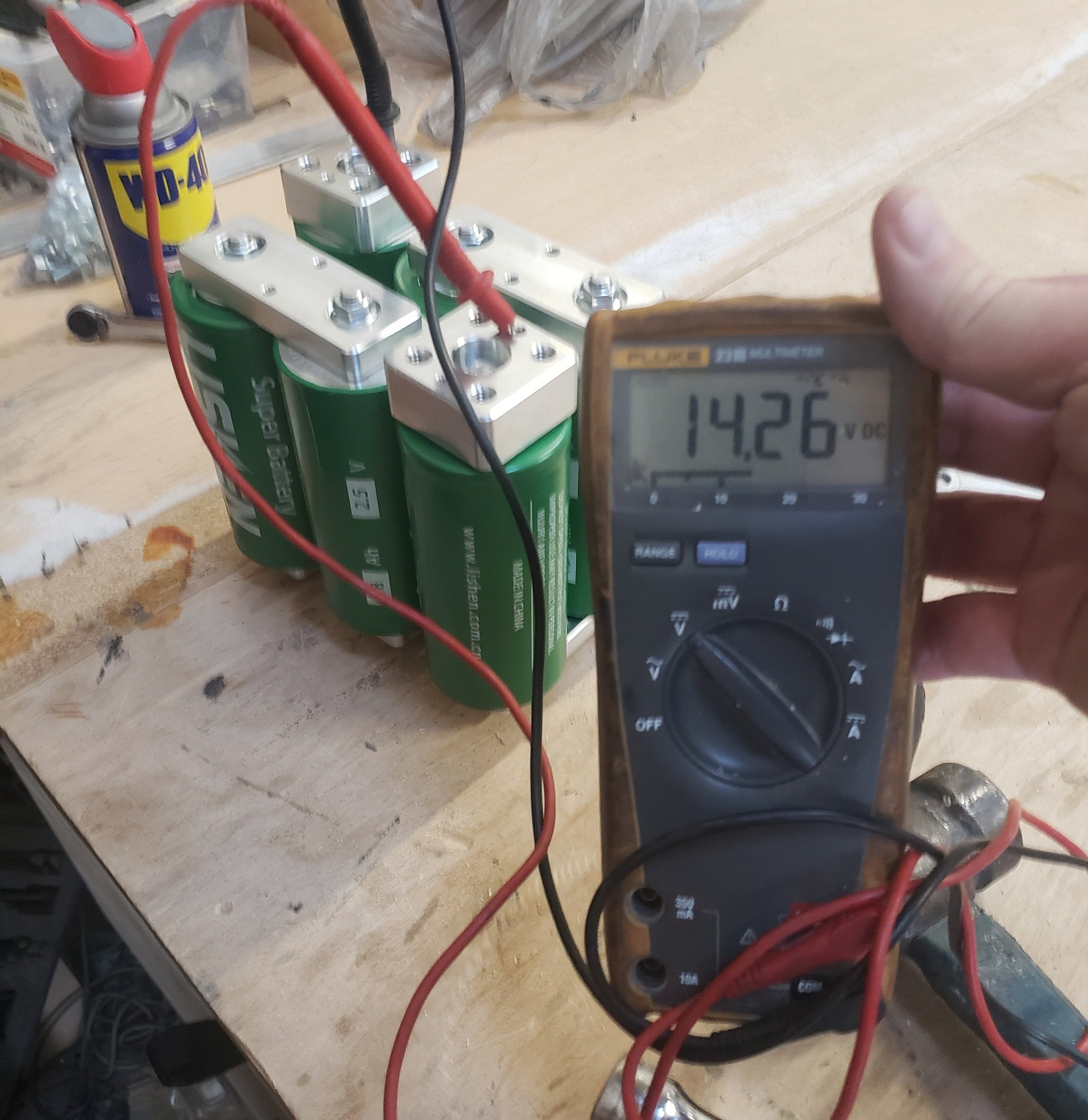

14.6 is max charge for headway. 3.65 volts per cell. There should not be any voltage drop from your alternator wiring to battery so 14.8 is too high.
