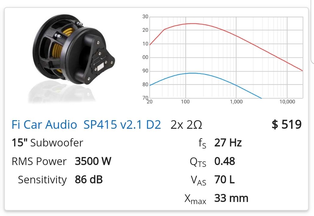

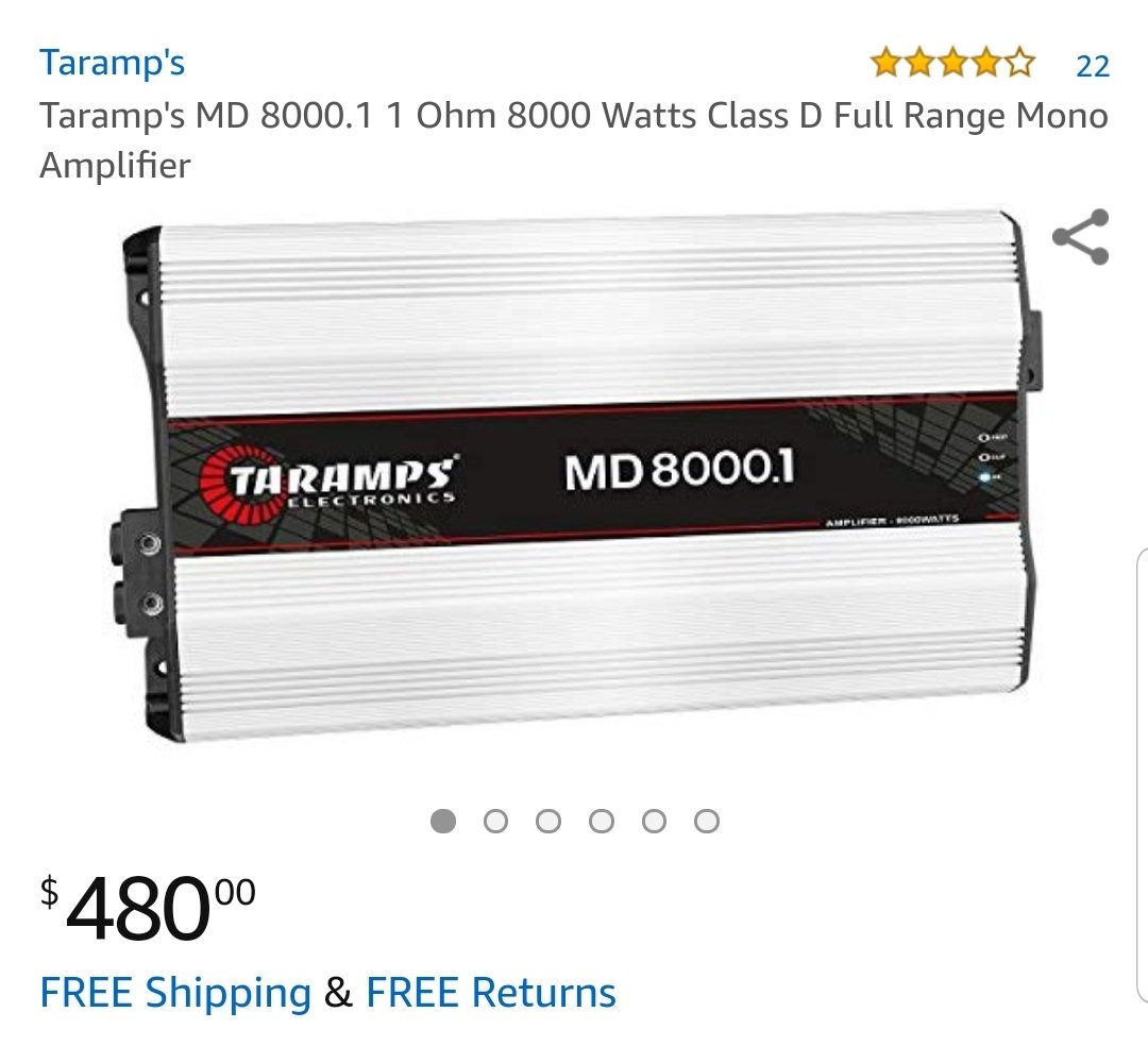

FI SPV4 15" dual 2 ohm and a Taramps MD8000.1 one ohm version. Ported box 4 cubes net tuned 32-34hz. Sub rear and port side. Should cost you around $1,250

You forgot the cost in electrical upgrades to support an 8k. +$1000 more.
I assumed he had that done since he only wanted sub+amp recommendations. He better go 2-XFL 1244's and a md5k one ohm version. 4 cubes net tuned to 32hz. Sub rear and port rear. Upgrade the electrical and buy 1/0 gauge wiring for the install with the remaining funds. Amp might be too big.
