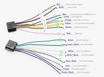

Thank you all.for the advice. It seems this install might be more challenging than the RCAs. The HU I just received is a 2din with back up camera. It has one set of left and right outs of RCA. The others are for AV and camera, which are V1 and V2 out, CVBSIN, and CAMIN. I'll figure all that out later, for now I'm just trying to research some.of these pigtail wires. Since my phone's camera won't capture a decent enough photo of the diagram I'll try my best to type what it say. I'm having trouble figuring out a few wires. The green, pink, brown and orange. Maybe some of you have come across a Chinese "piece of work" like this before.
Pink - Parking Sensor Control Wires +12v
Orange - Parking Single Check
Brown - Key
Green - Head Lamp
The rest are familiar Wires I should have no problem with. But I'll list them so you know that they're covered, possibly help with process of elimination.
Blue - Power antenna
Yellow - B+
Red - ACC
Black - GND
I'm guessing that these wires (pink, green, orange, brown) have something to do with the back up camera, and some have to do with a steering wheel control which I don't have. I guess what I need help with is finding out which would be:
1 - which should be ground for DVD to work, so kids can watch while I drive. I read somewhere that there's a wire for the backup camera ground that affects the screen play if not using emergency brake, and that I can simply bypass that by hooking it to a constant ground. My guess is the pink, but the diagram shows it with a +12v.
2 - The orange wire, says Parking Single Check. I'm confused to what that means.
3 - The green wire, it says Head Lamp. Is that the chinese translation for dimmer? I've never had.to hook a radio into head lamps before.
4 - The brown wire, it says Key. I read somewhere that this is for steering controls, which I don't have. So this might not be used. But I have to ask because the metra adapter harness to hook up to the factory wiring of the vehicle has a brown wire, but I believe it's labeled Mute and not used.
Ok I think for now I will wire in the basics. I've got plenty to do with the speakers and amp for now. This other stuff can wait until I get a better understanding of what's what. Since there is only one set of RCAs I'm going to run those to the sub amp, and use the speaker wires to the 4 channel amp then out to door speakers.
The radio I think is made by AMPrime and the model is 7010B if that helps at all. I'll post the pic I took of the diagram in book, but it's horrible. I did however find a pic online of one very close to what I have. I'll post that too since it may be of some help.20171124161756_25069.jpg

Hey dog. I can make some estiimated guesses but it already seems like you are on the right track. I found a youtube channel that is reviewing your emprime 7010b. I know you said amprime but the emprime worked. Hope you already have it installed by now but here's a copy of the URL
Thank you for the link to the video. Hopefully it'll help anyone else who might have been in that situation. I had major issues with the unit once it was all wired in. I think it was used as a basketball during shipping. The screen flickered, and the speakers cut in and out kind of like static but only when bumped or shaken. So in the end it was returned for a US made unit. It works and sounds great now. The newer unit actually has the pink and orange wires labeled unlike the Chinese one.
