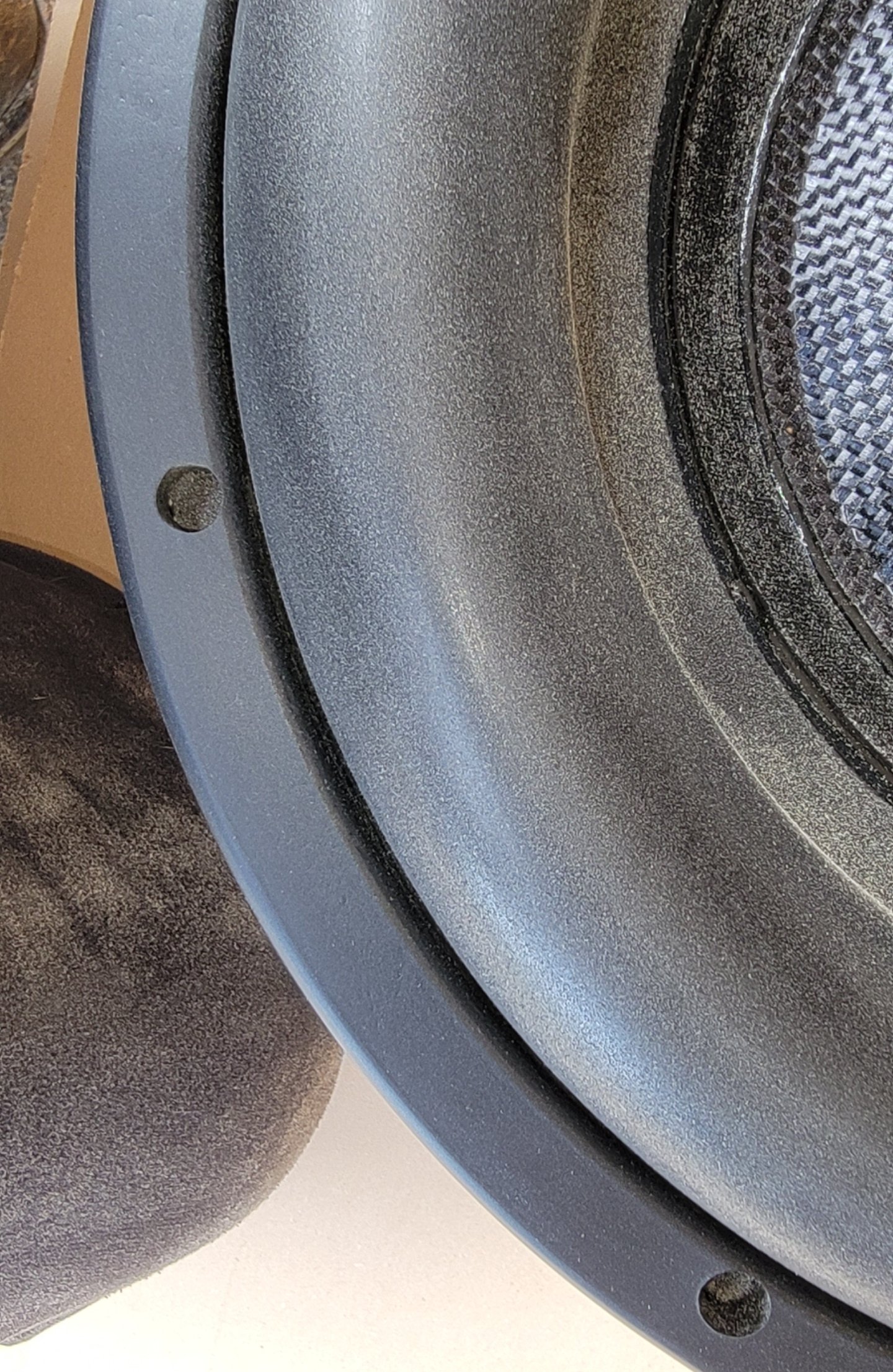

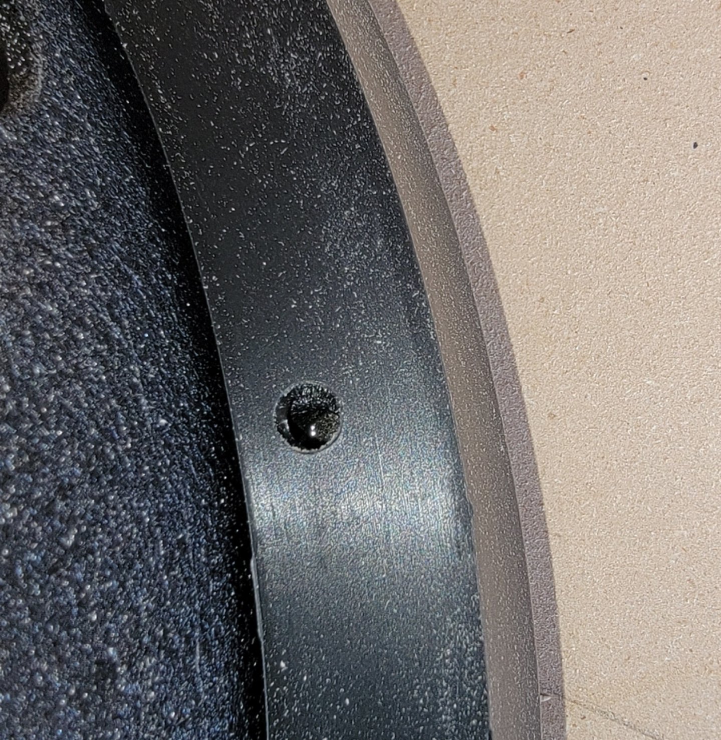

I did take some pictures, if anyone's curious
I don't know if you guys can even see it in these pictures though lol

That's a good idea. The soldering iron would probably put less stress on it than using a drill bit. I have one, so that's poetically what I'll do when the time comes
