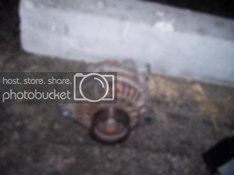

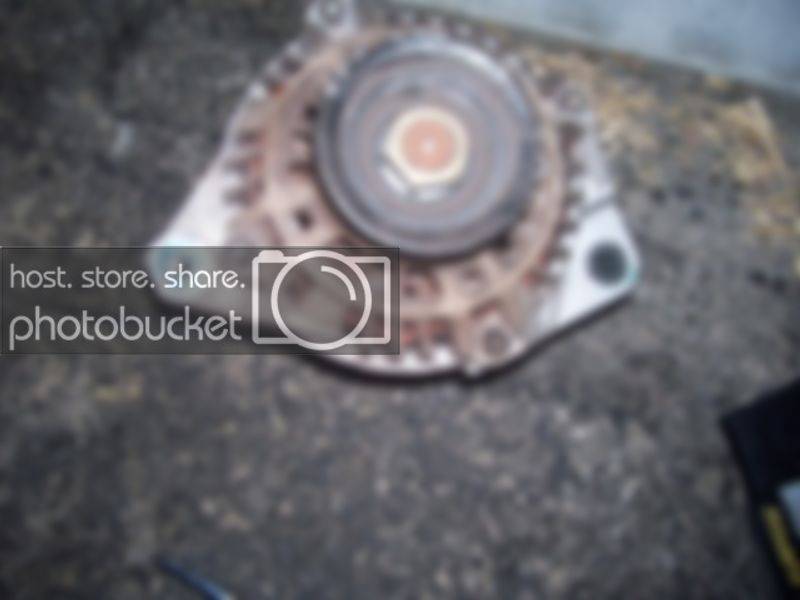

alright so today i took the alt over to R&R to get the alt tested. when i get there a guy is like, you're going to have to come back in like an hour so we can test it cause the alt guy isn't here. so an hour later i return. the guy looks at the amp. i explain my situation. then he's like, i'm not going to test this for you. we can't test it we don't have the plug for it. i ain't going to test it. and walks off.
i'm like. //content.invisioncic.com/y282845/emoticons/confused.gif.e820e0216602db4765798ac39d28caa9.gif then said **** you *****es.. in my head. lol

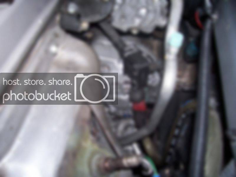

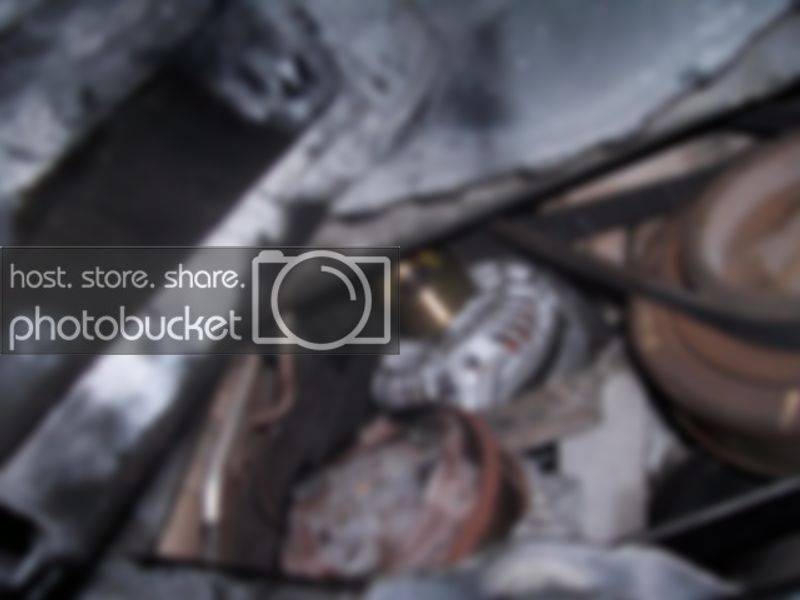

so apparently no one in key west can test the alt for me.. great.. so i had to take the risk and just mount the alt. well i looked up a how to. followed insturctions while replacing all my belts and 3.5hrs later. it's in and running.

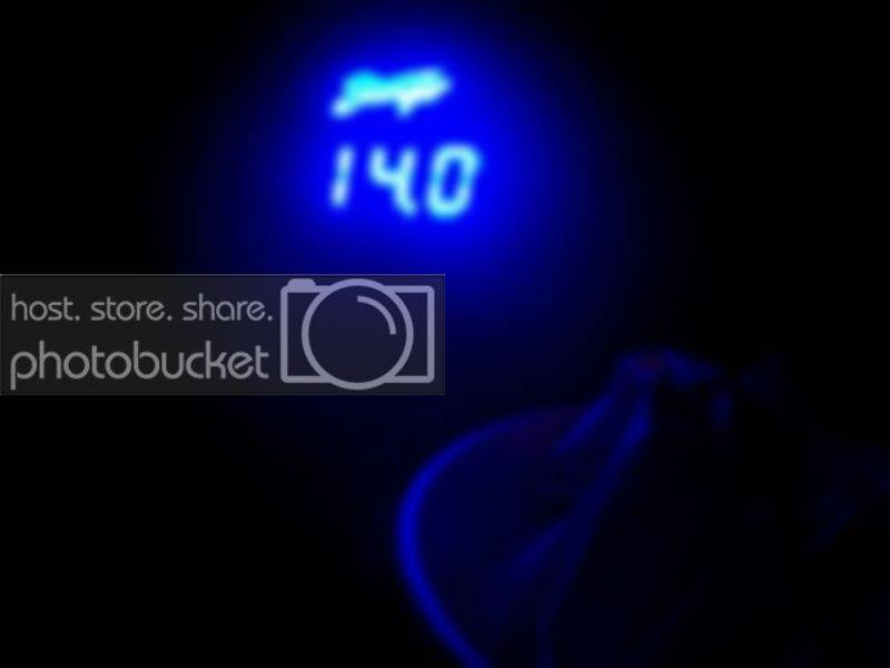

no sparks no clicking nothing. seems to be working smoothly. though my meter on the car read it's max voltage at 14.1 for startup/warm up
as the car reached it's warm up level and it started to idle like normal the voltage hovered around 14.0v i haven't taken the car out for a drive but so far it's charging at least. as fow how many amps it's producing i can't tell. i don't have a clamp meter so :/
tomorrow morning on my way to work and such i will keep my eye on my meter to see how the voltage is cooperating. hopefully the alt will last me.

Also gj on the alt... And u have the meter maxed out and its only reading 14 on cold?
meters not maxed out. on stock alt in the morning and such it's gone up to 14.4
though that's when i have 2 batteries on the car.
right now i only have the batt in the engine bay which is a 3yr old half dead battery. lol barely enough cranking amps to start my car.
well when the car was turned on and testing i never put my foot on the gas. i was just watching the idle rate and how it reacted when my headlights were turned on along with the a/c and every other unit in the car that draws current. lowest the voltage dropped was 12.4 but thwas was with all the lights on and max a/c. still on the weak battery.
tomorrow i will see how it works with the ride to work. thursday i receive my new 2 channel amp to replace the gimp 4chan amp. after the 2 chan is back in i'll be putting the kinetik back in the trunk. though i feel i won't get acurate results as the kinetiks been sitting on a trickle charger for 3 days. the battery itself will probrably maintain the cars voltage pretty high even w/o the help of the alt.
do you guys know if when they test alts that are mounted on the car they use clamp meters or alike to see how much current it's producing?
