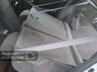

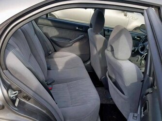

The back seats fold down, one is the size of a passenger seat, the other is passenger seat plus the middle seat ( The parts that fold down ).  I maybe have passengers in the back seat twice a year if that.  I will try to attach some pics of the interior below.  Wanted to post some pics of mine but it is pouring out at the moment so...
Now I would prefer sealed as it doesn't require as much space, don't have to worry about a port, so can make some crazy shapes if needed and I do enjoy the tighter accurate sounding tones.  But!  Let me hear all of your opinions and ideas, even if they sound crazy!  It may lead to giving me another idea lol!!  I really want to do something different and unique with this if I can.

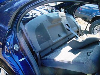

I couldn't find a great rear deck pick, but the 01-05 models I believe are all the same.

Ideally would like to keep it to one sub if possible that can handle a large amount of power and sound clean.  I am going to be running 3 way active in the front ( around 1k-1400 watts rms for the 3 way set up ) so I want the sub to be able to keep up with it.  I listen to everything from rock, thrash, metal, classical, hip hop, rap, r&b, etc so I am all over the place in music, just no country music really.  So far in my mind the center console ( gear shift back to armrest and space in between armrest and back seat ), with it possibly stretching into the back seat ( middle seat in back ) as an armrest is winning in my head, the cushion thing I think would be very interesting indeed  ( think it would look nice as well, as long as I can match the cars interior properly ).  Took a good look at the rear deck today, and man that will be a pain in the ass to pull out and remake, especially with the seat belt supports etc in the rear deck itself.
