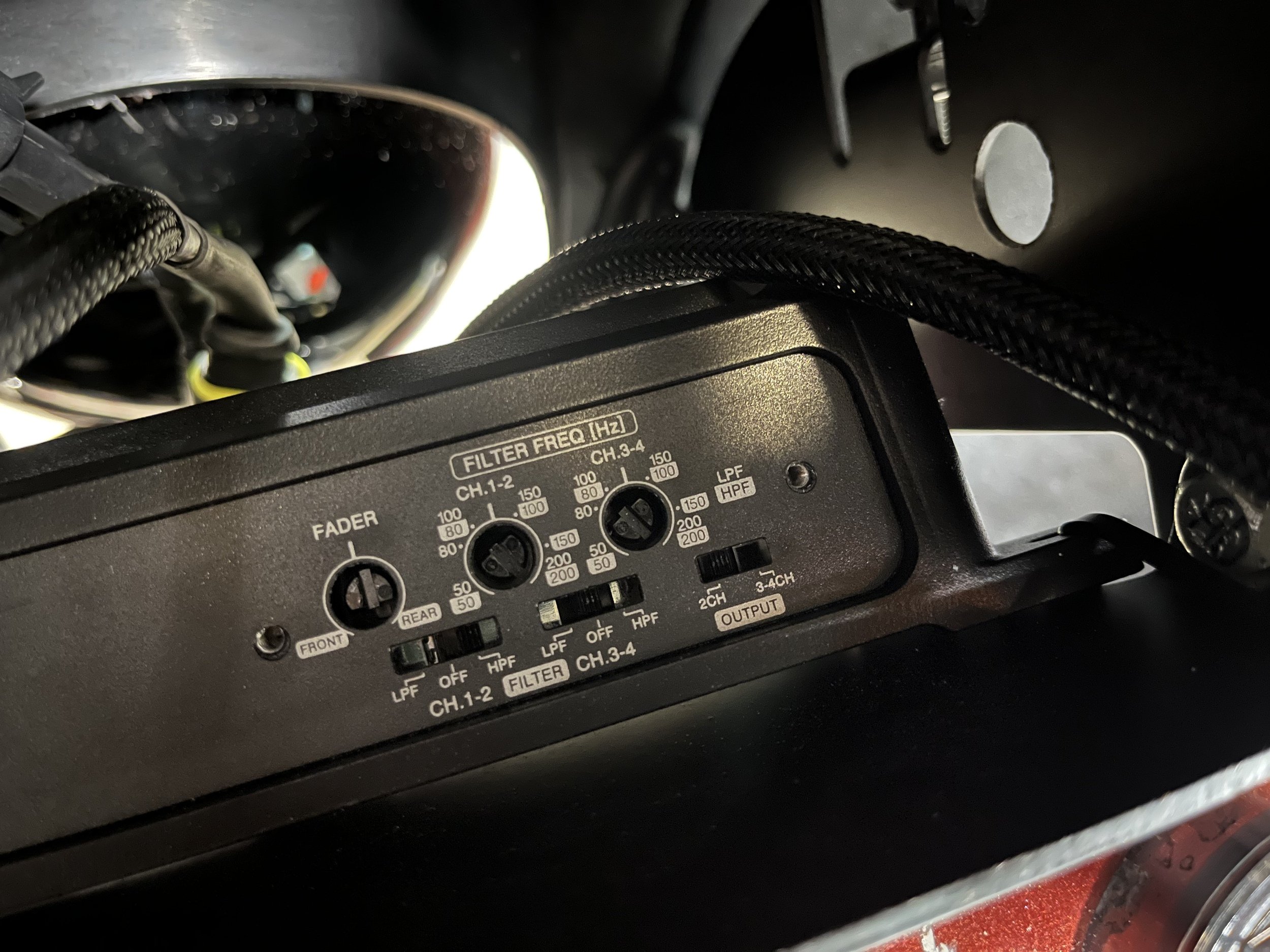

View attachment 41975So I’m on channel 1-2 where should the knob point? Over the 150-100 or 100-80? Filter LF, off, or HF?
Hpf and somewhere in the 100-150 range. You might can go down to 80hz but again 4inch speakers are not designed to produce bass.
You also so ensure that the signal into the amp is clean and distortion free and that the amp is outputting clean distortion free power.
Setting the gain correctly is the single most important part of setting up an amp
