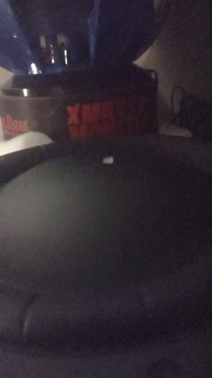

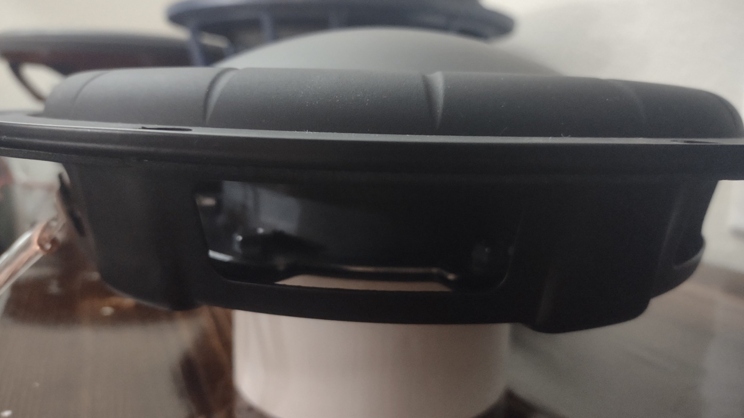

I haven't heard that many shallow subs in my life by by far my favorite is these it's sitting on a role of white duct tape FYI. And only 2.9" can you guess what brand they are?
