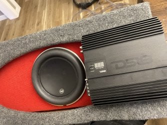

I’ve almost got everything I need to get my system installed in this 2008 Cadillac CTS with factory Bose and Nav.

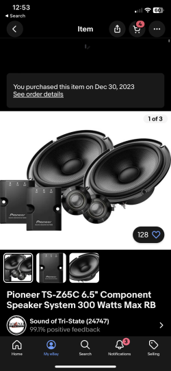

Installing JL 10W7 high output box, DS18 H-02 Hooligan amp, DS18 high/low converter, and 2 sets of Pioneer TS-Z65C 6.5" Component Speakers w/ tweeters.

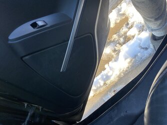

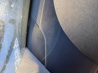

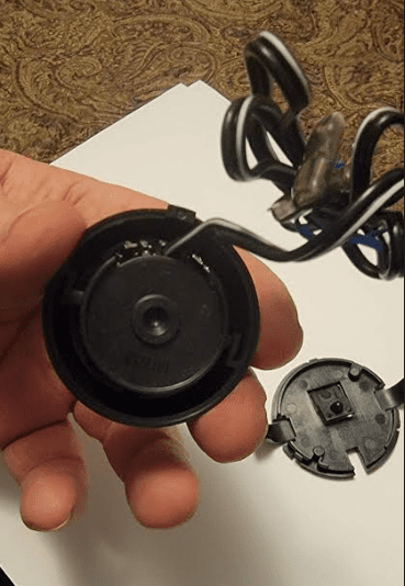

Thank you! So do the tweeters replace these corner speakers in my dash?

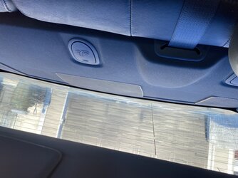

And what would you recommend for the speakers behind the rear seats shown in the second picture?
The covers for my pioneer speakers for the door are a different shape than the factory ones..wondering what you would do there? And the rear door speakers are smaller: hoping the 6.5” will still fit.

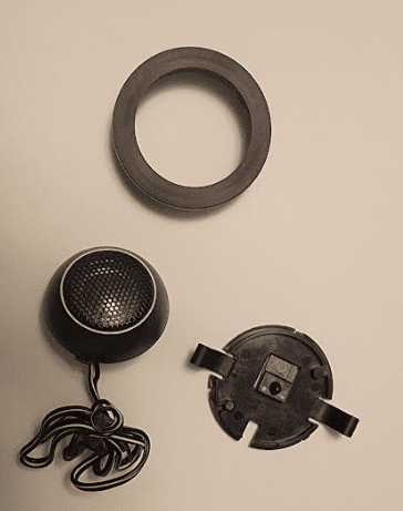

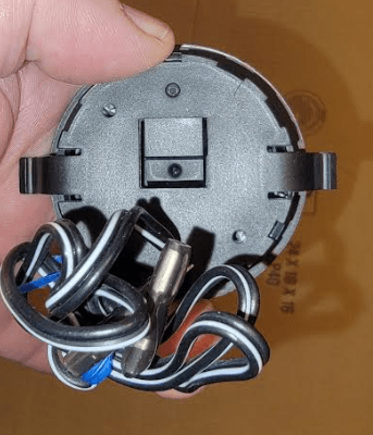

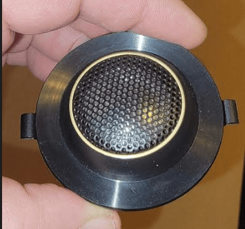

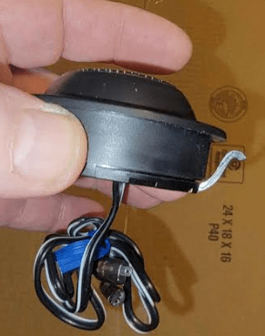

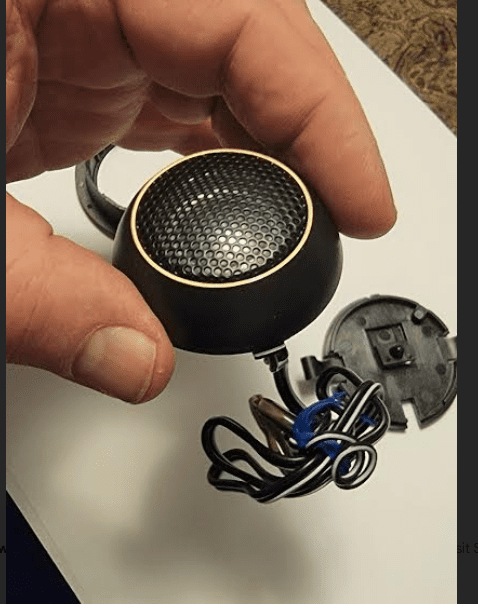

If you don't want to use tweeter pods or surface mount them in the upper door or piller if able, then you remove that cover and use the tweeter adapters to mount them in the dash. I would select mounting the tweeters last, once you have the gear in and can test location with the tweeters velcroed on the upper doors, a pillars or setting on the dash corners, once established then get what you need to install them relative to the location. I would defintaley recomend getting trim installtion tools, their inexpensive and very helpful!
Trim Removal Tool, 120Pcs Car Panel Door Audio Removal Tool Kit, Auto Clip Pliers Fastener Remover Pry Tool Set wit​
Doesn't have to be the 120 tool set, some of the basic ones have all you need so just look and get what has good consistent feedback ratings.
I would disconnect the center dash speaker altogether, no need for it.

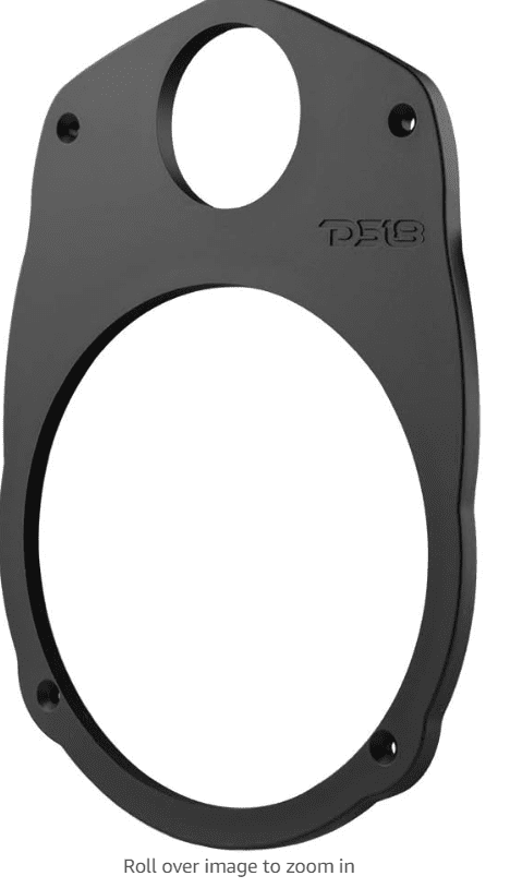

As for ther rears, you h ave a coupl of options. You could do something like this in the doores
You could surface mount the tweeters slightly above the 6.5's on the door, b est to keep them as close as can be. You could also just use the 6.5 without the tweeters, strictly for rear fill between 150 and 3000 hz with the amp (provided the amp you get has a bandpass option for at least one of the chancels) as the crossover. This improves the overall listening experience in the front as it improves the staging but leaves a little to be desired in the rear, depends on is riding along and how often that is going to make a difference to you.
Those tweeters come with the option tot flush mount or surface mount.
