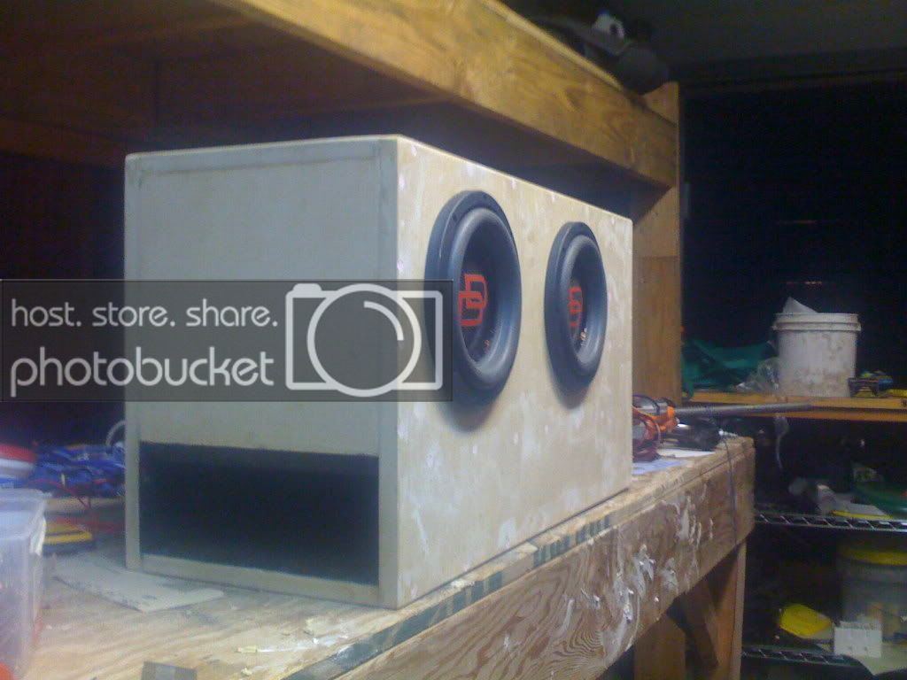

the rex took first and loudest of the day....so not bad... on two 10's I did a 150.6 on 4 I did a 152.8 ...I think at the next show I'm gonna try what Tommy recommended and redo the face board to a single 1" the 2.25" may of hurt me ...on this setup....

why does having that thick baffle drop DBs?
Airflow.
With a motor that big on such a tiny sub, airflow from the rear of the cone is limited already.
That thick ass baffle really chokes the rear of the sub, potentially causing a loss of SPL.
I have heard of some guys gaining upwards of .5 by rounding off the inside lip of the sub cutout, especially if the baffle is double thick or more.

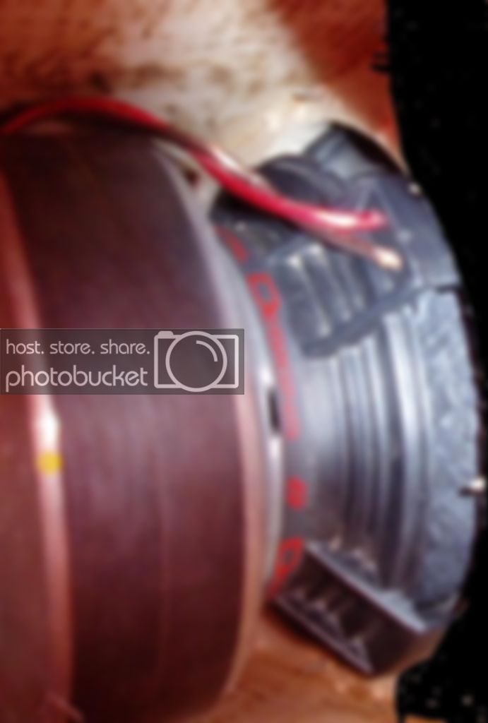

I can take a pic to show you what I mean. //content.invisioncic.com/y282845/emoticons/smile.gif.1ebc41e1811405b213edfc4622c41e27.gif
Here's a pic to show what I mean. This is inside my single 10" box (edited to protect some deeebeeeez secrets //content.invisioncic.com/y282845/emoticons/wink.gif.608e3ea05f1a9f98611af0861652f8fb.gif)
Notice how close the basket is to the baffle? And that's a single baffle. Imagine what dave's box looks like with a triple baffle! //content.invisioncic.com/y282845/emoticons/eek.gif.771b7a90cf45cabdc554ff1121c21c4a.gif
On 10's the basket is so small and airflow is already limited.
