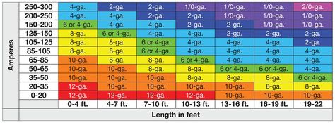

There are a lot of AWG wire size charts, and they vary slightly. here is the one off crutchfield.
If you have 2 amps, one is fused at 40 amps, and one fused at 120 amps, then
For the 40 amp, amplifier, wire it with either 10 or 8awg (8 because that is probably what you will find), and fuse that wire at 50 amps.
For the 120 amp, amplifier, a short run could be 8awg, but I would 100% go 4awg. Then I would fuse that wire 125-150amps. (You can always go bigger with wire, it just costs cents more per foot, and is a little bigger physically to run it). The wiring can be as oversized as you want, but the fuses need to be sized for what they are doing. They need to be less than what the wire is capable of, but more than what you need downstream.
The main wire would then need to handle at least 160 amps. I would do 1/0, and fuse it for 200amps at the battery. The fuses at the battery and the distribution block are for the wire. As close to the battery as possible, and on the terminal is best. If that wire burns through you have some length between the terminal and fuse that could be a large, exposed power wire that could burn your vehicle to the ground.

The bigger the gauge number, the smaller the wire. 8awg would be smaller than 7awg. Yeah, go with 4awg. 7awg sounds like it must be for an amp that's main market is outside of the U.S. I wouldn't even spend two minutes trying to find 7awg.
8awg would be fine if its a short run, but in the bigger picture of it. If 4awg works for your total amperage and length, you can run 4awg off the battery, then split it and run 4awg to each amp, as long as it is still big enough for the total amperage. What you need to know is what size connections all the equipment is designed for; the connectors on the amp, and the connectors on your distribution BLOCKS (fused one for power, non fused one for ground). You also then only need to buy one long wire, and you cut off what you need, instead of buying extra and wasting a little, (the cost of the larger wire kind of evens itself out if you can keep a usable length, as opposed to having a foot or two extra that's not good for anything).
Figure out what size connections your amp can take, then find your distribution blocks that work with that size, then buy your wire.
