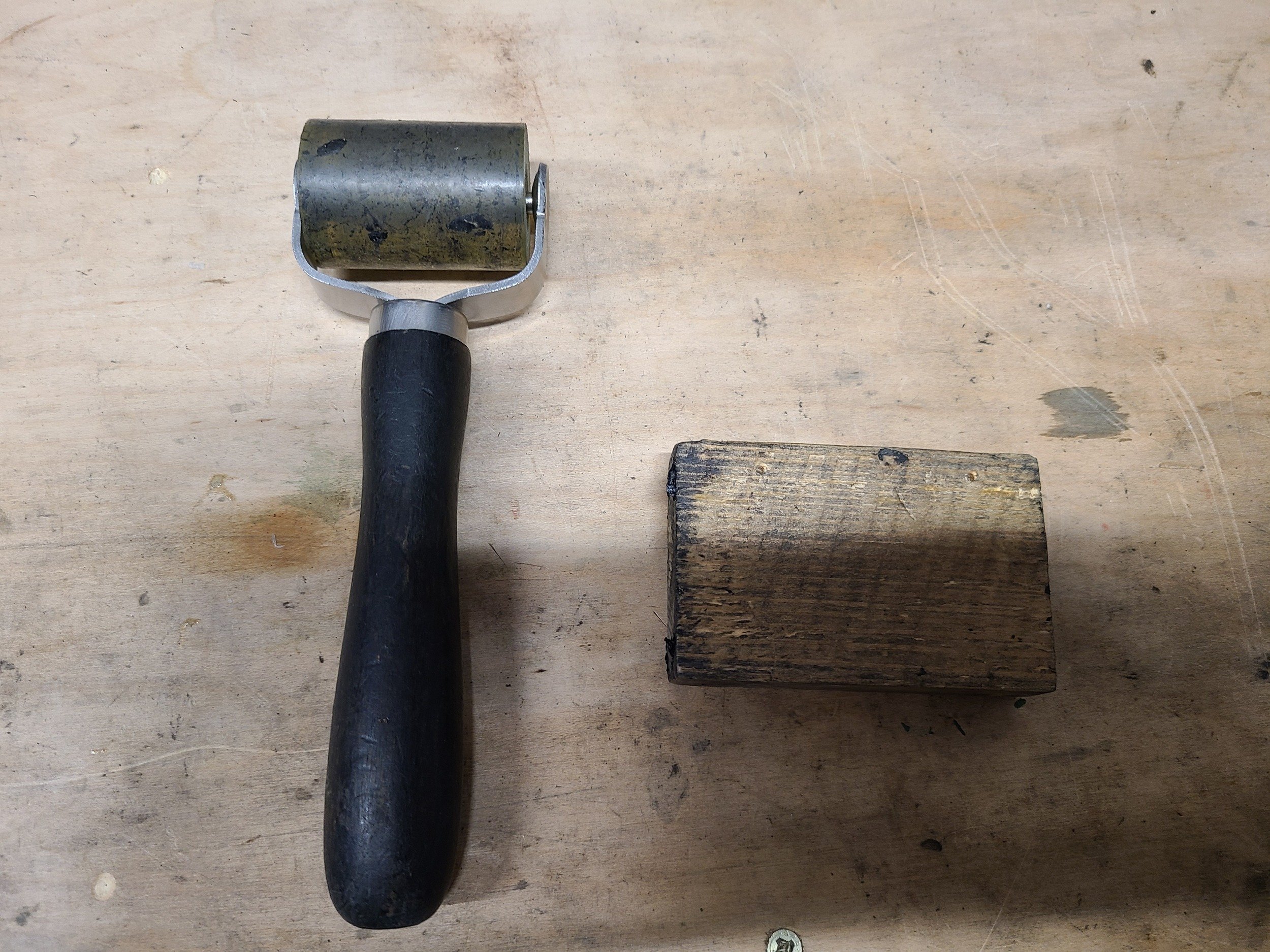

My install tools. Just a small, 4" x 2" x 1/2" piece of scrap wood. When you have big flat areas, the roller pushes down the larger areas quicker. The wood gets into the curves better.
Seems to be of good quality. But what do I know. Never messed with this stuff. I know it's not asphalt based. No smell. Bout 1/8" or so.

I used that stuff for my cars. I like it because it's thinner (2mm vs 4mm) so it's lighter. I'm not using it for more DB's, so I don't need the thicker stuff. I'm just using it to control vibrations. In areas where you do want it thicker, you can just double it up.
While it is pretty sticky, the 50ml maybe, the 80ml, meh... but that 120ml, needs to warmed up. I heat all of it and get the metal surface clean with denatured alcohol. I use the 50 mil on plastic pieces where the tolerance is very tight, the 80ml where it is hard to reach and the 120ml everywhere I can. There is prolly a caveat like, as long as you do it in the sun, on a 75 degree day. :ROFLMAO:
