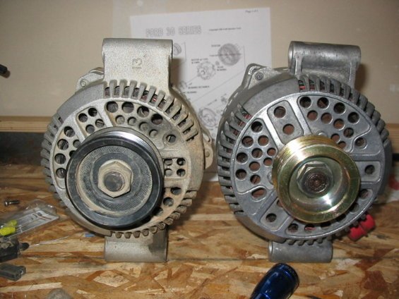

I've ordered from Bronco grave yard before. Good company. Butttt You can get a 130 amp 3G alternator out the junkyard for $40. They are pretty bullet proof alternators.
95a is the small case and 130 is the large case. Bolts right in and plug and play.
I've had a couple OBS F150s.
4 holes = 95amp and 2 holes = 130 amp
If I find one that’s 130 amp, will I still be able to use my same belt? I’m asking because the pulley looks a tad smaller in the 130 amp unless it’s just the pic
Off brand HO alternator will probably be an upgrade over stock and do what you need. I certainly wouldn't suggest shelling out 500$ and up for a premium one for a 25 year old truck and a small stereo system. Honestly I'd just do a higher quality AGM battery up front and see if that doesn't do enough on its own first.
That’s exactly what I plan on doing. AGM plus I’ll try a 130 amp alternator if I find one a pull a part this weekend. Thanks for the info guys!
