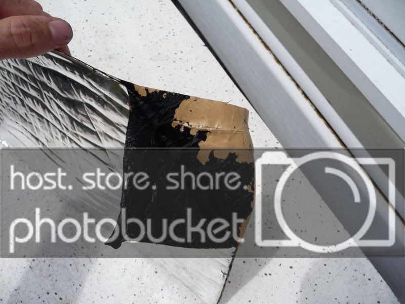

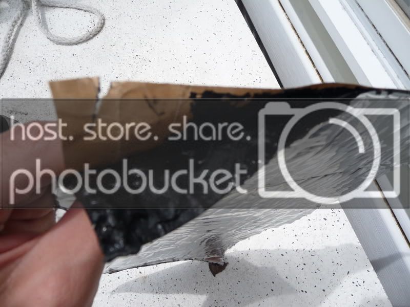

But when I went out and tried again I met the same results. //content.invisioncic.com/y282845/emoticons/frown.gif.a3531fa0534503350665a1e957861287.gif Here's two quick pics to show you all exactly what I'm talking about. I'm trying to peel the back tan paper part but it's really stuck on there.
Thoughts? First and foremost, am I trying to peel it off correctly? I tried looking for any other method but only found the one I'm struggling with.
Thanks in advance once again guys.
Holy ****! I just put the above strip in the freezer and in only like half a minute, I can completely peel it off! Sweet!
Now I just gotta find a way to stick the entire roll in there, haha. Or at least a bunch of small strips. //content.invisioncic.com/y282845/emoticons/smile.gif.1ebc41e1811405b213edfc4622c41e27.gif
Thanks again for cold recommendation guys! //content.invisioncic.com/y282845/emoticons/smile.gif.1ebc41e1811405b213edfc4622c41e27.gif
