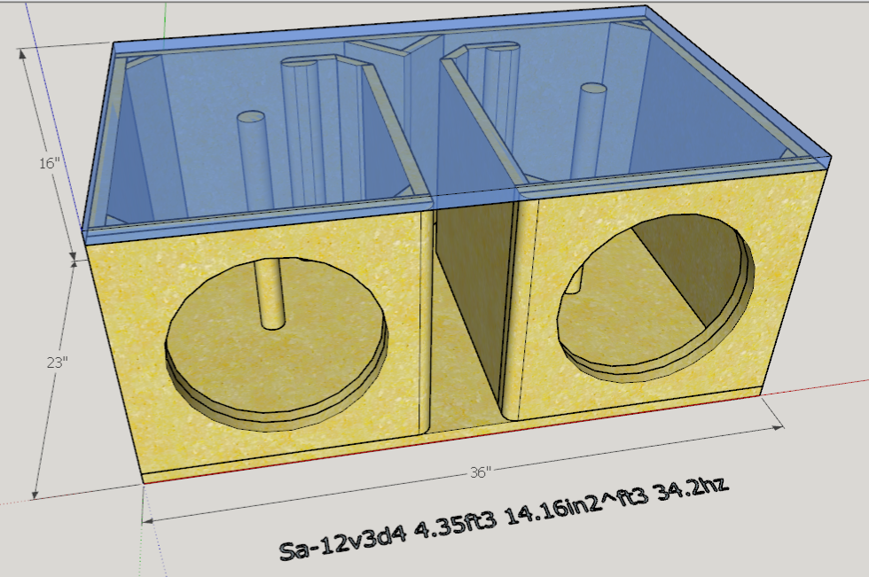

4.3 cubic ft tuned to 35hz
Does anyone have any recommendations for two 12” sub drivers that will effortlessly play with no distortion and all bass settings maxed out full tilt and will work with my current enclosure?

4.3 net for a pair of Sa-12's... tuned to 35hz?
That should do rather well if your levels are set correctly and you got sufficient amp power...

TBH All your settings sound beyond fked up dude. You'll most likely lose loudness going to the Us because you dont have the port to push them, you'll literally notice no difference or maybe even some losses with the so called upgrade. Tune your sh*t right
I have it at a little over half over on the amp volume gain, subsonic filter at 25-35hz it’s not marked so hard to tell lpf all the way yeah I like it as boomy as possible no bass boost,on on the hu I have all the treble midbass and bass maxed out it sounds alright with these settings on most frequencies but I can hear some distortion on certain frequencies if I lower it it doesn’t have the punch I crave. It barley has it with the bass maxed out right now it gives a good back/ seat vibration but I want it to really slam and feel it in my face and chest and stomach
With my SA12, I found that a 24 db Linkwitz–Riley (L-R) filter gives me cleaner sounding bass than a Butterworth or similar filter. I get a little more kick with the Butterworth, but at the expense of allowing more distortion by. Same thing with my Sundown SD3 in my truck, although that subwoofer plays a little cleaner up higher. Anything above 75 Hz on my SA12 in its current box, and I notice distortion. I think the box construction, shape of the box, and box port tuning play a huge roll in this. The current box my SA12 is in now is an experimental box that could be built with a little more stiffening, and not have all equal parrelel sides. I do have a DSP and some head units have these LP filter options as well, so you need to experiment with those more and also look hard at that box. You will read about the most experienced people here say over and over, the box makes or breaks how good the bass sounds, irregardless of the subwoofer driver itself.

It is an L port. You might as well add three 45's. Add one by the leg of the L and the two that I showed you in my other post.

There are lots of different programs. Winisd gives you the basics
