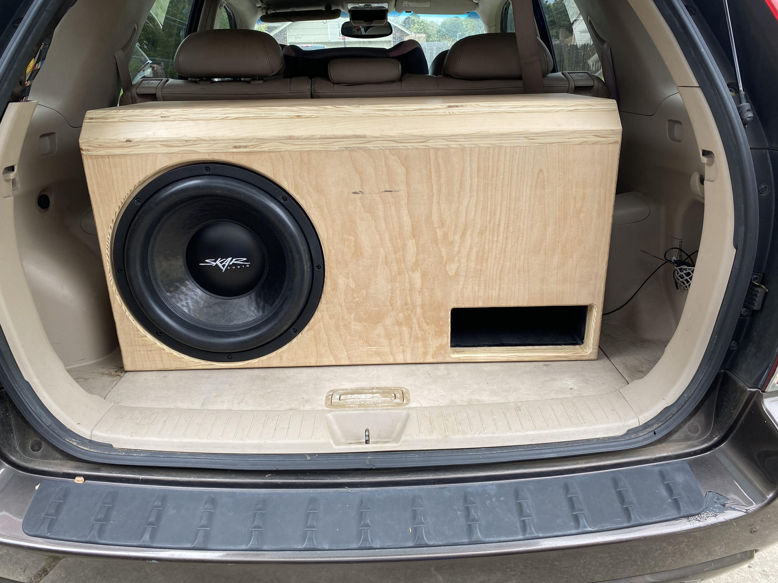

That box was built and worked well, for the record, and the owner liked it. The shape/width of the box + the sub and port placement is more of what I was showing. Some people are the STD’s of hate that never go away.
And the box really isn't that big, because it's a small SUV. The box is only 3 cubes net or so. Sorry OP, just here's the box built by the customer who I made the design for, if there's any confusion:

I'm just an audio enthusiast trying to give ideas; I love bass and think the Brahma is a sub that'll really shine in the right box.
I would definitely fire the port backwards and push the box up within a few inches of the hatch.
You weren’t kidding…that did sound a lot fuller, at a lower gain level at the amp!
I couldn’t keep it that way because it made it hard to take a stroller in and out without possibly damaging the driver, and the dog couldn’t climb in the back.
but, it’s good to know that firing the port backwards is the way to go for my next box. Maybe it can be smaller on the baffle side (with the port and driver shooting back) and most of the volume coming from its depth? So, a fairly narrow and short box (maybe like 20” h x 25” w) but pretty deep?

What you could do is make a tall and deep box that’s narrow where the 15” is above the slot port on the bottom, or fire the sub up and port back with a deep and tall box pushed all the way to the right or left side, whatever you prefer. I’ve done that successfully, as well. I can show you, if you want.
