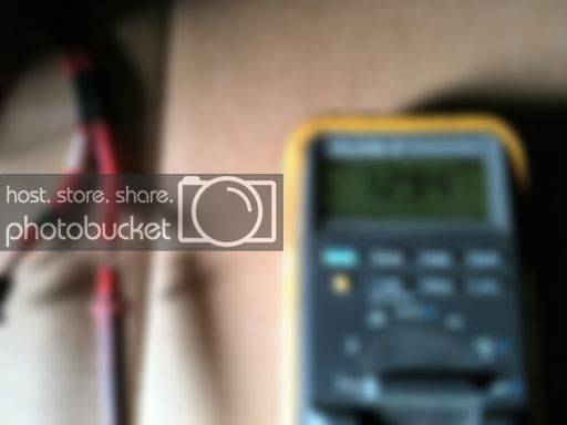

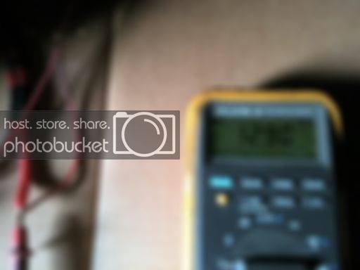

Ok guys I did a small test with an old 12" 300wrms 4ohm Hifonics sub I have laying around together with a 50Hz 0dB sine wave from Bass Mekaniks CD, (head unit volume was well below half so no distortion / clipped input) and honestly there is BARELY any difference with and without the amp having a load. Here are the pics to prove the results //content.invisioncic.com/y282845/emoticons/smile.gif.1ebc41e1811405b213edfc4622c41e27.gif
This is without the sub connected :
This is WITH the sub connected (0.04 AC drop - not even really worth worrying about!) :
Think I have found my answer //content.invisioncic.com/y282845/emoticons/smile.gif.1ebc41e1811405b213edfc4622c41e27.gif Besides annoying the neighbors and risk of destroying the sub plus shaking stuff off the shelves in my garage lol, I think using the dmm method with no load, IS OK in my book!
Think I have found my answer //content.invisioncic.com/y282845/emoticons/smile.gif.1ebc41e1811405b213edfc4622c41e27.gif Besides annoying the neighbors and risk of destroying the sub, I think using the dmm method with no load, IS OK in my book!
In your case I would agree. Where it really matters is when you're trying to push every watt possible from the amp. You'll find that an amp will clip under load at a lower output than without. But you'd need a 'scope to see that, not a DMM.
