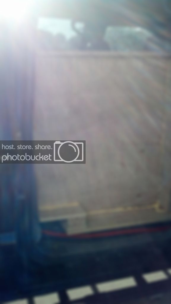

Silverado DDZ build
I moved the front baffle so the port is now on the driver's side
Then I put the last side on the box
I'm going to do one more layer on that side, and at least one more up top. Probably two more on the top.
Then I'm cutting the holes for the subs, coating the inside with fiberglass resin, and bracing it with threaded pipe.

Dat glue tho...

I'm putting another layer over that panel, so the extra glue running didn't matter
I'm happy with my alternator decision, haha
A few reasons.
1. I won't have as much noise in my mids/highs. The 4 channel will be hooked up to the stock system, which is isolated from my battery bank. Therefore, the noise that the 20.2k dumps won't be an issue.
2. I won't have to replace my starting battery, which is brand new, but lead-acid.
3. I can run a different voltage, and accessories like headlights won't give me voltage drop.
There were a few more that I've forgotten.
