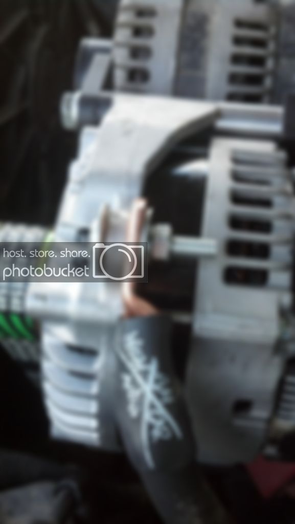

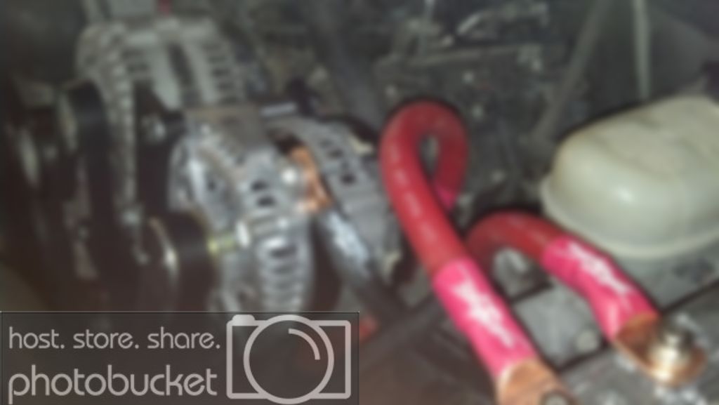

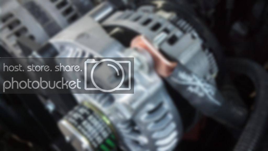

Got my ground wire from the alternator ran all the way back into the bed

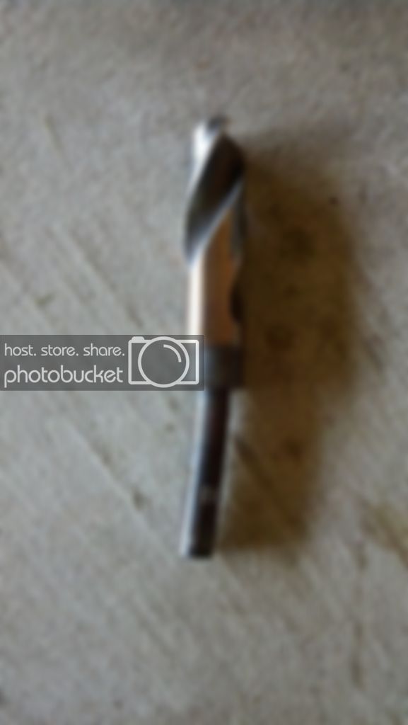

I bent my $70 drill bit today //content.invisioncic.com/y282845/emoticons/frown.gif.a3531fa0534503350665a1e957861287.gif
It stuck, and I thought the drill broke my wrist for a second. It smashed my arm against some metal and I was pissed when I saw the bit.

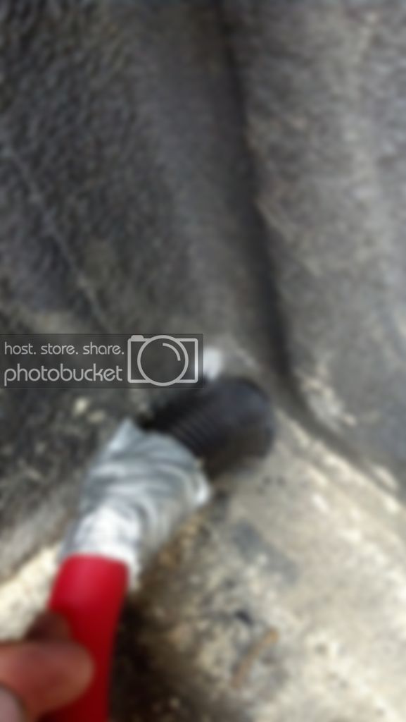

Anyways, I opened up the hole and covered the wire with split tubing. Not going to see the duct tape behind the battery rack.
WTH ? 70 dollar drill bit ? //content.invisioncic.com/y282845/emoticons/crazy.gif.c13912c32de98515d3142759a824dae7.gif How ever a little heat shrink would look a little better than ductape ? why didnt you just use a 5.00 hole saw and make it big enough to put a grommet in there so you dont gotta wory about sheet metal cutting through your flex loom and wire and potentially starting a fire ? I am a little concerned buddy ? Or is that your ground ?
Forgot to say that its coming together nicely though ? I am just worried about that wiring //content.invisioncic.com/y282845/emoticons/confused.gif.e820e0216602db4765798ac39d28caa9.gif
Didn't have a hole saw that was the right site, and I think the loom is going to be fine. Anyways, everything will be fused.

Also what sort of drill bit did you break? I always use a good quality unibit and while they eventually wear out, they slide through sheet metal like nothing.
This drill bit. The top part is 7/8 inch, so it's pretty big
You can buy a Klein Unibit for 70$ which is the proper tool for that sort of thing (and generally very handy). Or buy a cheaper knockoff for 25-30$ range, but I'd trust the Klein to perform better and outlast cheap brands.
It was what they had at the local hardware store
Or you can get a set of three uni bit copys at harbor freight for less than 20.00. I have had a set for over a year and still cutting fine. At work I have klein and they last forever but as Hispls said they are expensive but not 70 bucks jeez. And how the heck did you bend that thing? That must have taken some force.
I'm honestly surprised that the bit bent and my arm didn't break. It smashed my arm between the drill and the side of my truck bed. The tendons in my arm took some damage. I can't make a fist and bend my wrist all the way at the same time. They're still swollen and won't stretch that far
