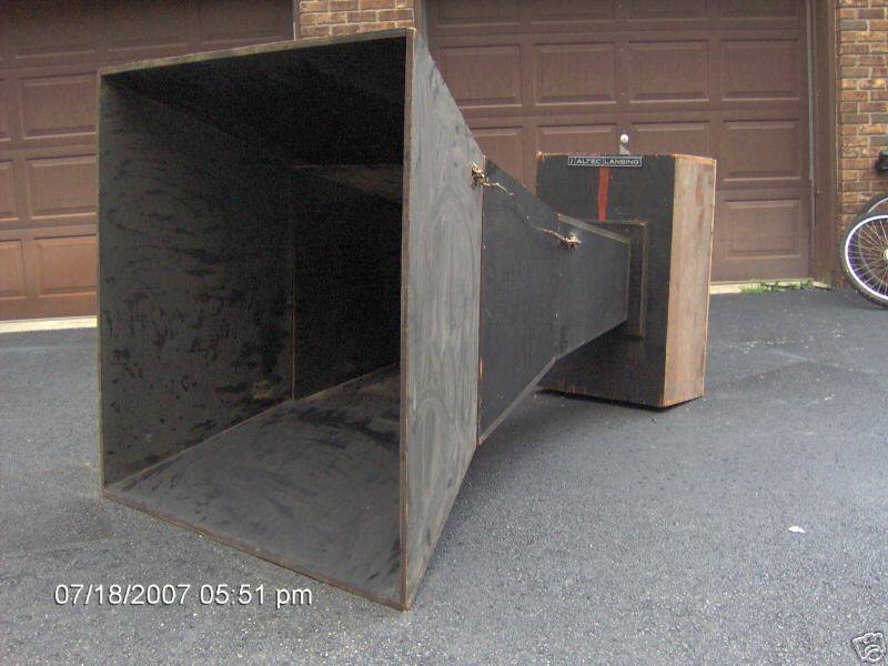

Horn if you got the space

Did you see that horn with pair of 10's in Sanford at the first show of the year there? It was VERY impressive for the power and cone area. A true horn can give fantastic gains.

It was a legit horn, station wagon full to the B pillar. **** was real.

Yep that was Joshua Rideout's setup. He had a pair of TC 10's iirc. Pulled a high 130 at 20hz and had enough force to move the entire box back and forth (keep in mind that box probably weighed close to 150-200lbs and was also strapped down)

Last I talked to him he was gonna go all out with concrete but I don't know if he's gonna go through with it or not, after all that means buying another vehicle...
