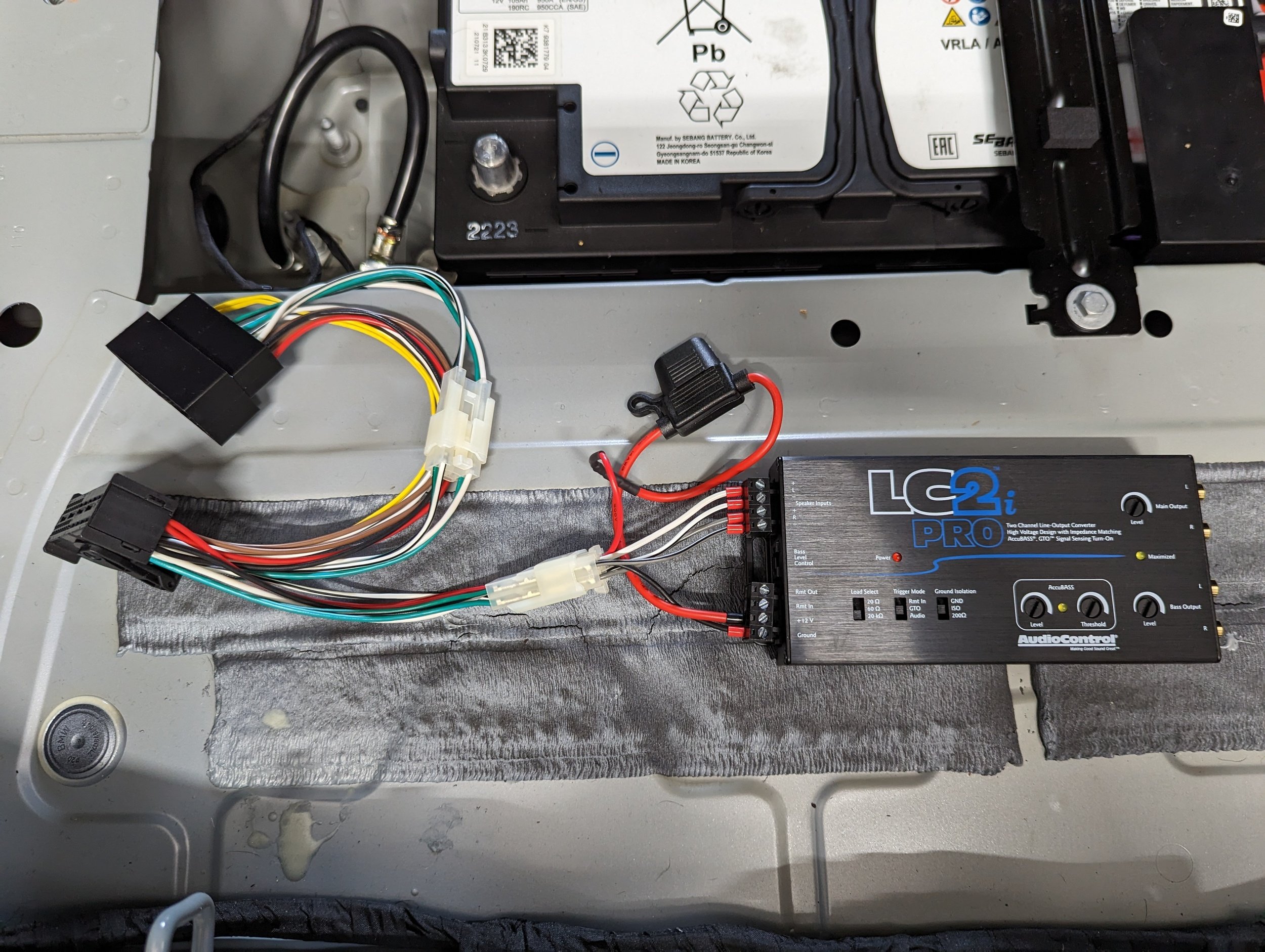

Hey guys,
I recently wired a sub into my 2022 BMW M240i using an AudioControl LC2i Pro, Sundown Audio SFB-1000D, and a Sundown Audio SA12 in a sealed box, running 1000w @ 1 ohm. I've used the sub in my previous car and it hit really well using a Soundstream 1000w x 1 amp.
I've been trying different tuning levels on the LC2i pro but it seems like no matter what I set it to, the sub hardly moves. When it does begin to give decent output, the amps clipping light blips.
In my previous car with the soundstream amp, it hit really hard and I was expect something greater than or equal to that with the SFB amp. I tried hooking the Soundstream amp to see if maybe the SFB amp has an issue, but that amp also hits at the same lacking level as the SFB.
My assumption is the LC2i tuning is my problem. I am trying to keep the LC2i level at half or below as the max input the SFB amp can take is 5V, and the LC2i puts out 9V.
Any thoughts? Does anyone else have a similar experience when wiring a sub into a BMW? I am using the technic PNP harness to get signal.
Thanks

I hooked up the bass knob which has a clip light on it and have it in hand while I drive. I am finding that I get some noticeable output with the volume up, but the clip light flickers on good bass notes.
Is it bad for the clipping light to blink on certain notes? If I set it to where it never clips, it's hardly noticeable over the OEM subs.

I reached out to TechnicPNP (maker of the plug n play harness) tonight asking if it's expected to output a full range signal, as the kit I bought is intended for adding a sub. They responded quickly and I learned that I plugged the harness into the wrong unit, so tomorrow I am going to make the switch and hope for the best. Odd that I still get power and music, just the incorrect level of music, likely the unamplified version. You'd think it wouldn't work at all, and that I'd break fuses, or devices entirely.

I plugged it into the unit up top when its supposed to go into the lower one (see the gray curved plug, thats where the harness should go).

Problem solved! It is now loud as hell with the gain hardly up on the LC2i or amp and clipping only blips on really hard notes.
The problem was I had the plug-n-play adapter from TechnicPNP.com connected to the amp that powers the door speakers, which most likely had the bass frequencies already crossovered out. I connected it to the other one, and it's 100x better. I now regret buying the ported box, but may still use it since it's black carpeted and will match the trunk better.
