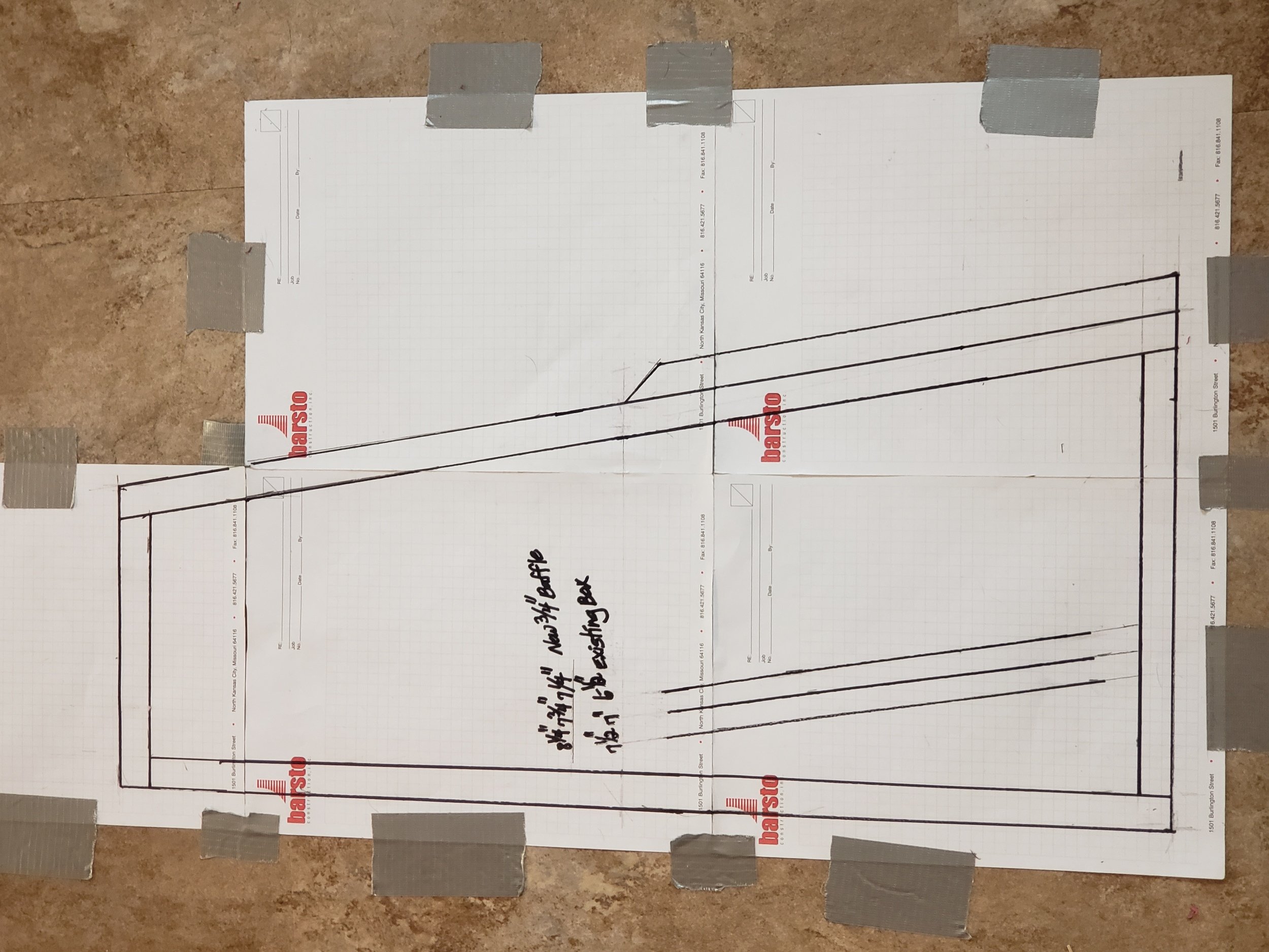

Checking my available mounting depth when I do switch subs. One set of numbers for the existing box and one set of numbers if we add another ¾" baffle.

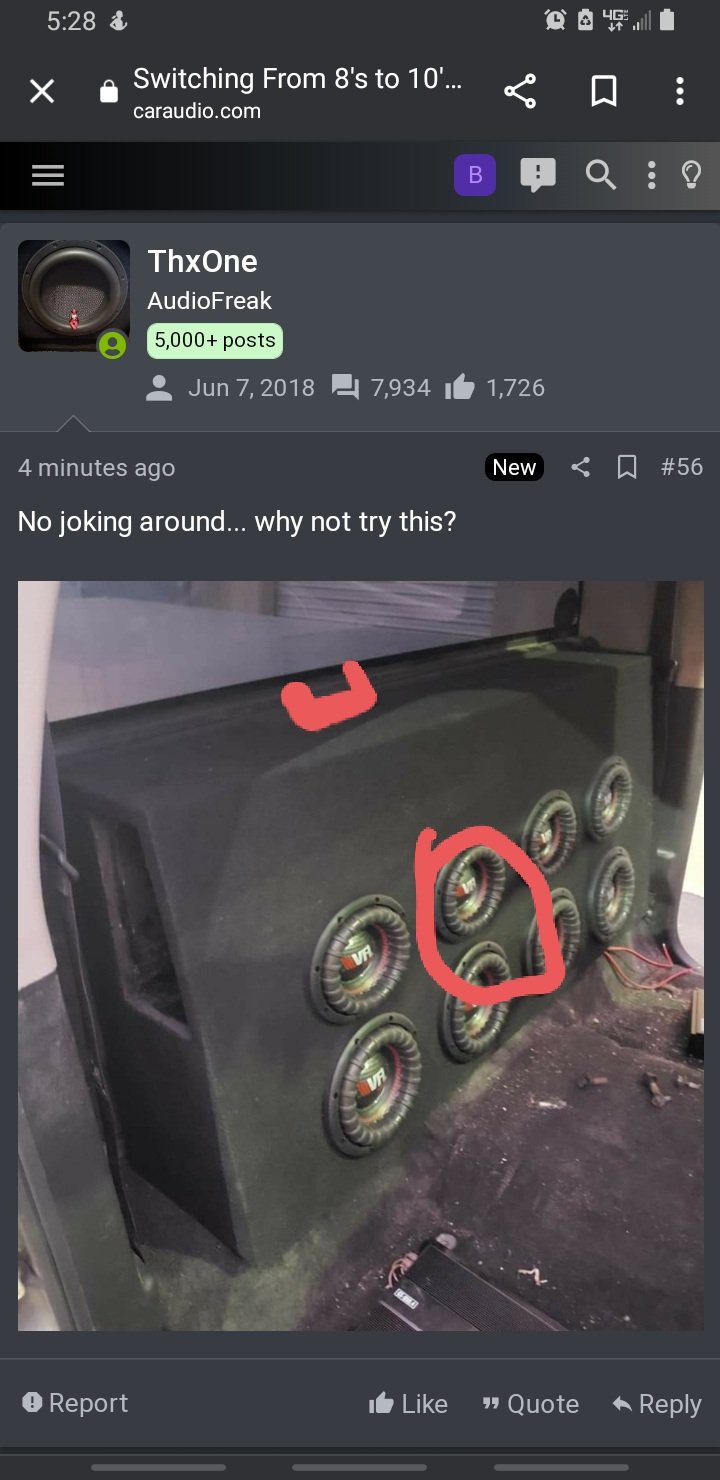

No joking around... why not try this?

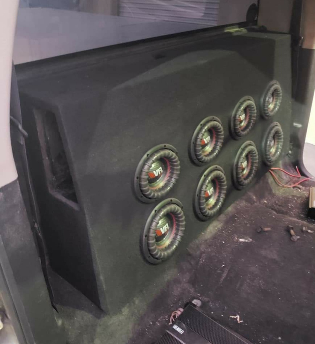

I'm not sure which is worse. .5 cubes per 8" sub or .95 cubes per 10" sub.?
It's not a bad idea if he has room and I bet he would get those 3db.
I will be switching to a 5K amp eventually. The mounting depth of one sub might be and issue. My box has a 2" notch for the center seat belt shoulder strap. It has been removed but the notch can't be removed. 6 might work.
