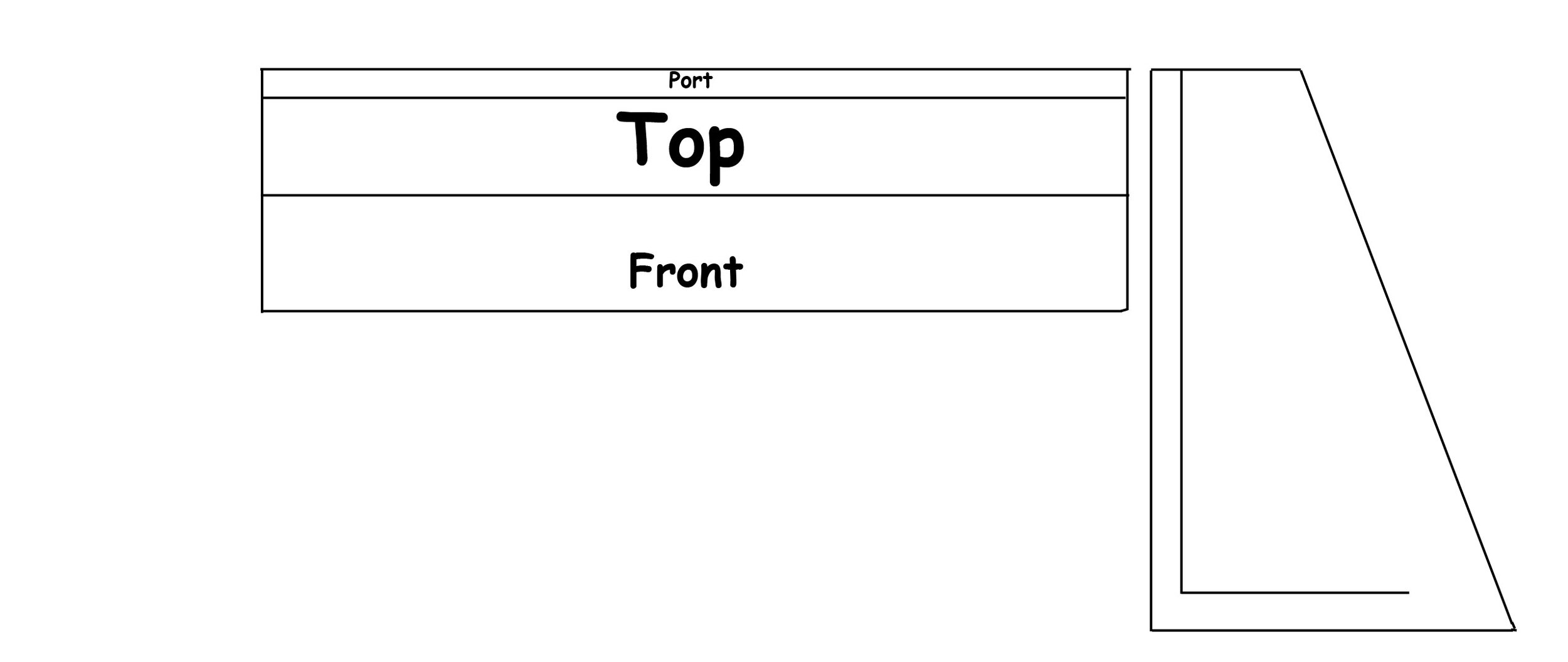

How about this? Top port instead of side port for more port area and greater internal space to mount the subs?
I need the port to load against the passenger side. The port is about 4" from the side. I think 4 - HD10's is the way to go. 1,200 ounces of motor and 3" voice coils.

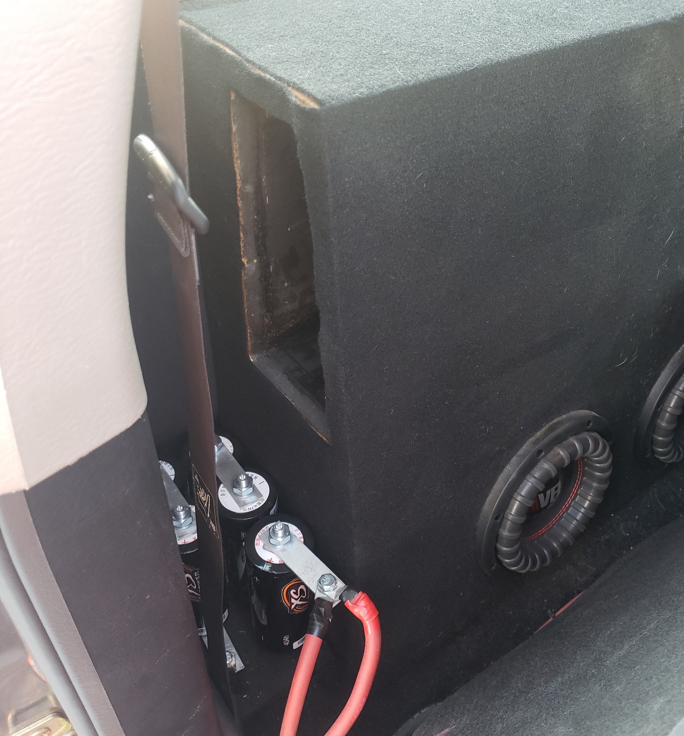

If I do 4 - 10's then the box will have a slightly larger wedge port on the passenger's side. This is what I have now.

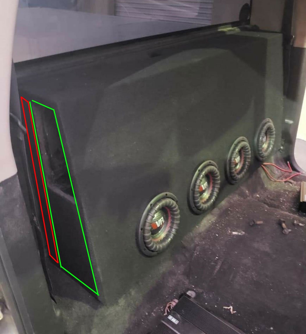

I was thinking like this... the red area would be the port which would give you all the green area inside the enclosure... I think it would give you more airspace per sub.

Do you think that’s enough airspace for those 10’s? Website recommends 1.5-1.75 per sub but as discussed, not sure how accurate their specs are.
