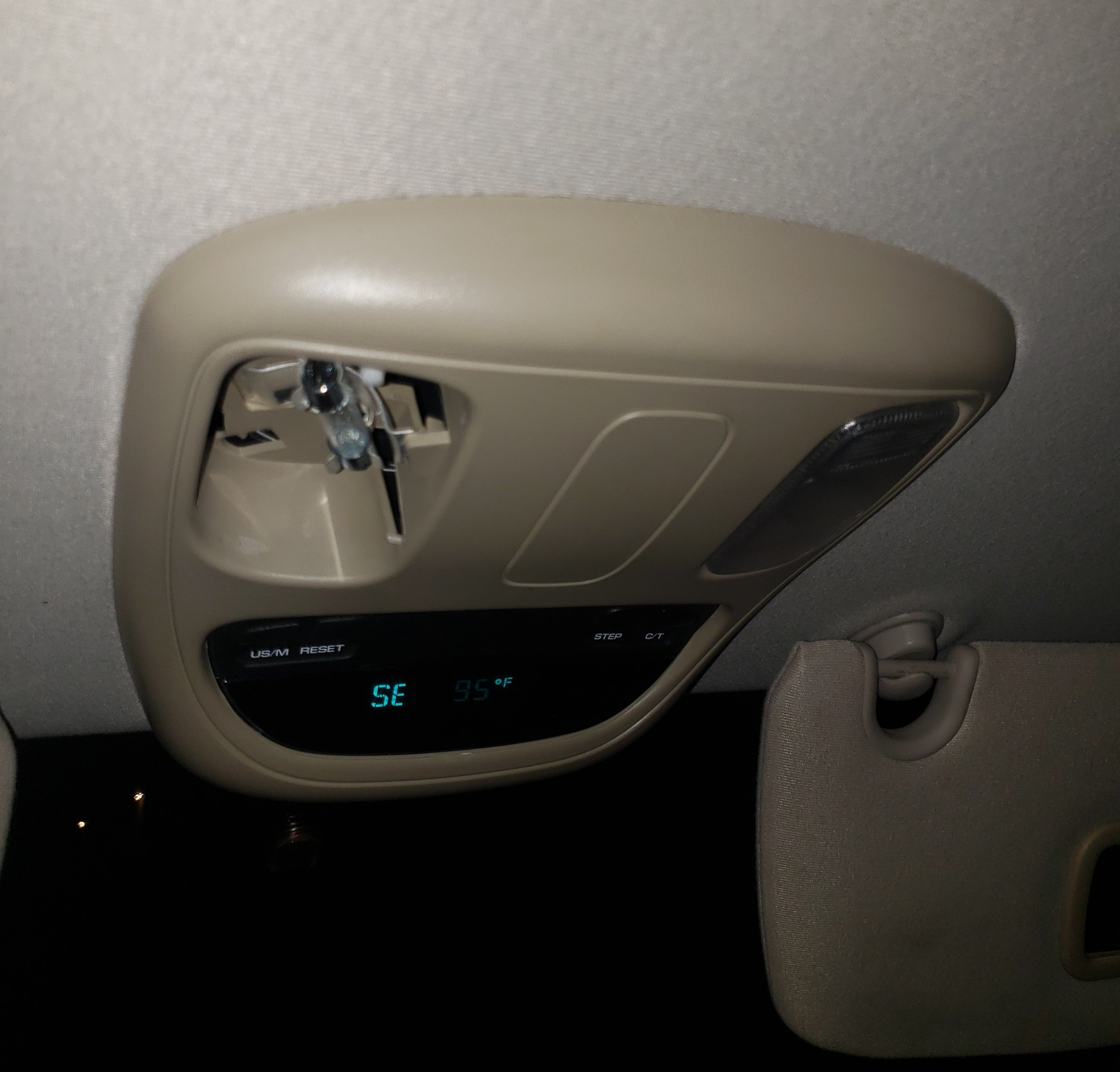

I've already wasted my rear view mirror and overhead console.

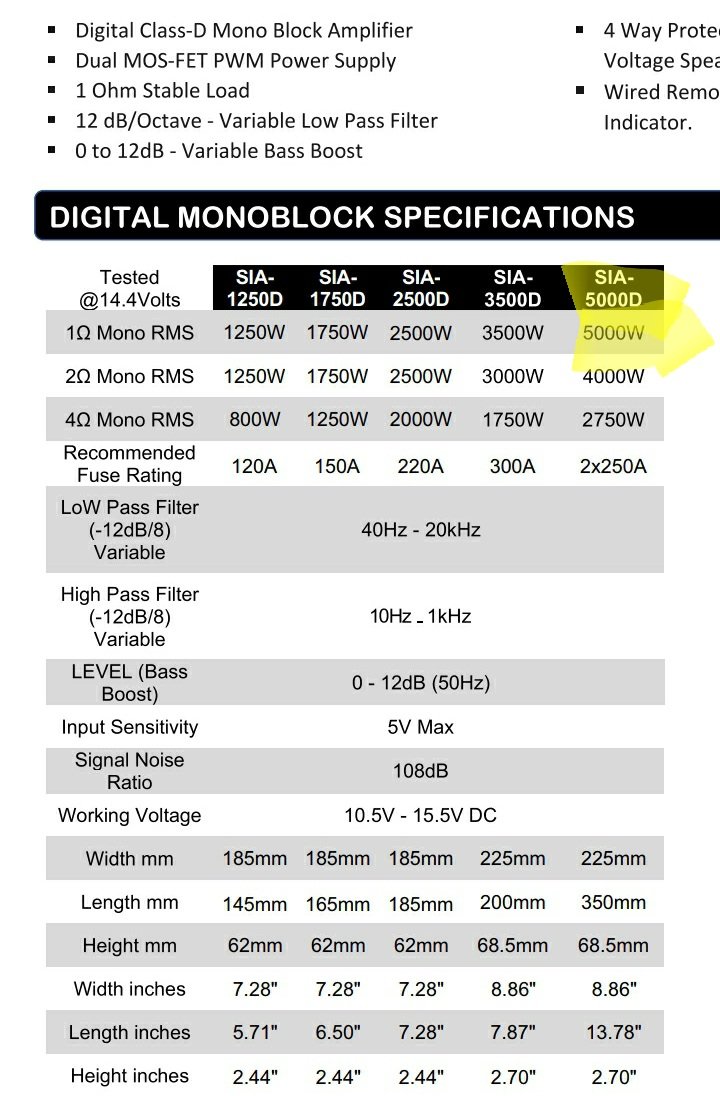

Do you mean for 8's or 10's? The higher I go the narrower the top of the box gets. Diminishing returns. Do you not think 4 - 10's on a 5K is an improvement. That is 57% more cone area than 4 - 8's and 120 more ounces of motor force. 3,200 watts rms compared to 2,400 watts rms right now. And a 42% increase in power if zi switch to a 5K

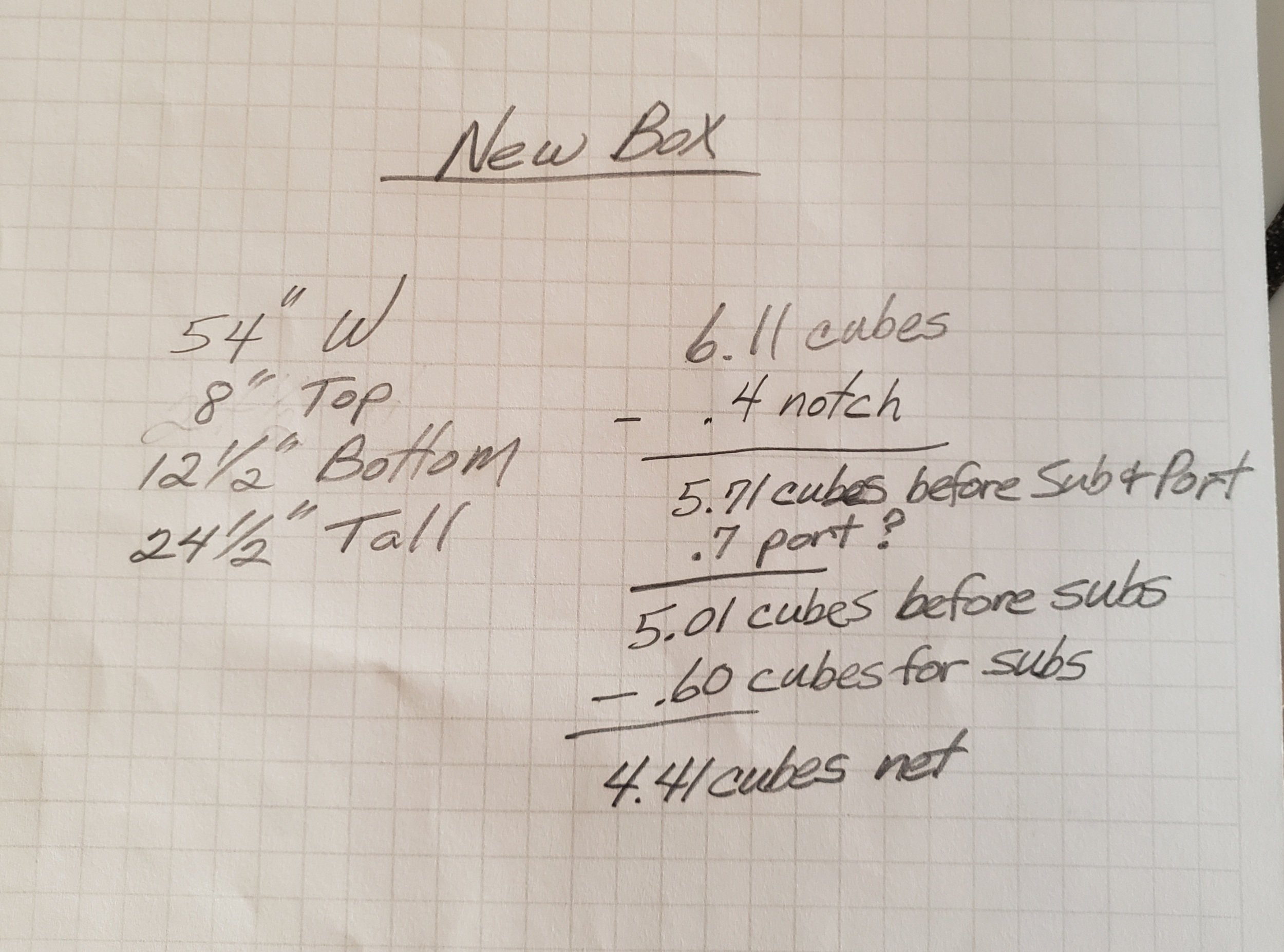

Inverted wedge? How am I going to get 7.7" of mounting depth with an inverted wedge? I want my stock bench seat to remain intact. My rear view mirror broke in two pieces due to the pressure. My overhead console broke in pieces due to the pressure. I can't get enough airspace for 8 - 8's. I can barely get enough for 4 - 10's.
Hmmm. May have to just try the baffle and do 4 tens and move your seat up 1.5-2 inches when you go full tilt?? I would look at the A.Bass Elite series also.Pretty damned good subs that get down too
:ROFLMAO: :ROFLMAO: 💩 I had to remove my overhead..I had take my rear view off. Serves no purpose at this time.My entire rear is Plastidipped inside windows, 4 layers of 80 mill,2" Foam board, framed up 2x4s and 1 layer of 3/4 Plywood atm. Will do another layer later to finish up a wall build out on the Xcab. rear windows are screwed shut also. I need do more roof treatment. 4 layers 80 mill, and screwed back up overhead serves no justice
I will go with this new box for 4 - 10's. That is a big behind the seat box in a standard cab.
