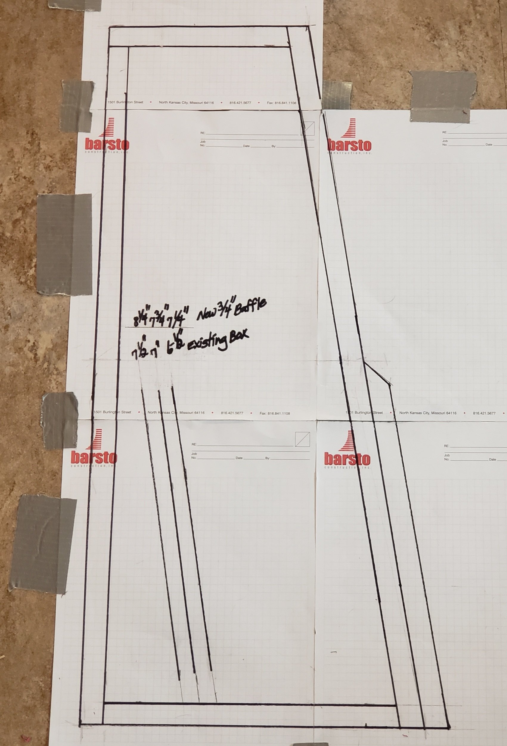

The top of the box is limited in depth because I'm not going to drive around uncomfortable. 4.4 cubes should work for 4 - 10's. I have a stock cabin right now. All speakers in stock locations and zero sound deadening.

It's more airspace than anything else. You would want at least 6 cubes net for 8 - 8's. 4.4 cubes for 4 - 10's is tight but feasible.

Can you modify the existing enclosure and go higher and do two Aero Ports loading off passenger side????
Do you mean for 8's or 10's? The higher I go the narrower the top of the box gets. Diminishing returns. Do you not think 4 - 10's on a 5K is an improvement. That is 57% more cone area than 4 - 8's and 120 more ounces of motor force. 3,200 watts rms compared to 2,400 watts rms right now. And a 42% increase in power if zi switch to a 5K
Not with the angle of the wedge.
