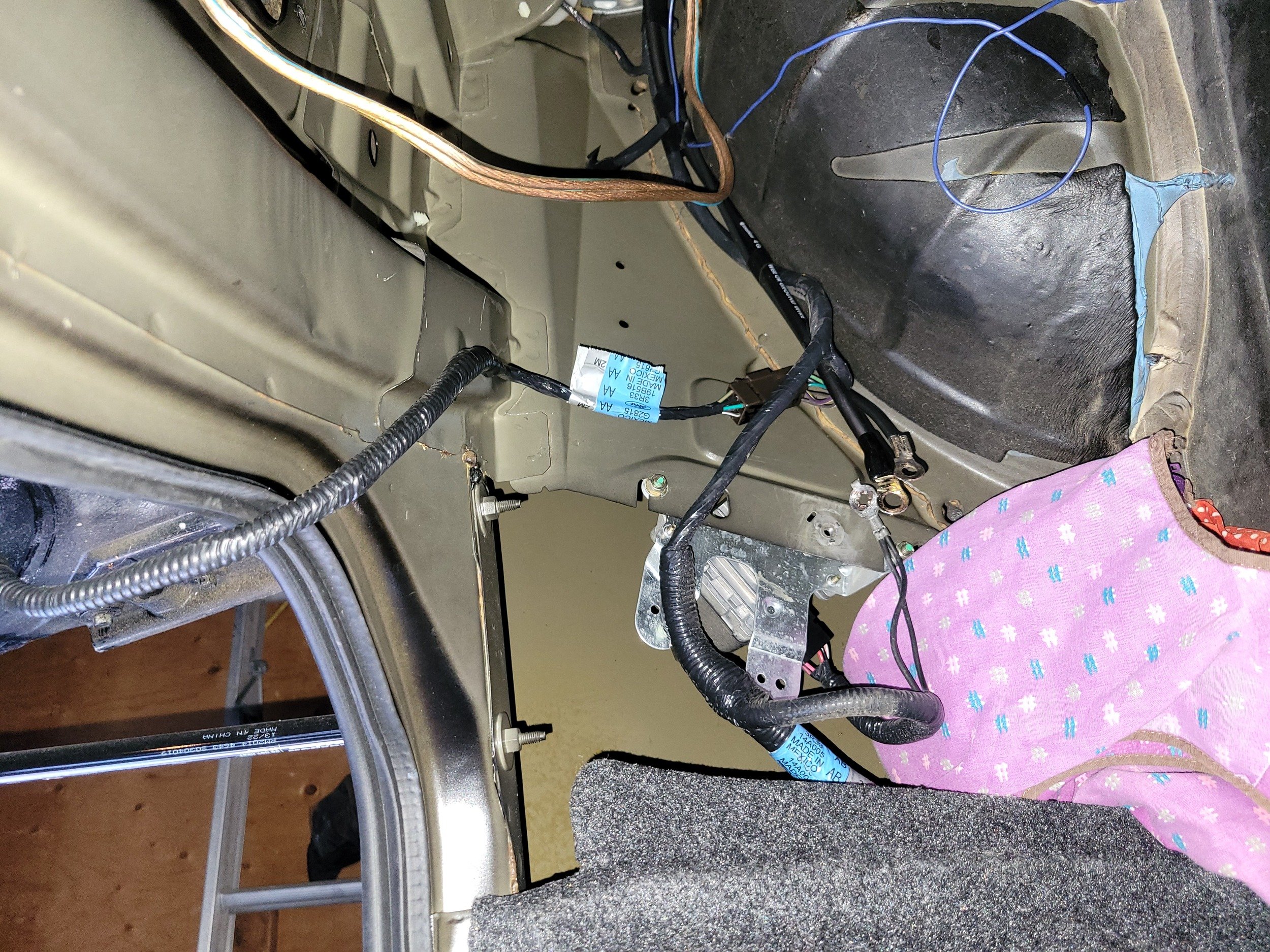

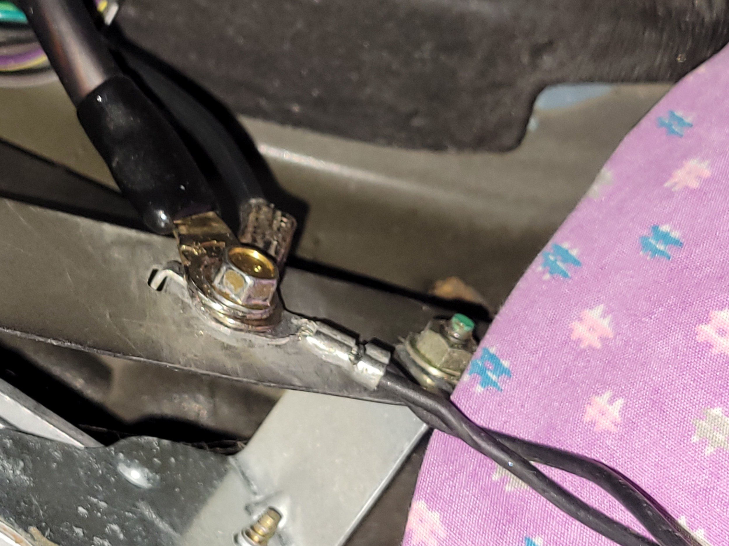

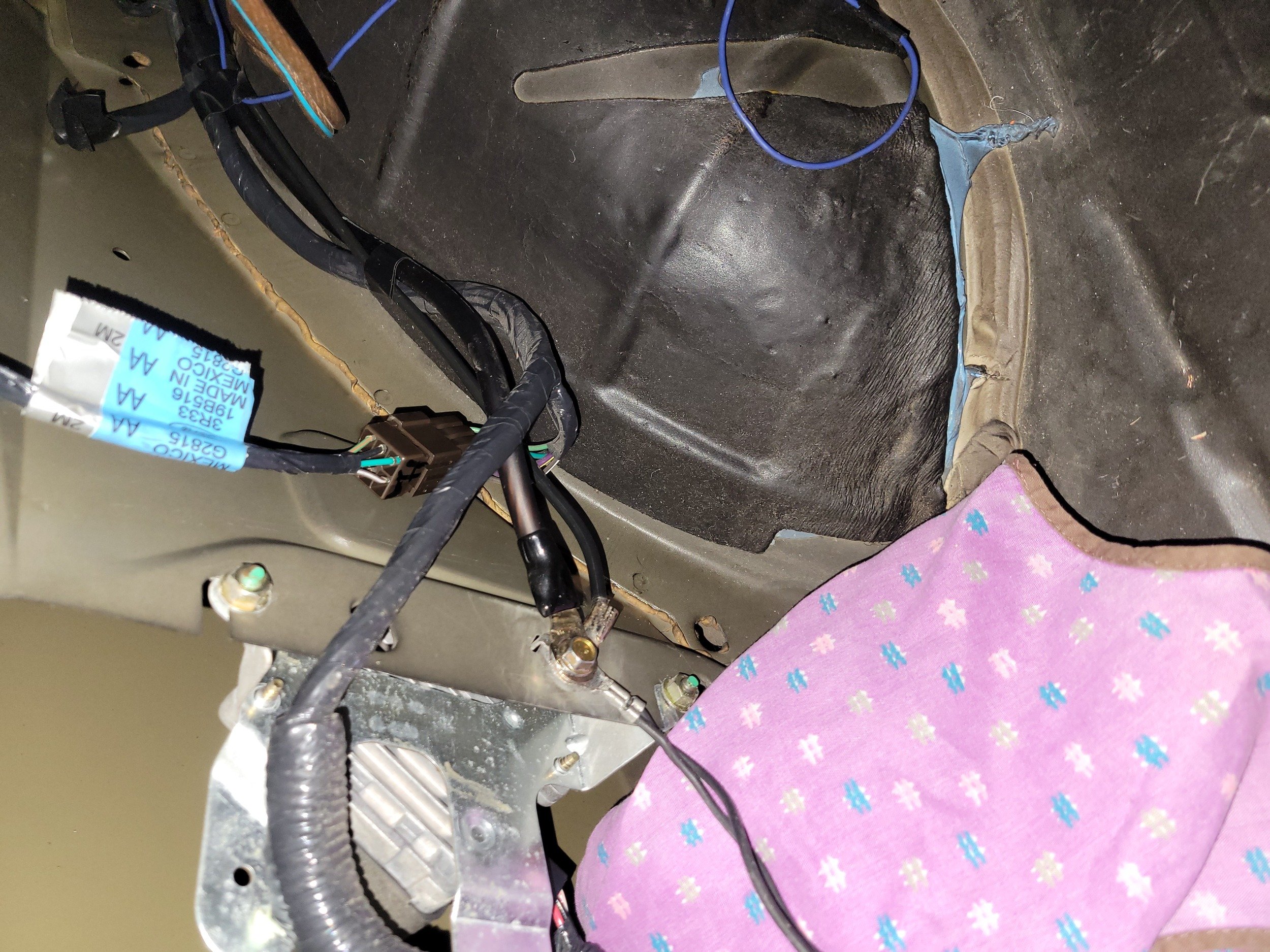

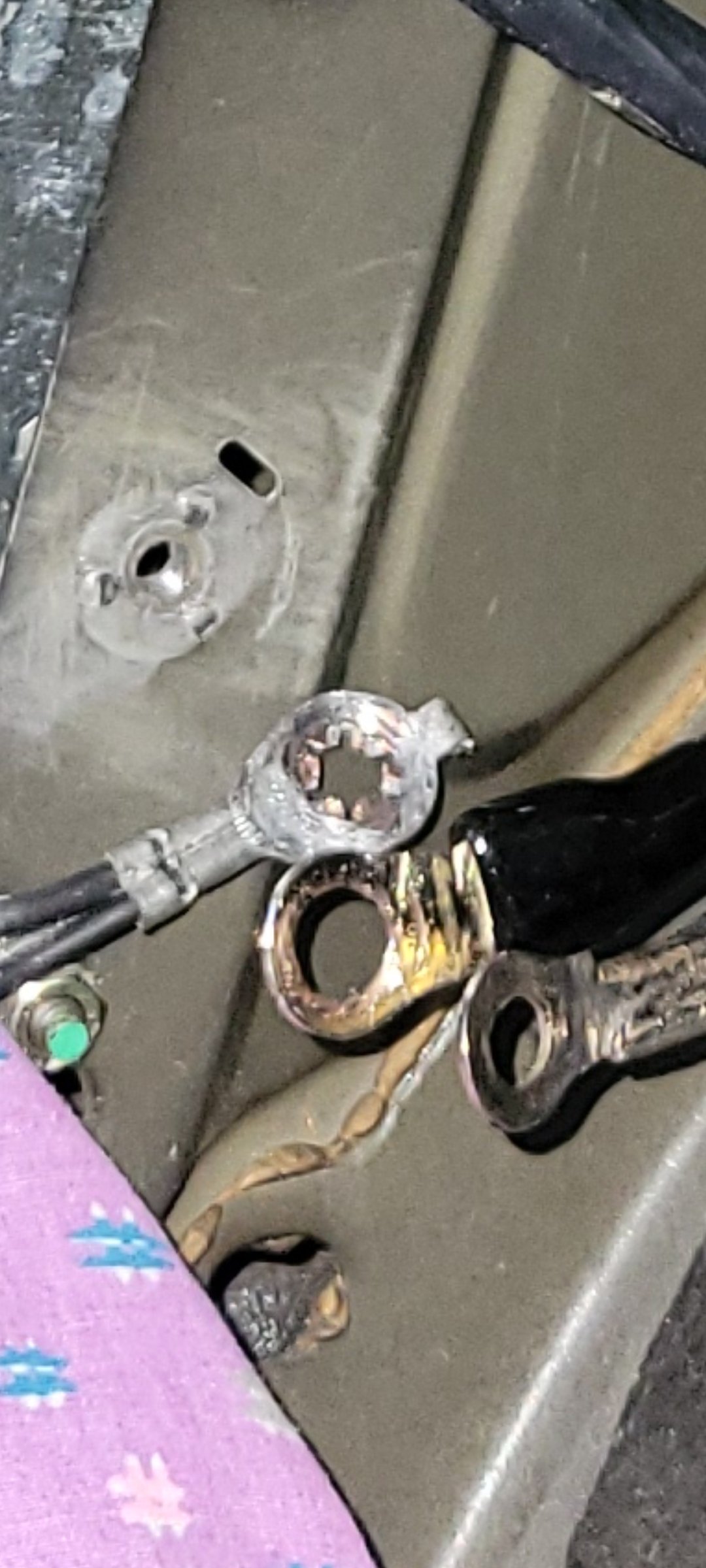

Almost at a perfect finish line. I bought a new HU and amp which solved almost all problems.
When the car is running, and the radio/bluetooth playing, there is a slight whine.
It can be reproduced when using the power windows and when accelerating which is where it's most present.
Could it be because i don't have a negative 4awg wire from the battery to frame? I added a HU ground to frame..no help. I also included pics of my current ground point in the trunk for the two amps, one 4awg and one 8awg piggybacking an existing ground location.
I understand a ground loop isolator might help but keeping as last resort, I'd prefer to solve the issue since it wasn't present before.
RCA filter i dont like due to SQ degradation.
What do you think?
