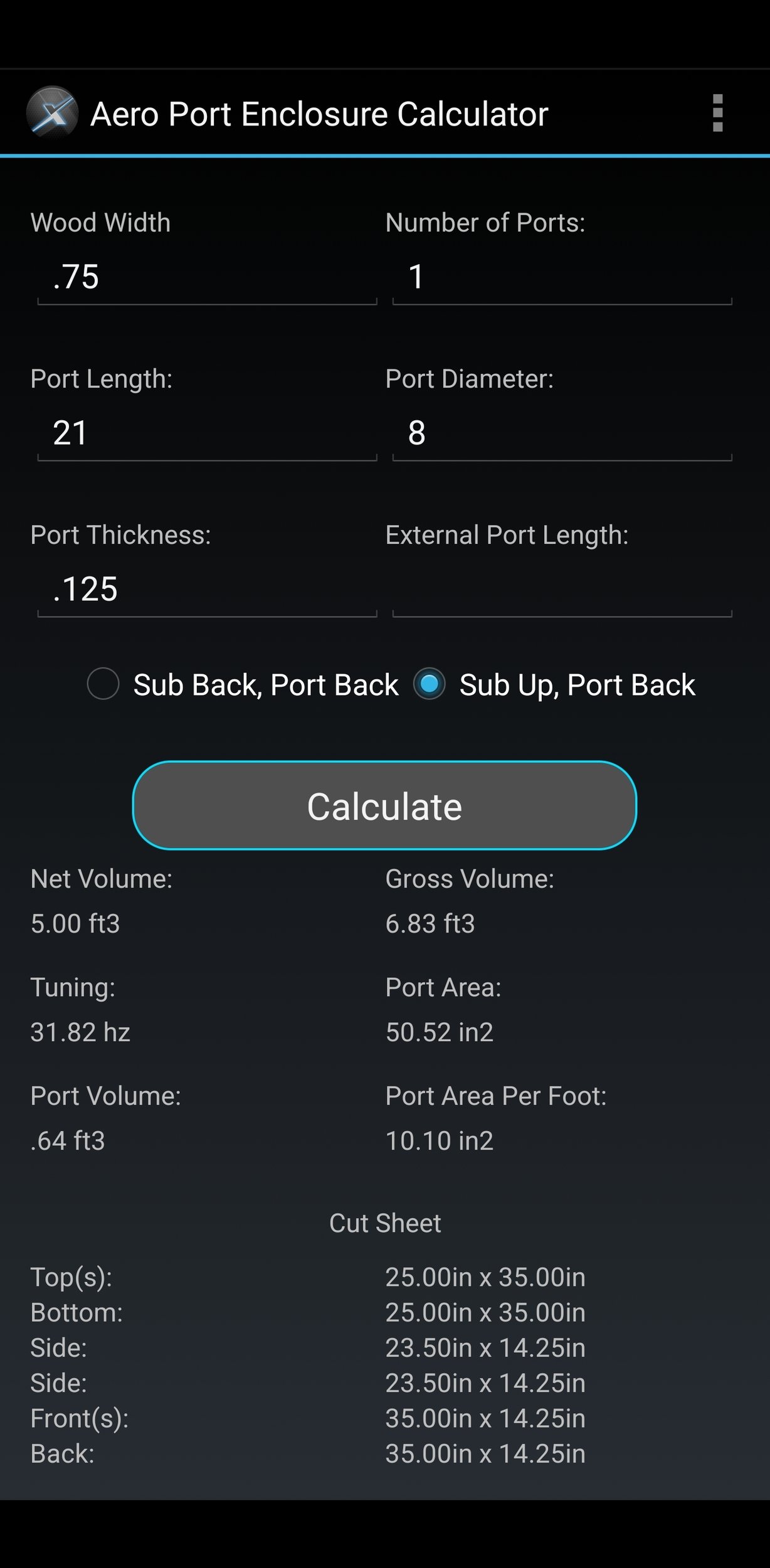

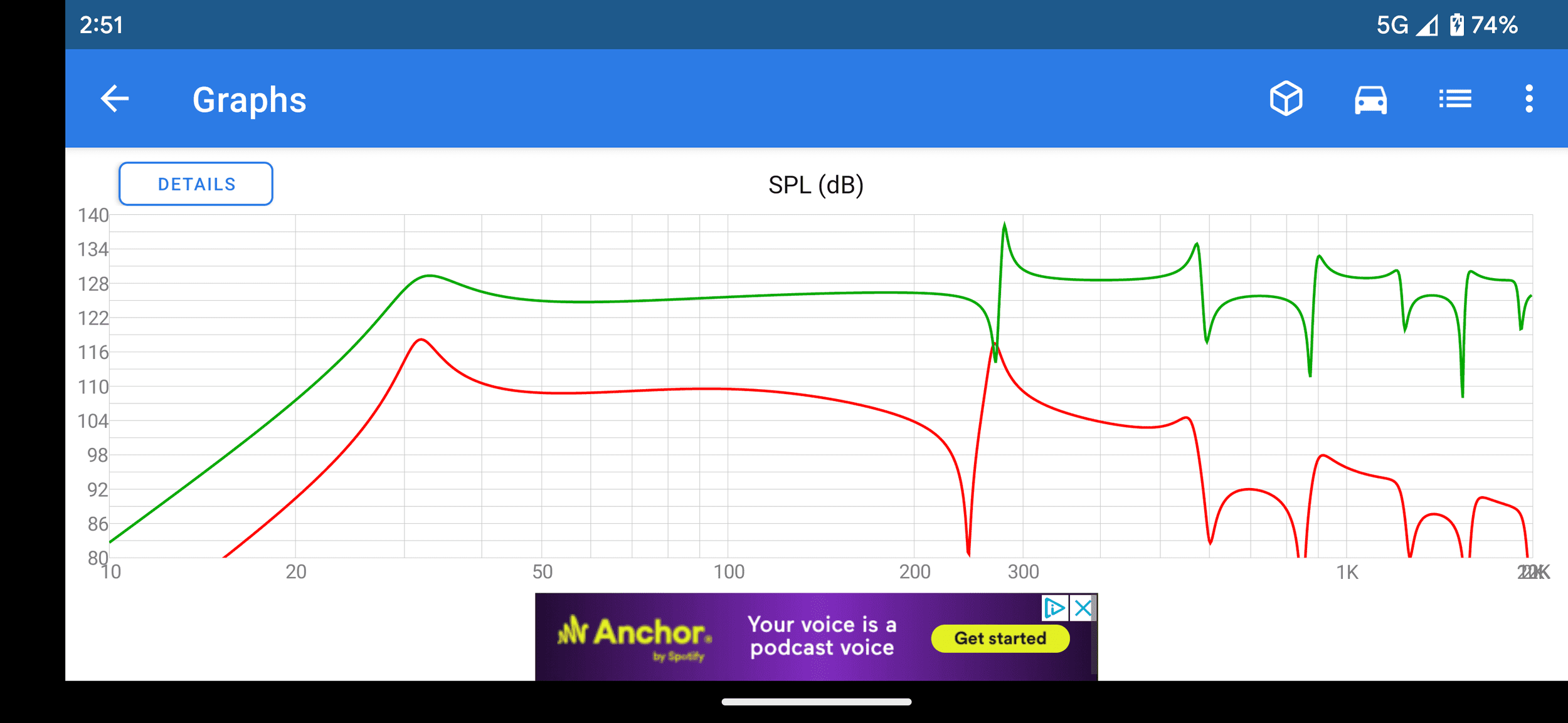

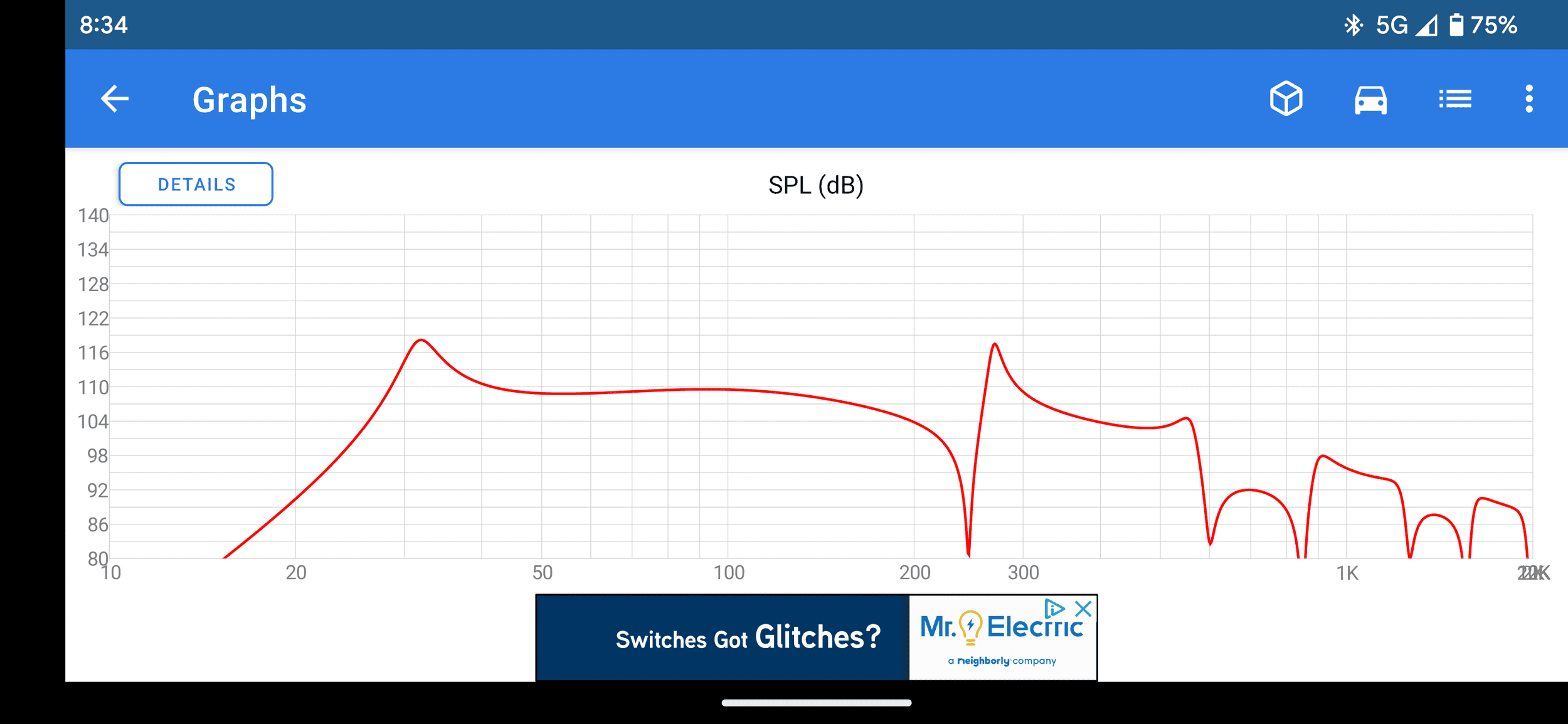

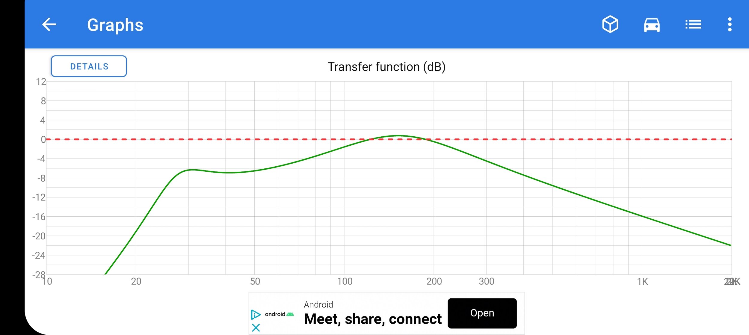

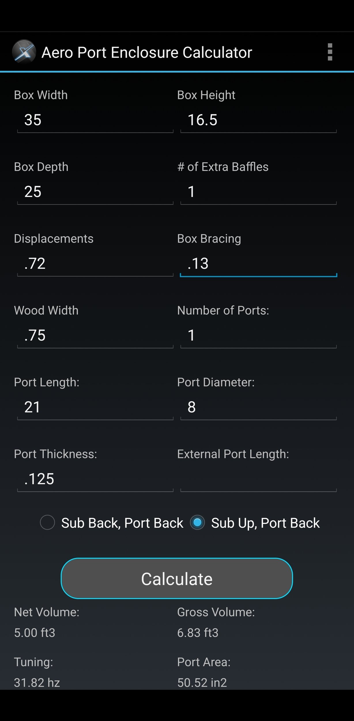

Here's you 5 cube box with 4 DC lvl 4 12s on 6000w of power with a single 8inch double flared port 21inch long
That looks pretty damn peaky to me down 6db in less than 10hz
That's a starting point. From there you tweak until you get the response that you're looking for.
My point was that 4 12's will fit. 1.25 cube recommendation can be increased slightly, I believe up to 1.5 without creating an issue.

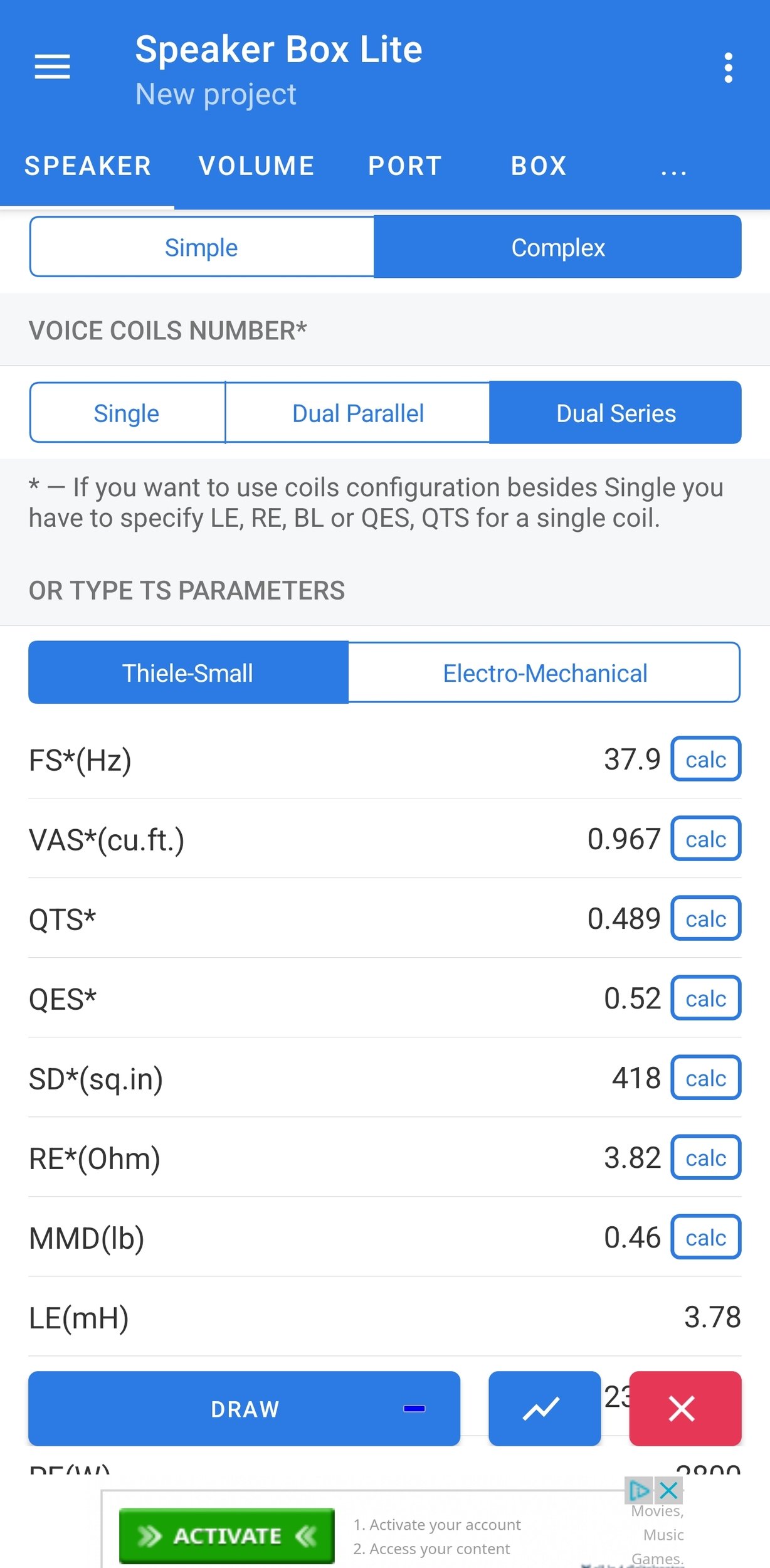

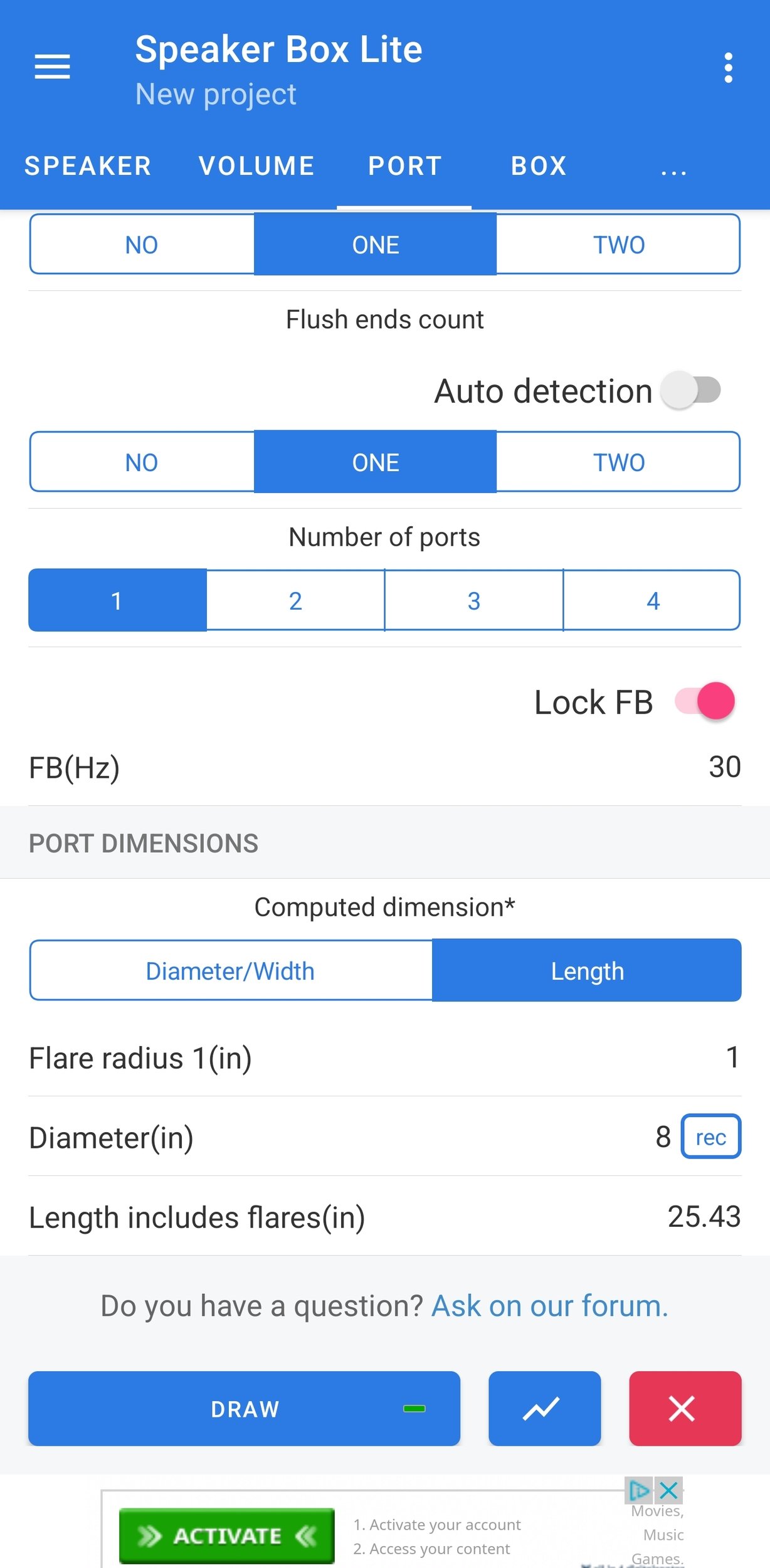

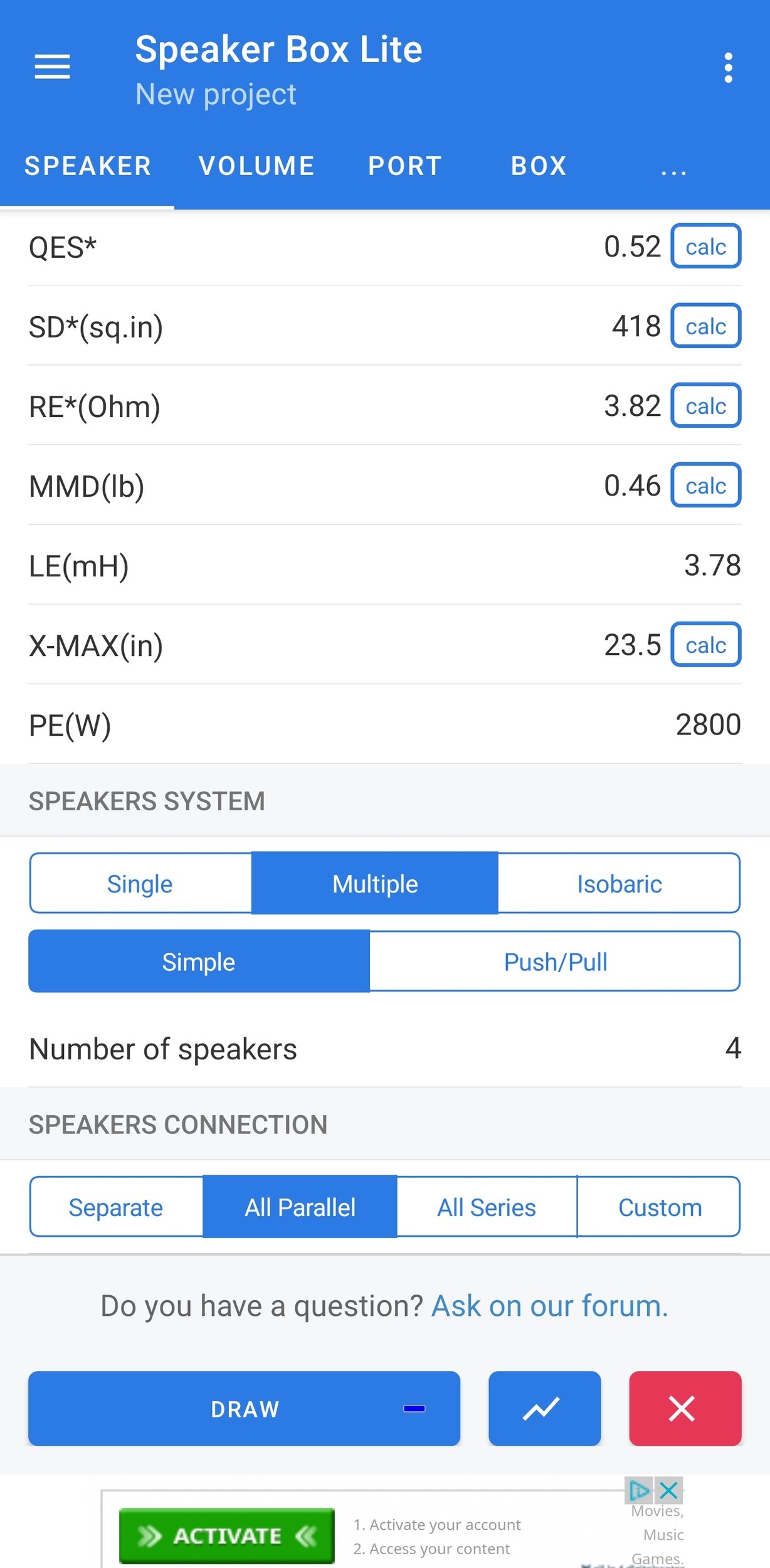

I have that box modeling software too. I have winisd. My results differ.
Screenshot_20220930-205956_Speaker Box Lite.jpgScreenshot_20220930-205950_Speaker Box Lite.jpgScreenshot_20220930-205925_Speaker Box Lite.jpgScreenshot_20220930-210212_Speaker Box Lite.jpgScreenshot_20220930-210158_Speaker Box Lite.jpg
But saying that it can't be done isn't true. Because you can. You modeled it.
Did I miss anything with my modeling?

I have that box modeling software too. I have winisd. That's pretty much the result that I got as well..
Just because you can doesn't mean you should. Pretty much not matter how I modeled those subs they modeled horribly. Pretty much one note wonders.
I personally wouldn't run those subs if those ts parameters are accurate.
I would at least run them through my modeling software on my laptop instead of my phone. And I would definitely have to heavily rely on cabin gain to flatten the frequency response

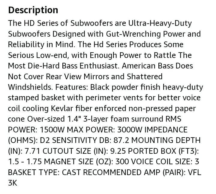

How do 4 of these 10's model in 5 cubes? American Bass HD10d2. 1,200 ounces of motor combined. 1,500 rms. each.
View attachment 43142View attachment 43143View attachment 43144View attachment 43145View attachment 43147

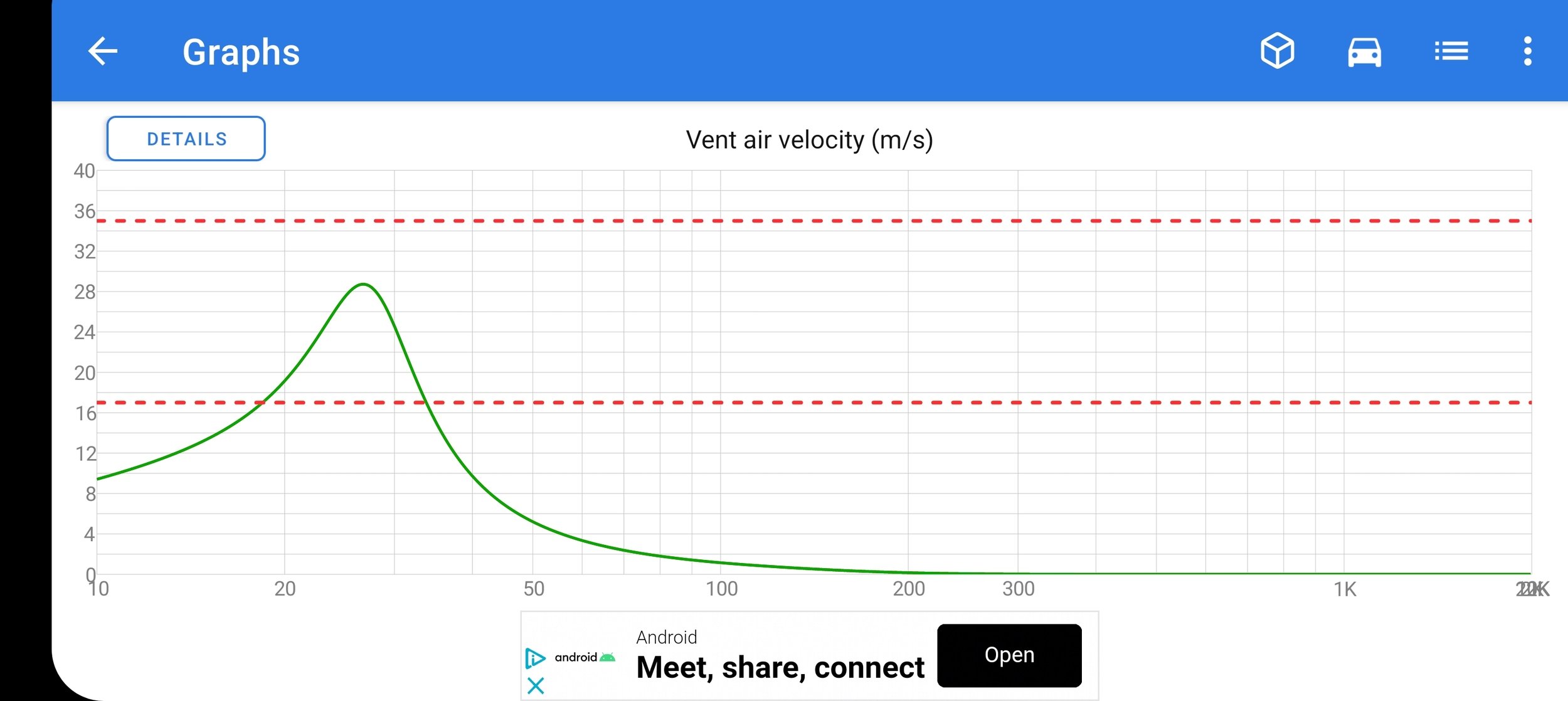

Btw you can't insert metric ts parameters into standard design calculators. You don't have 418sq inches for each 12. That why your results are different and the program by default inputs the max RMS number not the real RMS number. That has a drastic effect on vent air velocity. You really need to use the power level you intend to provide not the max number the manufacturer gives. 2800rms on a 3inch coil is gonna get stinky quick for daily.
Yeah I caught that it's actually 67.4.
