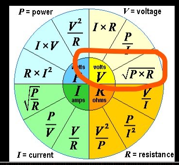

How do I know the value I should set my gain to, when using the volt meter.. theres a formula but I dont quite understand how to put the numbers in..
Most of the vids get like 22 or something..
How dk I calculate the right one for my bbx f1200
volts = square root of watts multiplied by impedance
so if the watts is 100 and the impedance is 4, volts = 20
this is what i meant, but probably said it wrong :)
19630
cant tell where do I get the right info on the RMS I should use for the gain formula, checked alpine sites and other places,
It says :
RMS Power Ratings
  • Per Channel into 4ohms (≤1%THD+N): 4 x 50W
  • Per Channel into 2ohms (≤1%THD+N): 4 x 70W
  • Bridged into 4ohms (≤1%THD+N): 2 x 130W
so its like 280 RMS? or what.. do I look at the 4x70 ?
Use the rms rating for the channel you are on. I take it that you have the subwoofer bridged on 2 channels and are running the component in stereo.
22.8 volts for the subwoofer channel. 14.14 volts for the speaker channels.
you use the speakers RMS, not the amps, or you could ruin the speakers. unless youre using a way too small amp
if youre using a small powered amp, you can only send the speakers what the amp can put out cleanly (without clipping the signal), or you can ruin the speakers
if your amps real big (500 watts), but your speakers can only handle 100 watts, youll ruin the speakers if you use the amps 500 watt RMS
id bridge your amp and send the speakers around 100 watts. if you dont bridge the amp, you can only send them 50 watts
bridged, that amp puts out 130 x 2
basically, you want to send the speakers what they can handle, without clipping your amp
so most people use amps that can send the speaker more power than they need = ensures a clean signal
