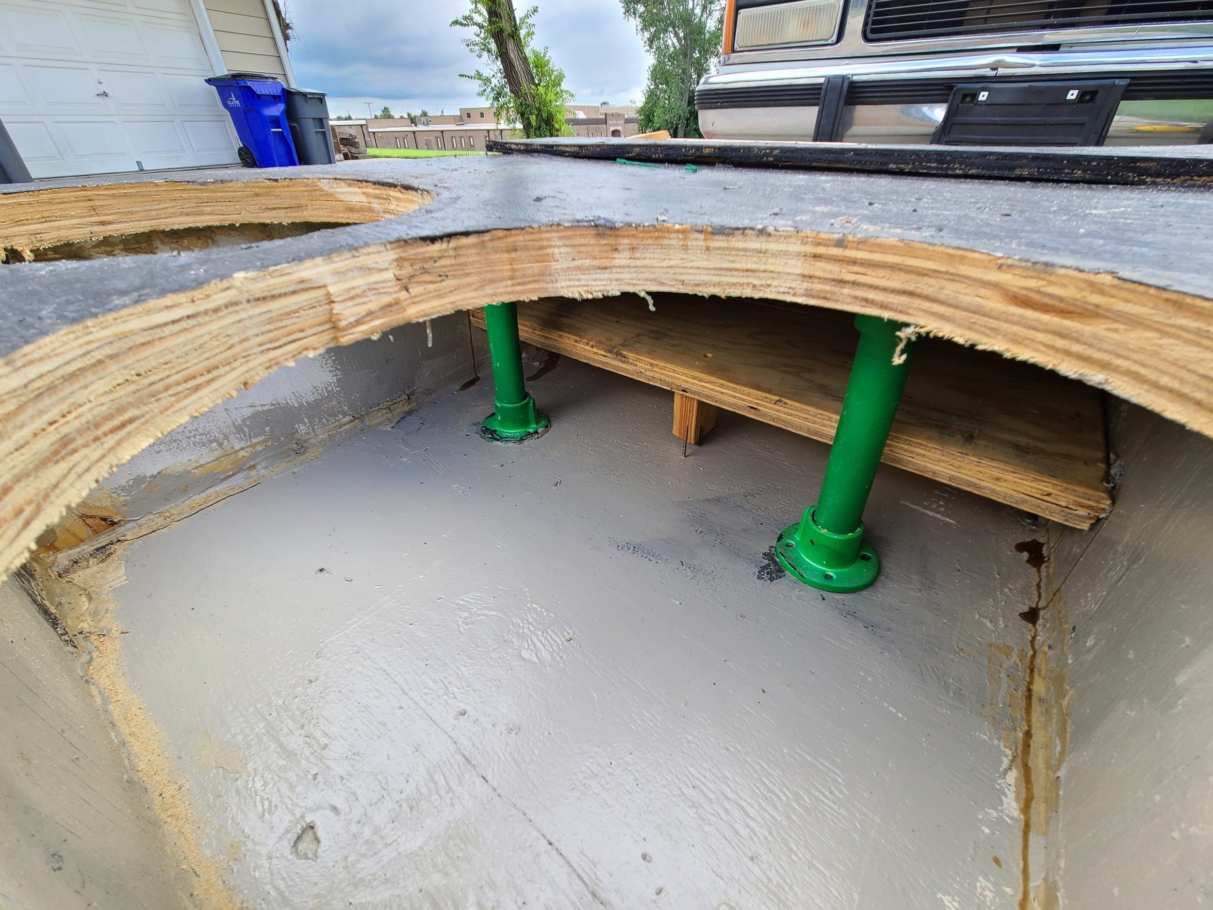

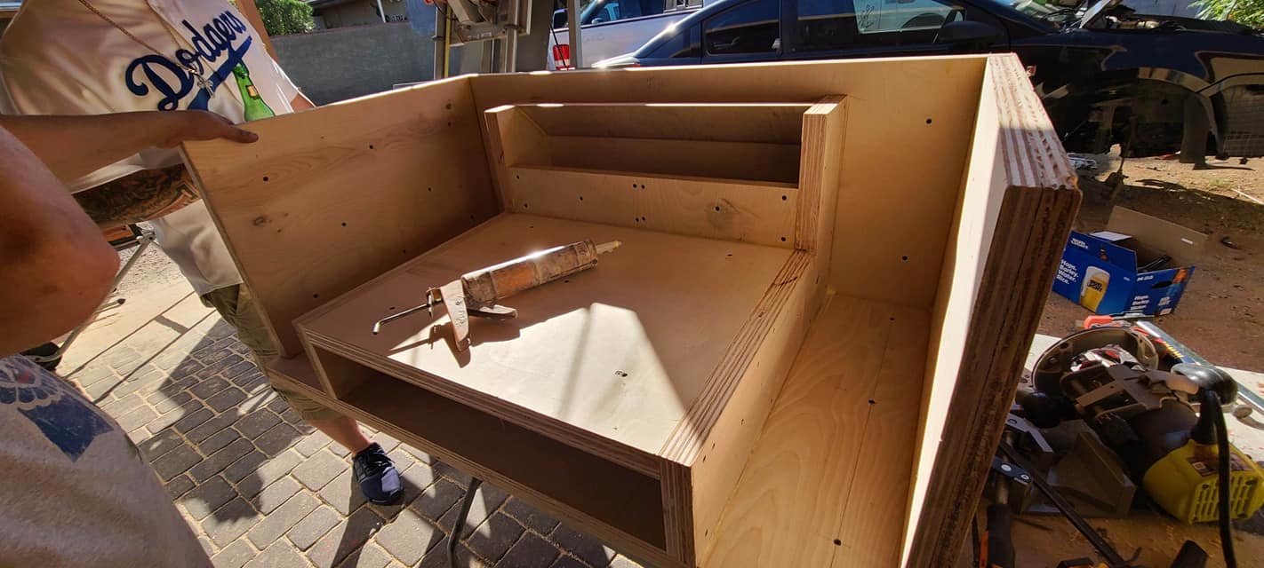

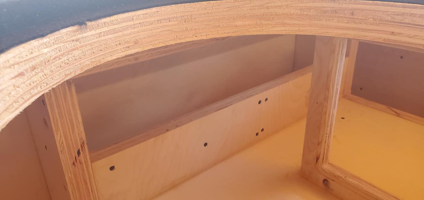

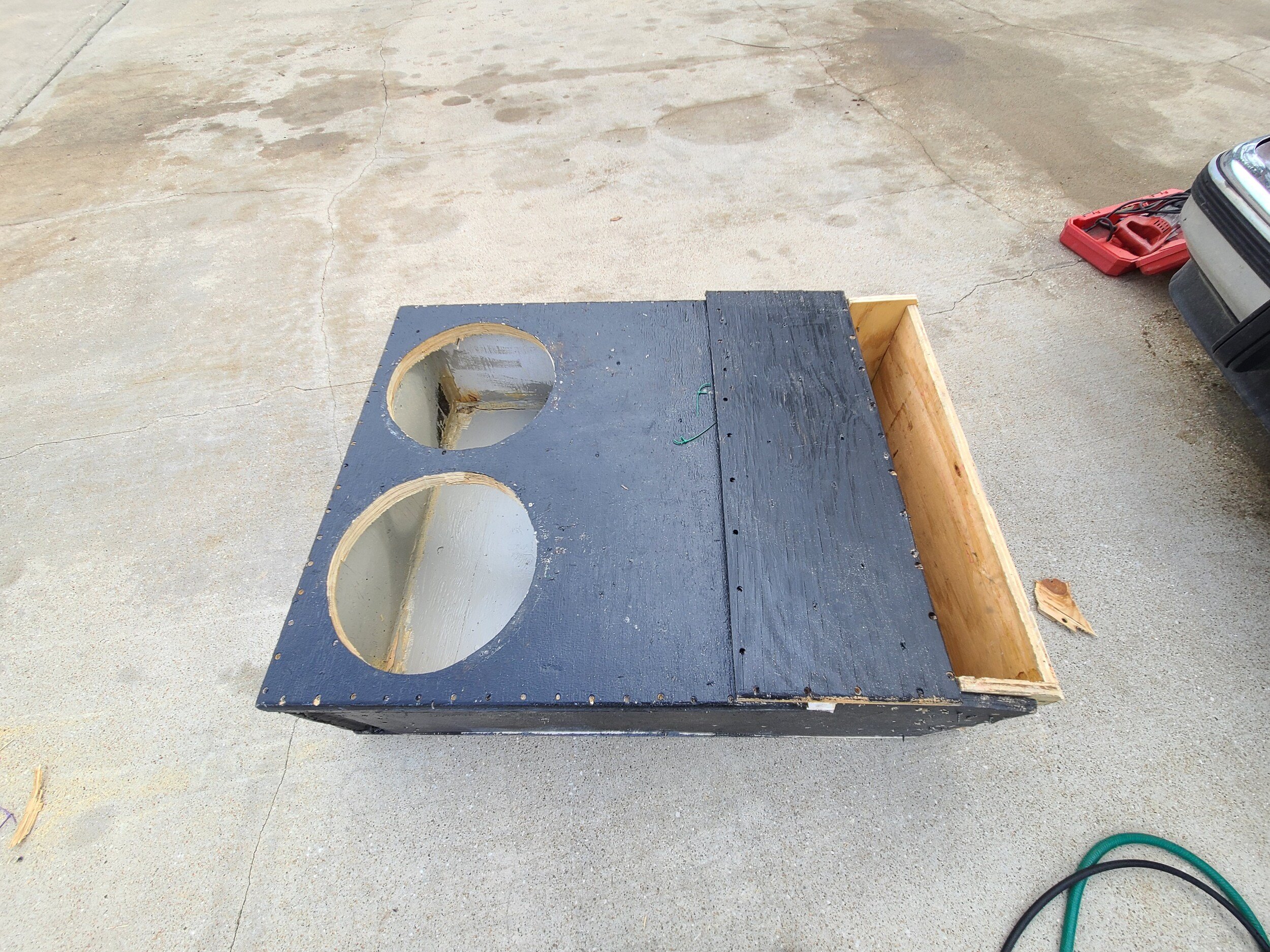

I just got the box out of my car finally so give me a few minutes and I'll post a picture
