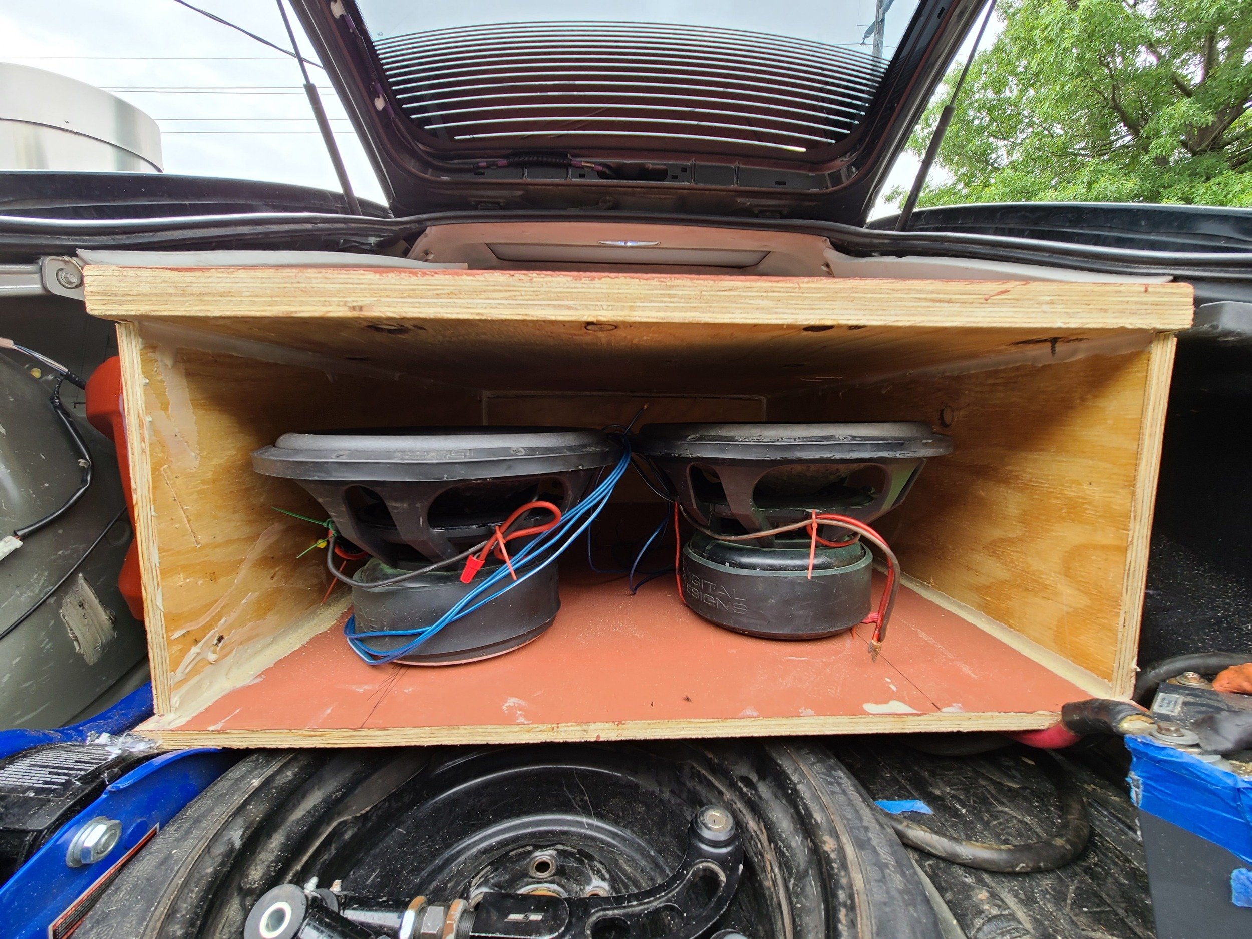

two dd 9500 15's or one dd redline 800 18"?
Hardly hitting
That port looks very long for "DD box" tuning, you should use a piece of 2x4 to brace between top and bottom at the narrow point between the subs. Are you certain there are no leaks? How close is that port opening to anything else in the car? Have you tested a wide range of tones to get an idea where this is actually tuning? I'm guessing you're tuned way too low.

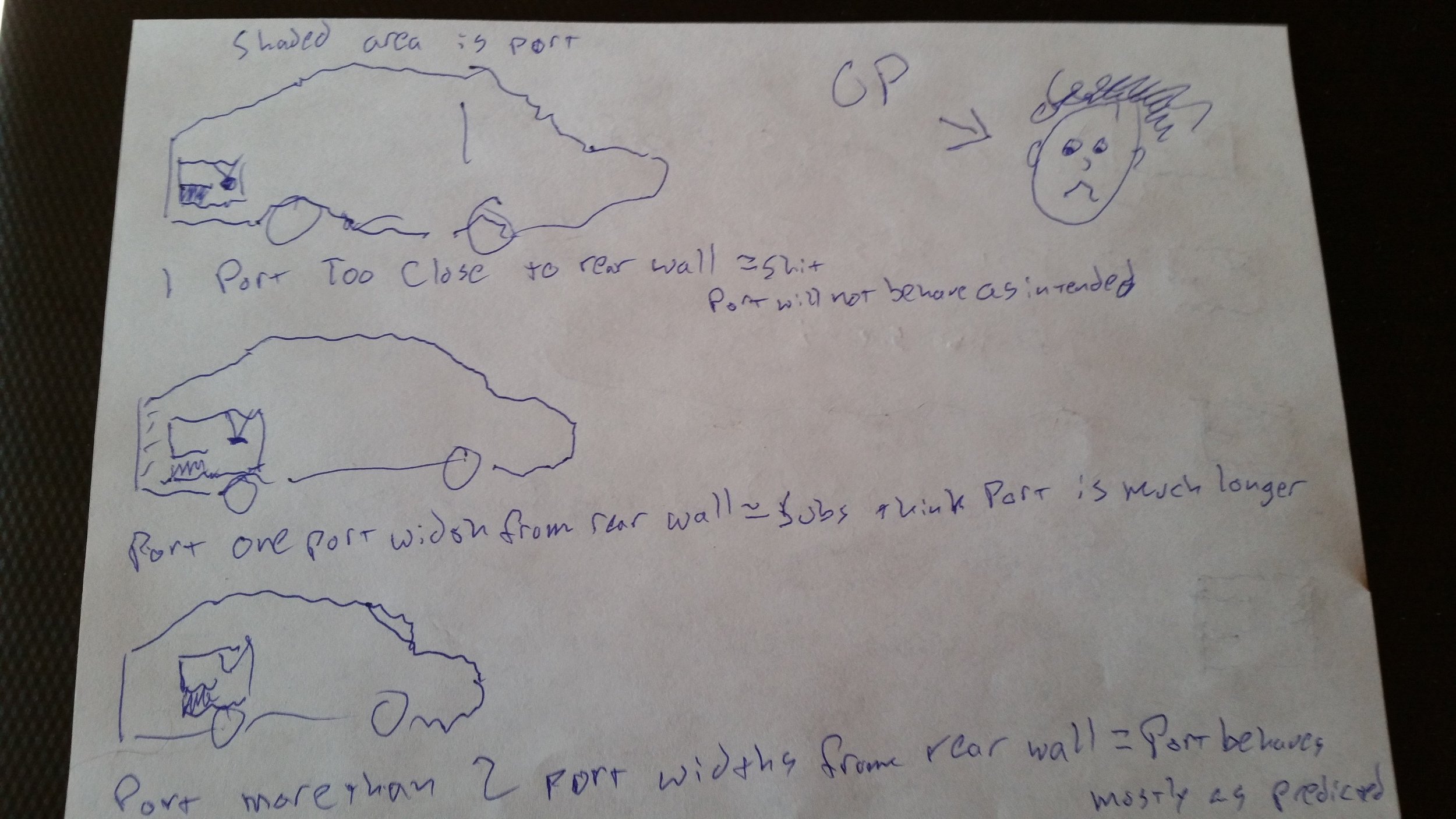

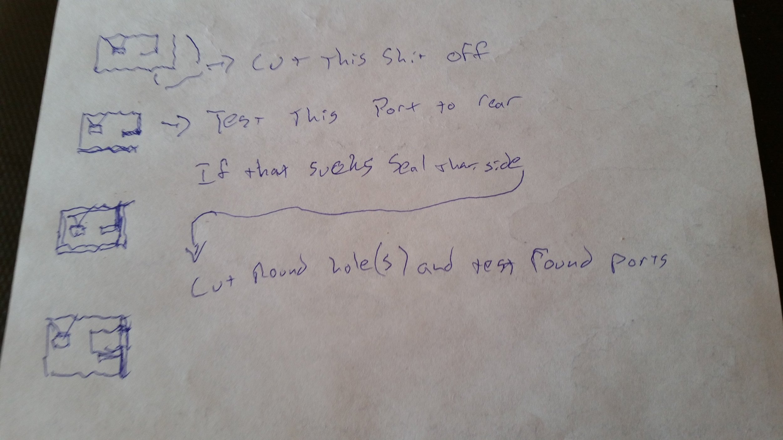

How close does the rear of that box set to the back of your car? Assuming that box is airtight on the seems and you get it braced there's no reason you can't so some more playing with that. Start by shortening the port (pics attached) and test it in a few places at different distances from the back wall, if that all ***** you can buy 12$ worth of sono tube and start testing round ports.
22667
For port testing after you cut off the bit pictured

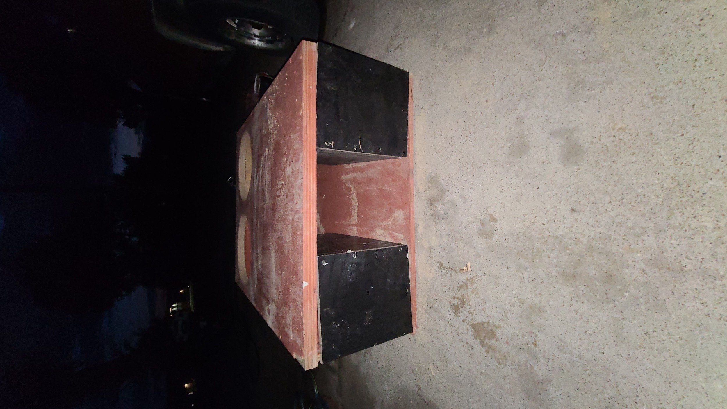

I completely agree with you guys....yeah that port is definitely to long. and i would love to build it properly but I just moved and my table saw and all of my wood working tools are packed away in the back of my unit so all I have on hand at the moment is a damn circular saw, a straight edge, and a plunge router, so im trying to get by with with what I have at the moment....and remember I changed the port so yeah its going to look like **** lol....I'll upload a picture of the one I'm building now....
I was trying to reach out but I didn't want to annoy anyone with all of my questions, im a visual person, if you put something 8n front of me I can usually reproduce it, like the two pictures you provided shredder
Do you see why I was so pissed after paying for that design? Its like he didn't give a fucck about it.....especially because he literally waited till the deadline which was 10 days, and finally sent it to me around midnight. Hes a real fuccking douche to say the least. You'd think he'd want people to come back. If he's that good then he'd know the design he came up with was worthless. I mean fuckk the box I threw together originally just to hear them was substantially louder. And im surprised it stayed together lmao.
And thank you hispls for the examples.....the box sits about 10 inches from the hatch. The new port i came up with is 20 inches wide, 7 inches tall, and 20 inches deep for a tuning of 40hz
And the second box that you guys like so much (joking) is exactly what was in the design i payed for except I added the galvanized pipe and made the port 5 inches instead of 3.....i had it at 3 inches at first though so it didn't look like that a couple days ago.

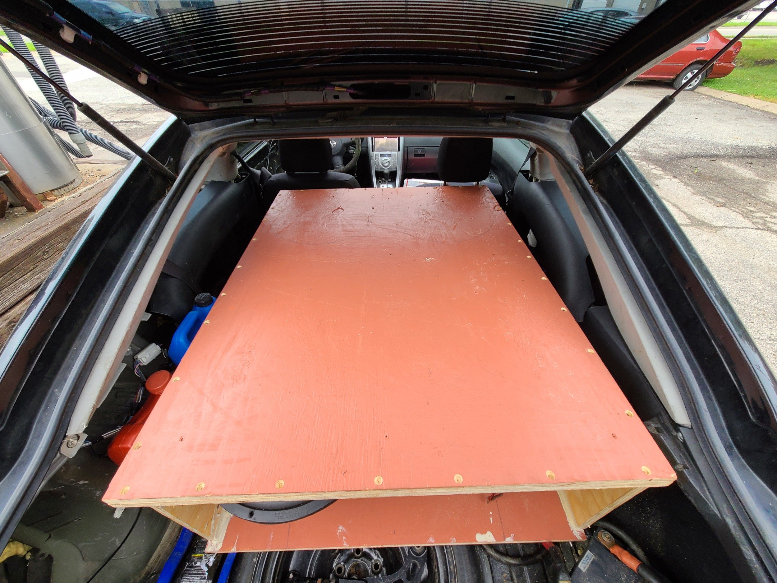

So since ive only got the sides, back, and top and bottom....how should I design the port? The dimensions are 45x35x15

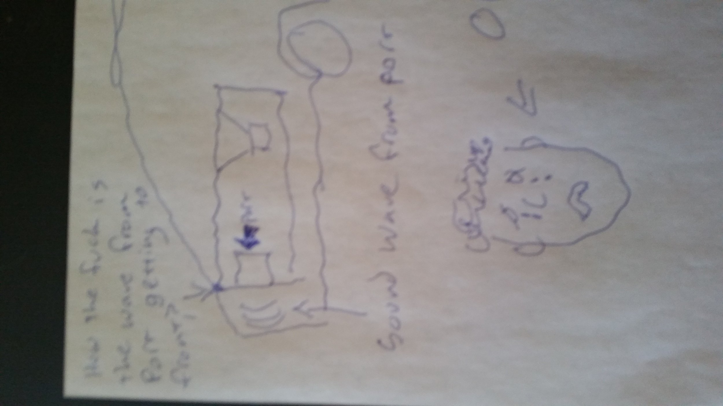

But it's really crowded into the rear so there's no room for the sound wave to get up to the front. Can you try to cut down the last box so that you have only that horizontal section of port like my last picture and test this from a few positions in your trunk? This should cost you NOTHING to snip off that extra wood and test some. Cut that last box down and test it all the way shoved back, all the way shoved forward, and one or two spots in between and see how the frequency response and overall output changes, this should give you some ideas on what works and what doesn't in your vehicle.
IF your only option is crowding the port like that you would probably do better to skimp on box volume some (8 cubes should do OK on 8K) and have better port position than trying for more volume and crowding things.
Also subs forward port back may work for you as well. A friend of mine does that in most of his builds in hatchback type vehicles with good results.

See i was also wondering about that......firing the subs forward and port back, but the subs are supposed to be as far away from the port as possible, so i assumed that it wouldn't work out as well because the subs would be parallel with the port.
I do have 8" dia pvc pipe to use also. So thats an option as well
Ok so I'll drop the second box down to 35x35x15 with two 8" ports at 18 inches makes it 6.8 cu ft net @ 40hz with 100 sq inches of port.
