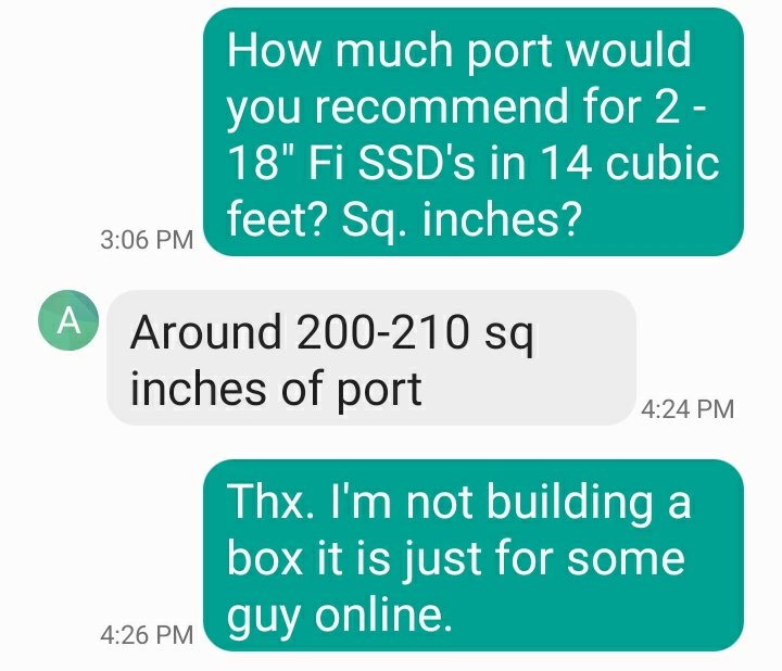

Designing a box for 2x Fi SSD 18s and am not sure what volume/port area to use. Tuning to about 38hz and plan on ~14ft3 net.
Fi recommends 100in2 for both but that seems low to me. WinISD and speakerboxlite are giving me completely different port velocity numbers so that isn't helping. My gut says two 8" aeroports would be good.

It sounds like you need about 200 sq. inches. Maybe they meant 100 sq. inches each and not total?

7.1 sq. inches per cube seems awfully small. I would guess 170 sq. Inches at a minimum.
That makes sense to me, especially when looking at WinISD. But also people run a single 8" port on (2) 12s all the time and and I imagine one of these 18s is somewhat comparable to (2) 12s. Also aeroports can be a bit undersized, maybe 100in2 of aero would perform like 150in2 slot? I'm totally lost on this one lol. I am very interested what your box builder friend says.

Did you tell Fi how big your box is? A 2 - 12's box equals around a 1 - 15 box to me. A 2 - 15's box is pretty close to a single 18, give or take and obviously sub dependent. One 12" aeroport might work (113 sq. inches).
