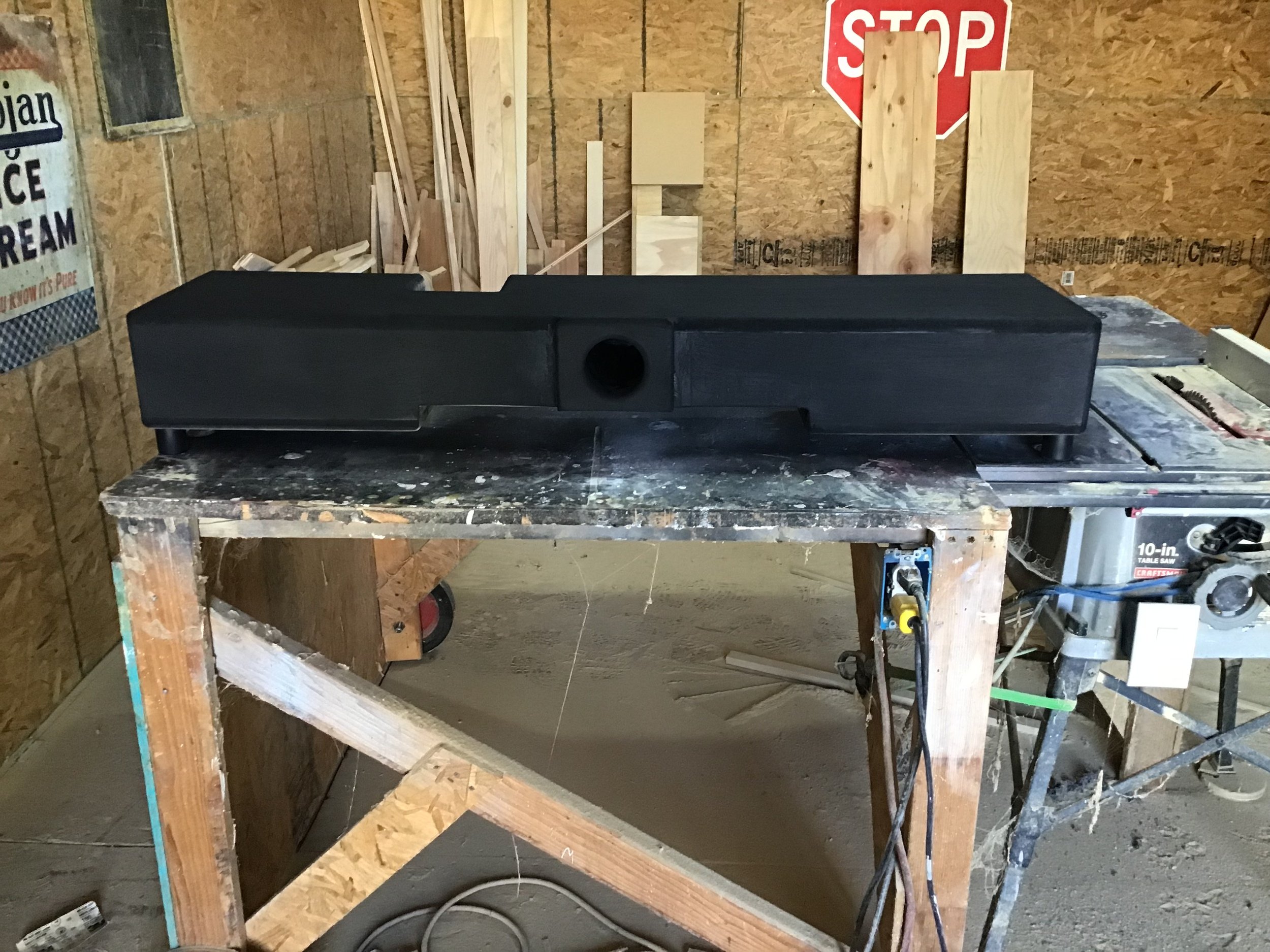

I did a downfire box recently for a 2004 f150. super small area under the rear seat. Was able to squeeze almost 1 cube in going all the way across. He used horrible 10 inch Rockville shallow mount subs though unfortunately. Really small space under those rear seats. I tried everything I could to talk him into going sealed, but he insisted on ported, even though there isn’t enough room to effectively port a 10 inch sub under there. Ended up with .9 cubes tuned to 38 HZ. I recommended plugging the port at some point and trying the JL shallow mounts sealed. I think he’d get a much better sound. It’s very difficult to convince 17 year old kids that Facebook doesn’t give the best advice.

That is a nice box!
He could opt for an 8" for that, or glass it to get the extra acreage. Either way, you will never defeat FB. At the end, however, as long as he's happy with it, let him run with it.

Lol. He’s not happy with it. I just argued with him that adapting 12s into the box won’t be any better. When I first agreed to build it, I suggested 2 6.5 inch RDS Audio subs, which the box is perfect for. They would’ve sounded very nice and gotten decently loud. He’s the kind of guy who cuts a hole in a sealed box because it’s “louder”.
